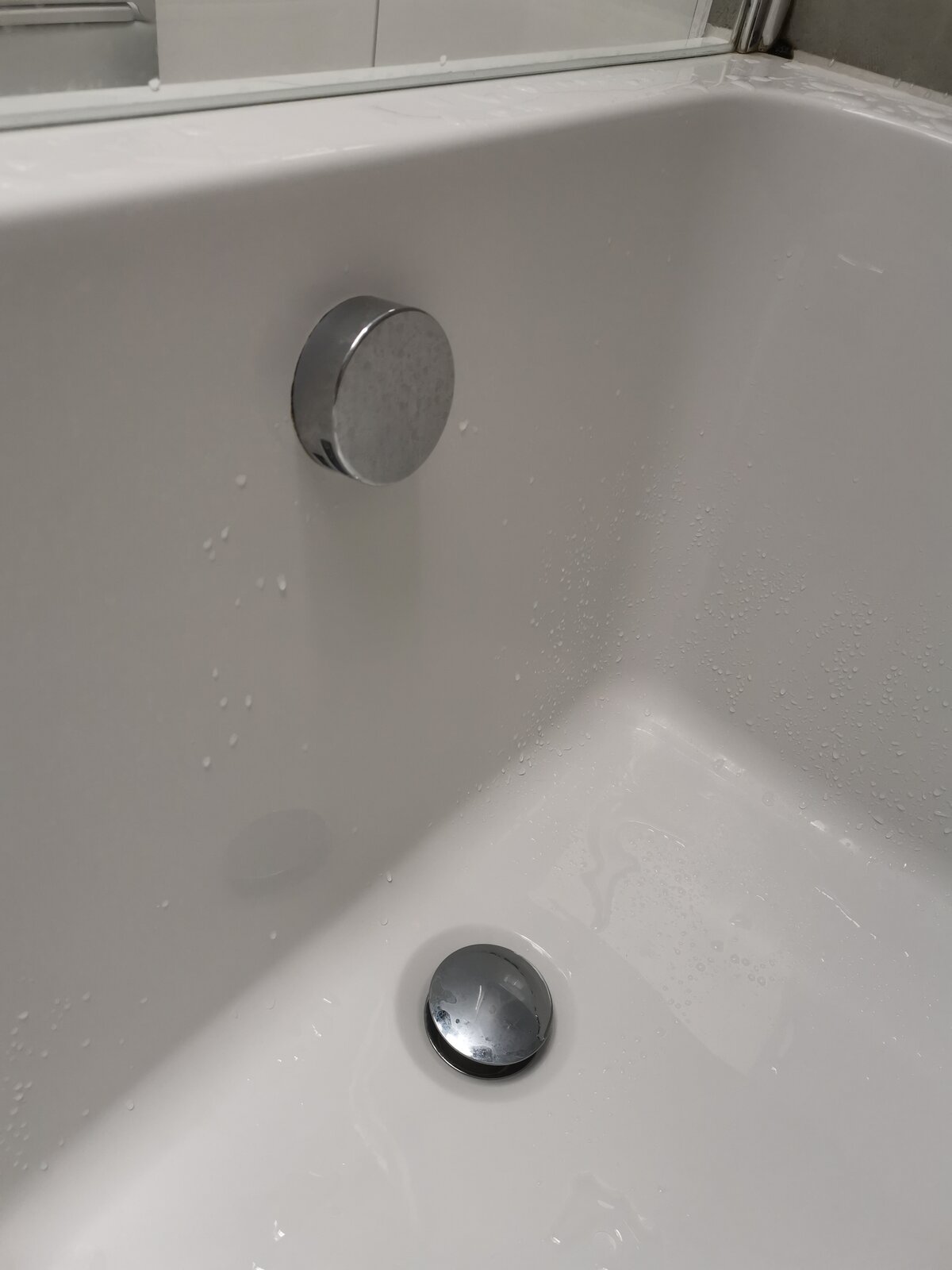

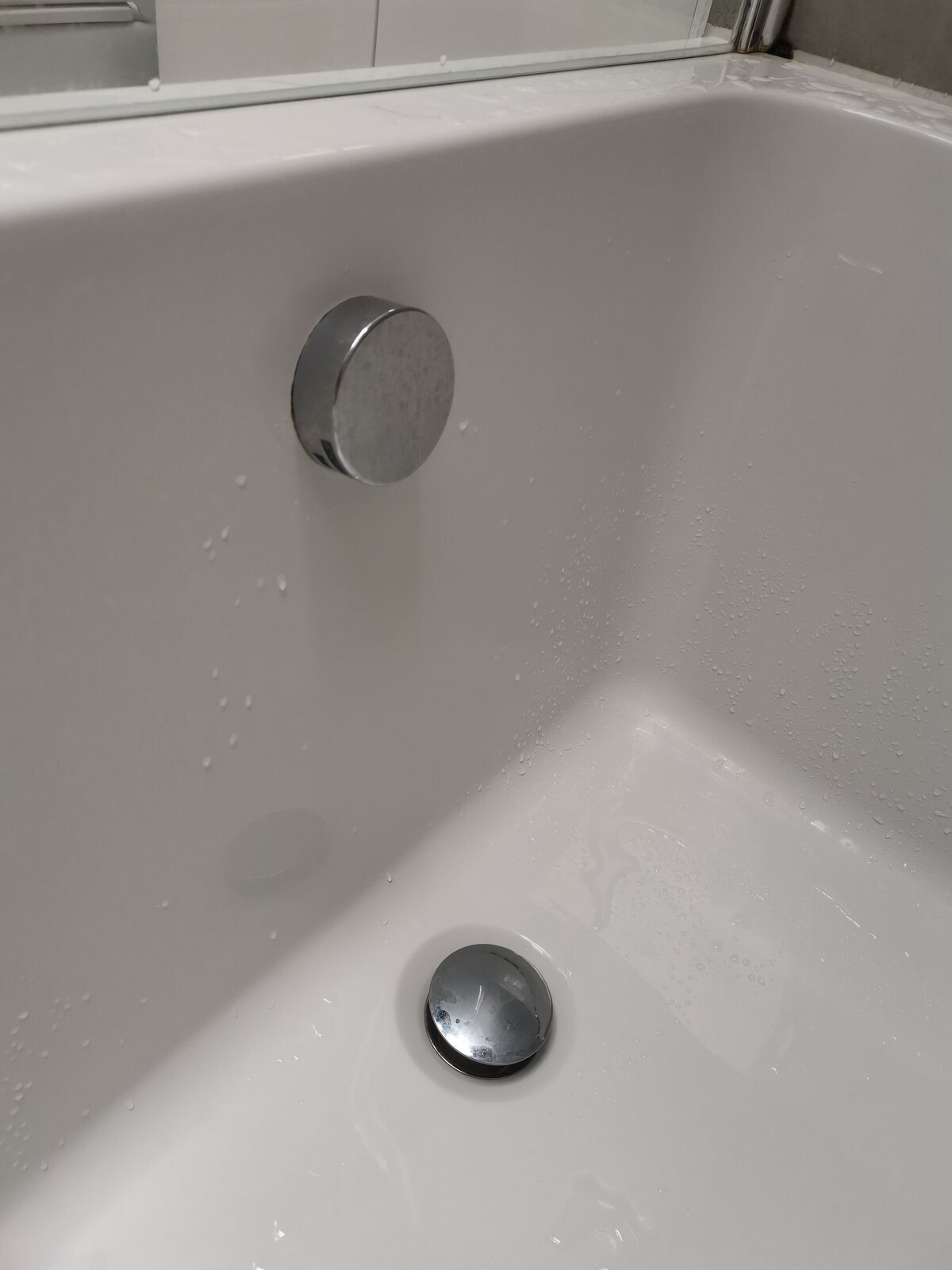

Sounds like an issue with the bath mixer valve. If you turn the handle on it to hot only ,no cold mixing, what's the result ?
There must be another PRV set to 1bar at the boiler then except you are looking at the system pressure which would be quite normal at 1.0 to 1.5bar with a fully hot CH system. If it is mains reduced 1bar then there is really no advantage in this as any mixing will still take place at 1bar but ideally both pressures should be equal to help prevent the sort of problems you have, it would be more normal IMO to have one PRV set to 3bar supplying all the water needs.The concealed mixer does the bath only, there is a separate thermostatic mixer at the other end of the bath for the shower. We do have high mains pressure (nearly 8 bar if I recall) but we had a PRV fitted which is set to 3 bar which I believe is normal? This is higher than the 1bar on the boiler but it was working fine in the past.
I just did a test and with both basin hot and mixer at the same time and got the same issue, the water went cold on both after a min or so and the boiler behaves as it does when only the bath mixer is on i.e. gets to 88° and then starts cycling on and off and then temp drops to 56°.

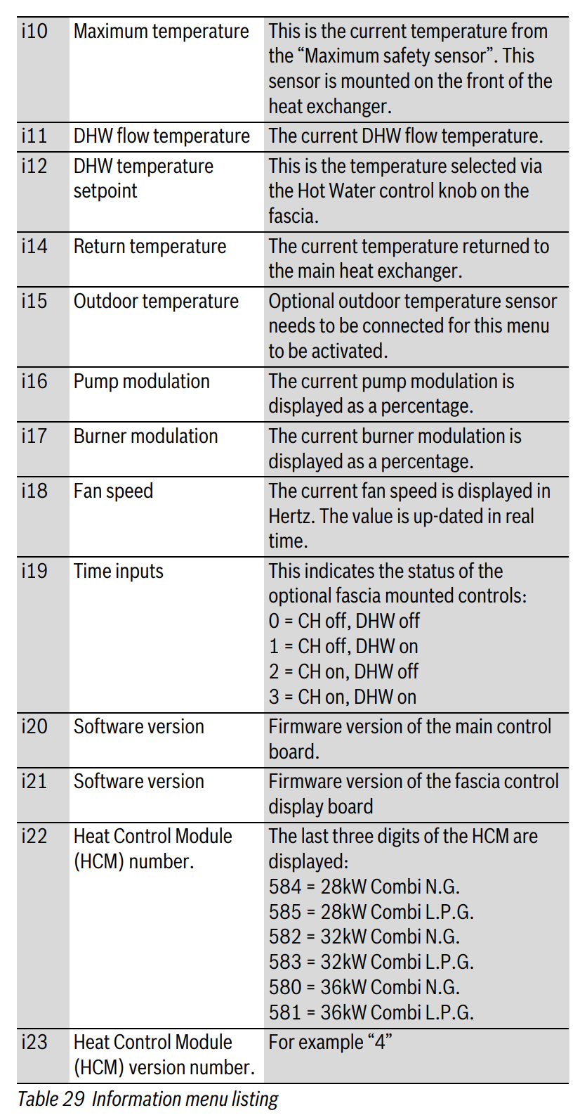

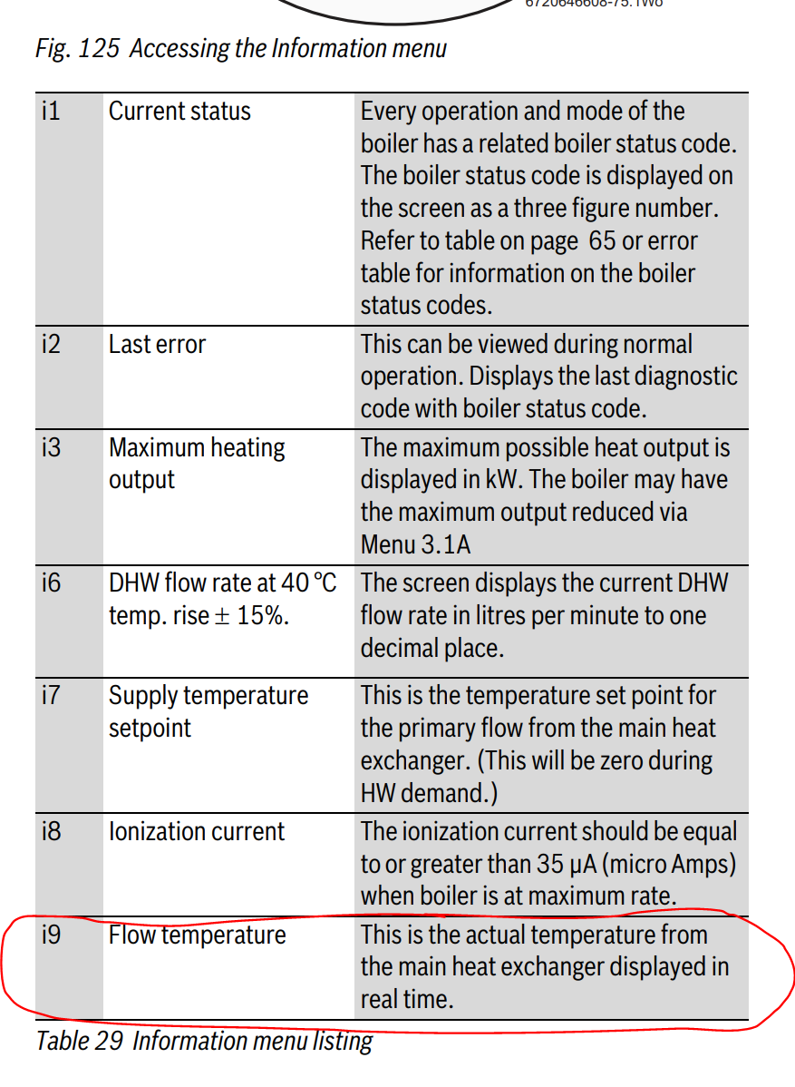

Sorry I am struggling to understand how the HW flow can be restricted if there is 9.6LPM from the bath, wouldn't this be a lot lower if it was being restricted? I was thinking the opposite, that the bath has the highest flow rate in the house and the boiler isn't able to heat that demand quick enough for some reason? That's why I was suspecting something wrong with the boiler?

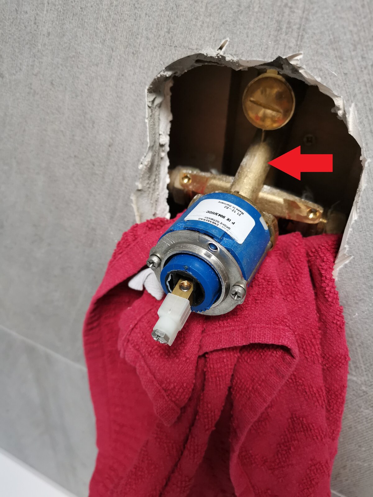

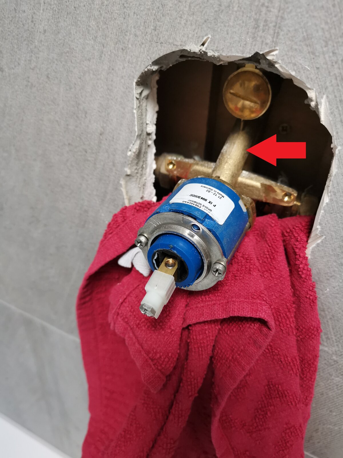

When you say feel the outlet from this mixer do u mean on the body of the mixer where I have put a red arrow below or at the filler on the bath where the water is coming out?
