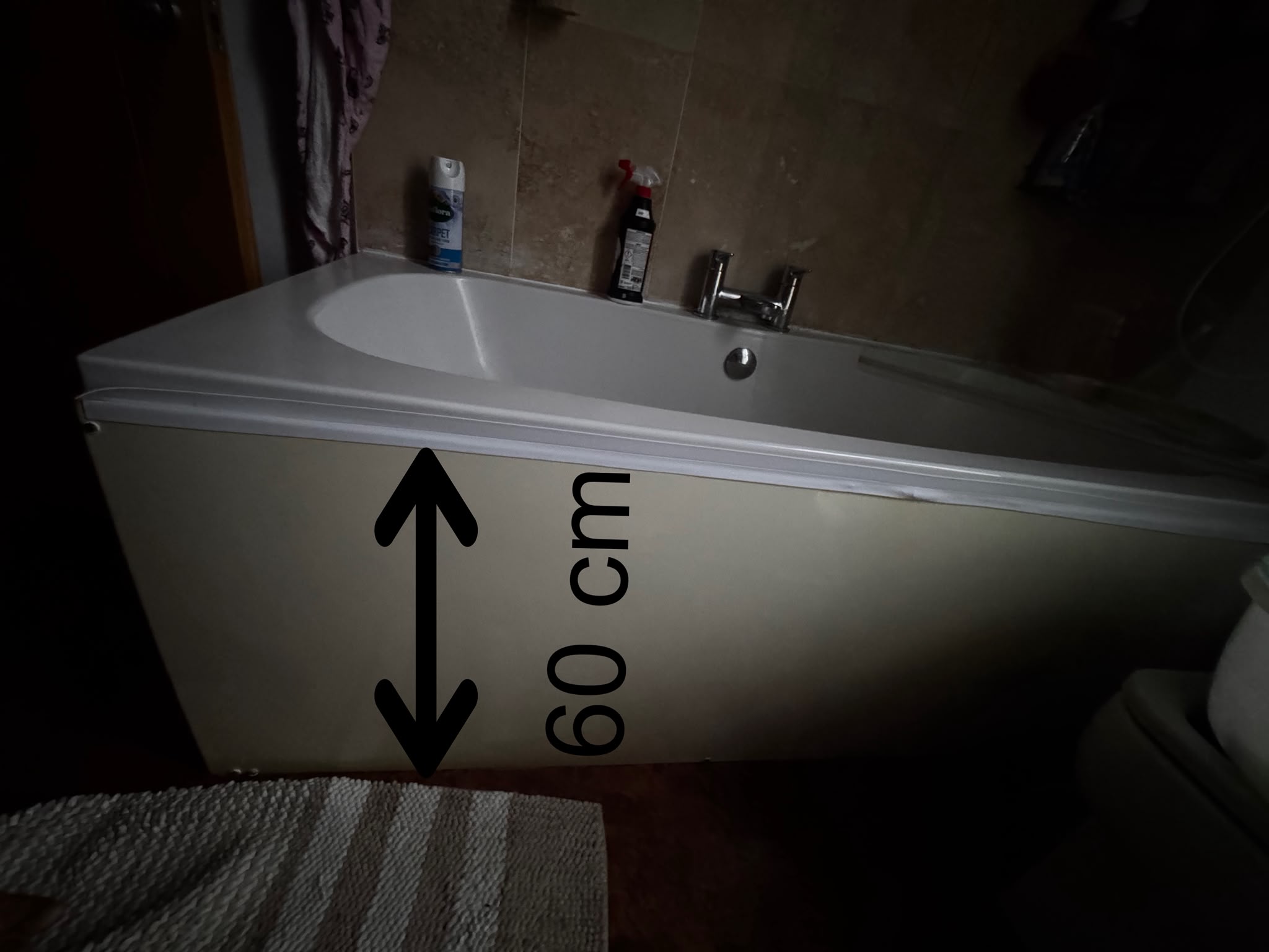

Hi there
Does anybody have experience of supporting a bath but without using a wooden frame? Any recommendations? My tenants' bath has a wood frame and it seems to have got mouldy and unstable [see messages below], so I wondered if there is something better than replacing with new wooden battens which will just get mouldy again

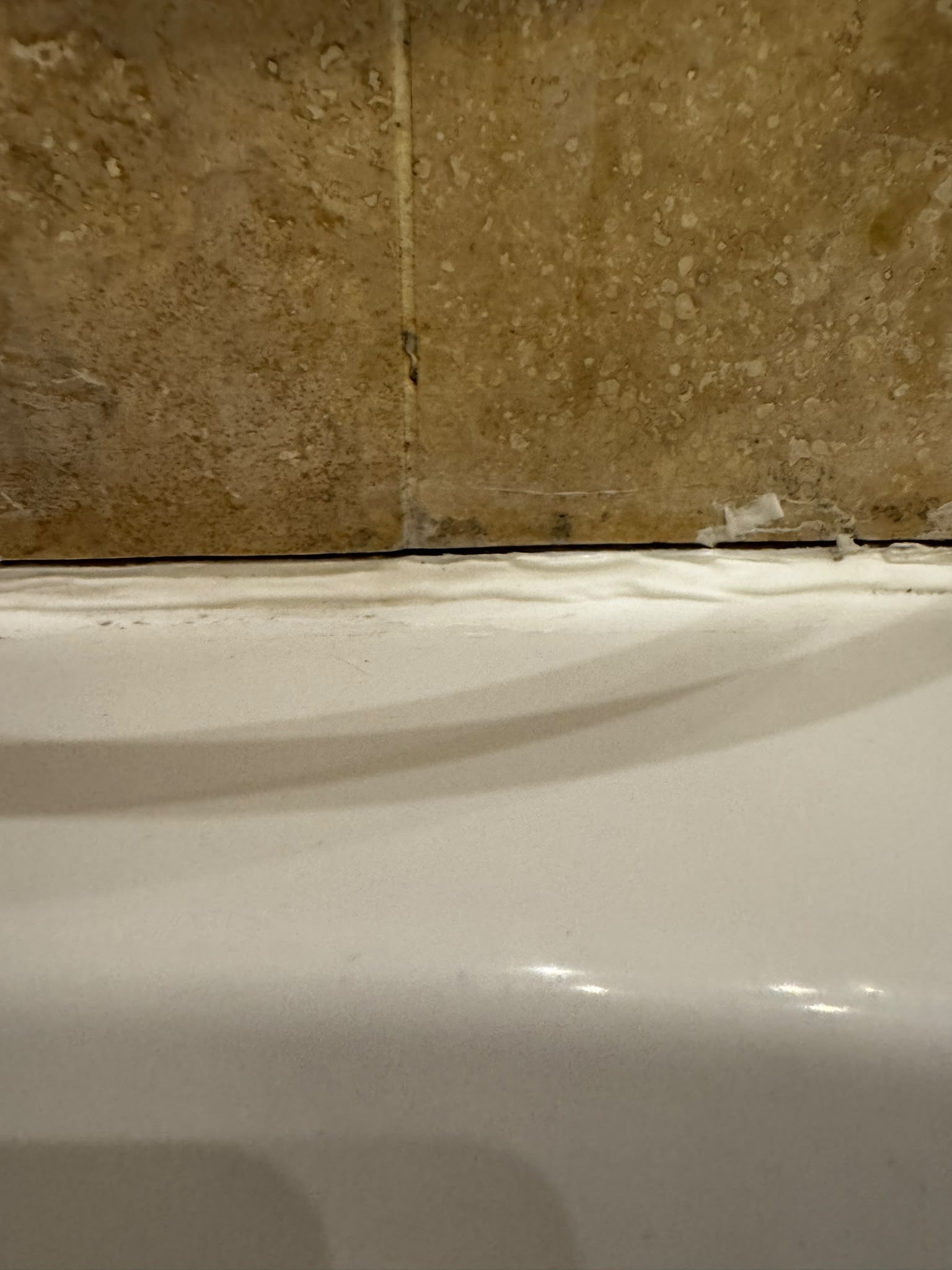

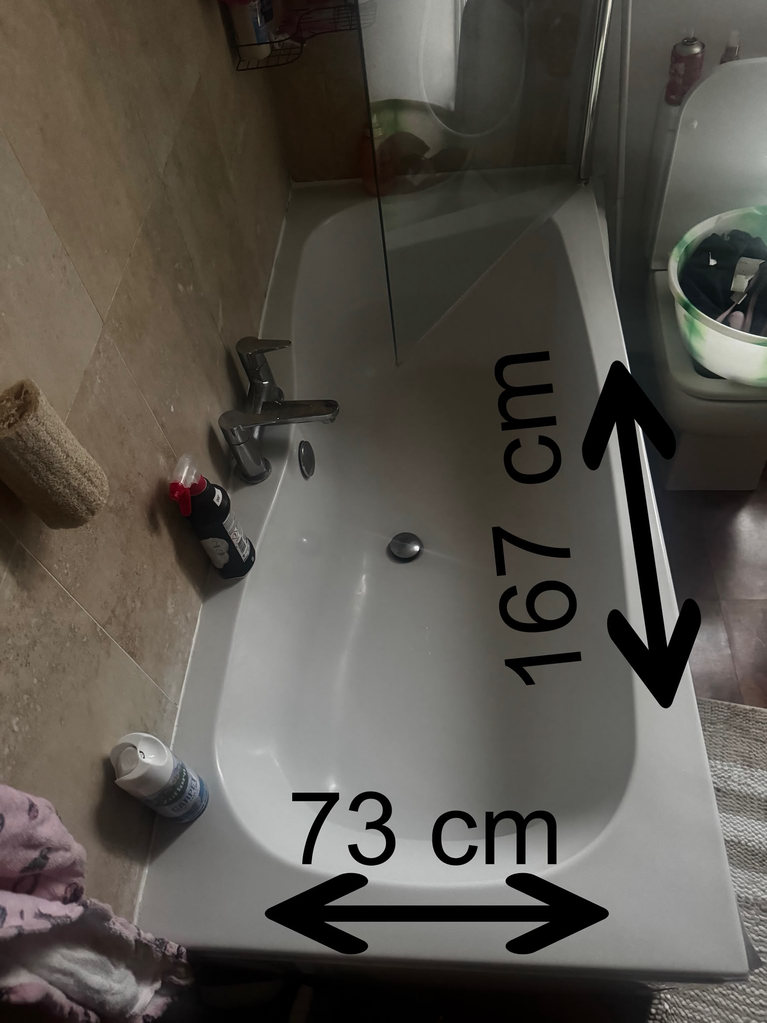

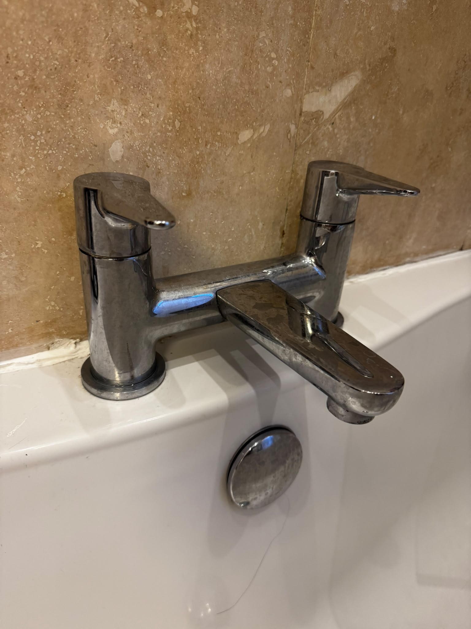

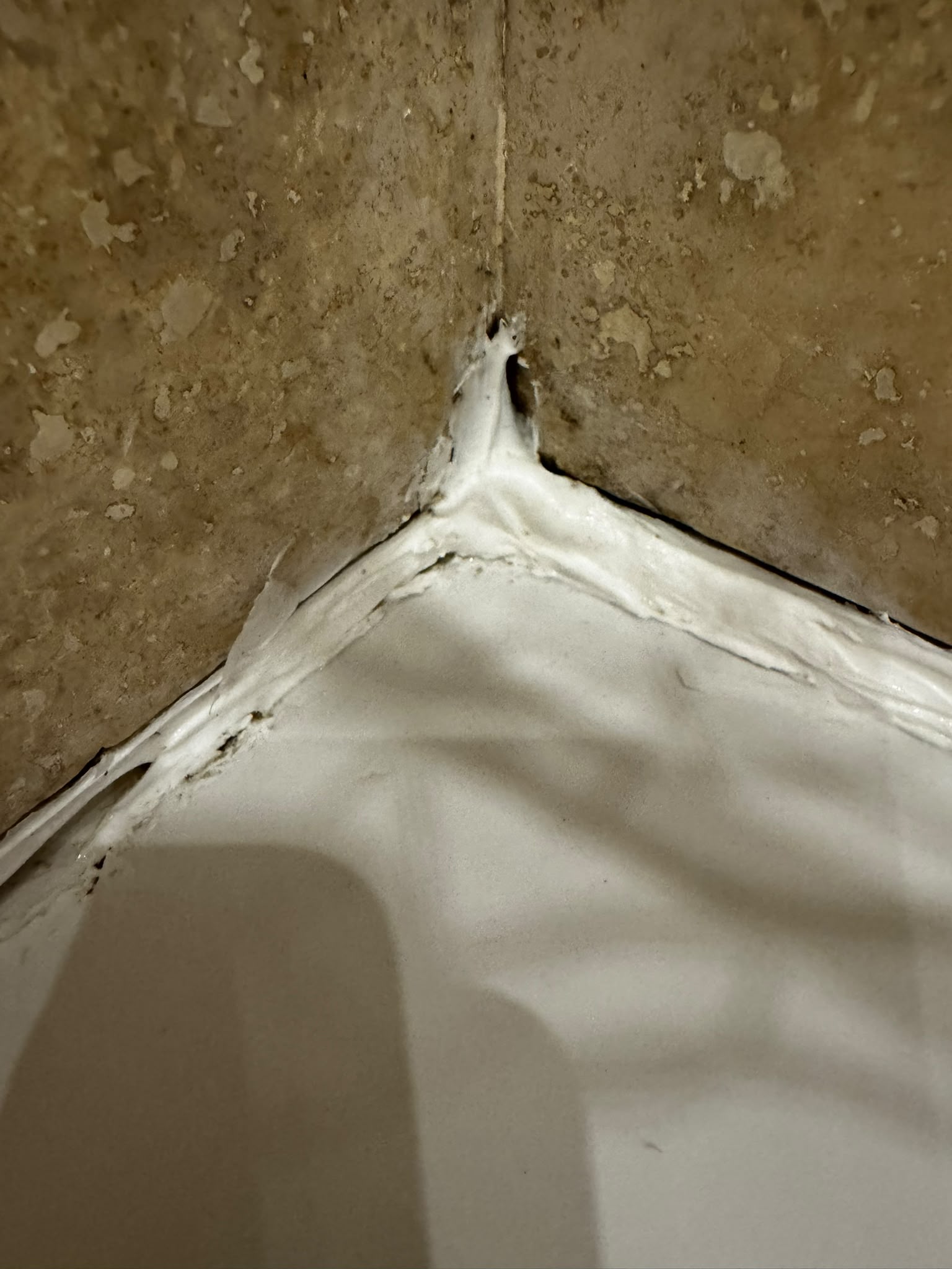

Hi, just wanted to follow up about the mould underneath the bath that we mentioned before. It’s not urgent, but I think it does need to be sorted fairly soon. Since the weather has been warmer, the mould/damp smell coming from underneath the bath has become really strong, and we’re a bit concerned that it’s not healthy to be breathing in.
As we mentioned before, the old wooden parts underneath are covered in mould, and the bath also seems to sink/move slightly when we get in. This pulls on the sealant and allows water to get behind it, so the mould keeps coming back and spreading in areas we can’t reach to clean.

Was the bath fitted after the tiles? That's quite a big silicone gap. Maybe the bath has dropped? Get some timber battens under the bath feet if possible. The mould is likley from leakage from that poor silicone seal job.
Well the tenants are reporting the bath moving a bit and having to re-seal so yes they seem to think the silicone seal is an issue
Timber is fine to be honest, there shouldn't be any moisture at all behind the panel.
Then the frame/batons haven't been installed properly. The whole point of batons along the wall edges and a frame/support at the open ends is to minimise the movement in the bath. If it is moving to the point that the seal is going then the woodwork isn't doing its job properly. If the batons/framing had been installed properly then the bath won't move significantly, therefore the the seal wouldn't be compromised, water won't get behind and down and that wouldn't be the cause of any damp.
Especially with an acrylic bath there will usually be a little 'flexing' when the bath is used, hence the reason for filling the bath as it gets sealed so any flex is already built into the seal.

It seems that the bath edges where the gaps are appearing at the wall boards, simply aren't supported properly, that's where it needs to be corrected. Unfortunately, only proper way to do that TBH is to take the bath out and refit the batons/supports properly
