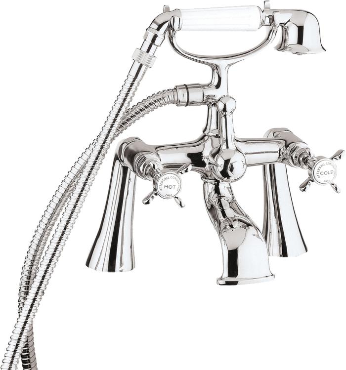

Bath / Shower mixer strip down
Im not a plumber but once pointed in the right direction i can continue.
No way of knowing the manufaturer.
Even if im in front of it i cant see which it is.
I suppose the only this is to try and undo the cradle and see
I very much doubt that the spout can be removed from the tap body. Can you see any evidence ,like a split line ,of a join between the two ?
I would expect that access to the diverter inner parts would be from the top ( cradle ) and the lever at the front.
And I suspect ,but am not certain, that the cradle can be removed with the tap " in situ" ,by unscrewing the collar where the stem of the cradle meets the body.
Spout and cradle must be separate as i can see a split with bot and see a black rubber seal etc
Well... What does the full writing say on the middle of the tap heads? Google doesn't throw anything up searching for that?
The cradle can rotate ,till it touches the wall , can't it ?
If you do that ,and the collar doesn't move ,then the collar is effectively threaded and is retaining the cradle ,like a nut ,but round and smooth. Put a cloth around it to protect the finish ,and a large pair of grips ,and try to unscrew it anti clockwise.
Bit of effort and... Voila...
https://www.deva-uk.com/products/coronation-bath-shower-mixer-cr23
Suggest you give them a call and ask for a service manual/drawing.
I did look before i started here but knowing what to type helps to start with.
Many thanks for your help and this will wait until i call them tomorrow.
Thank you
