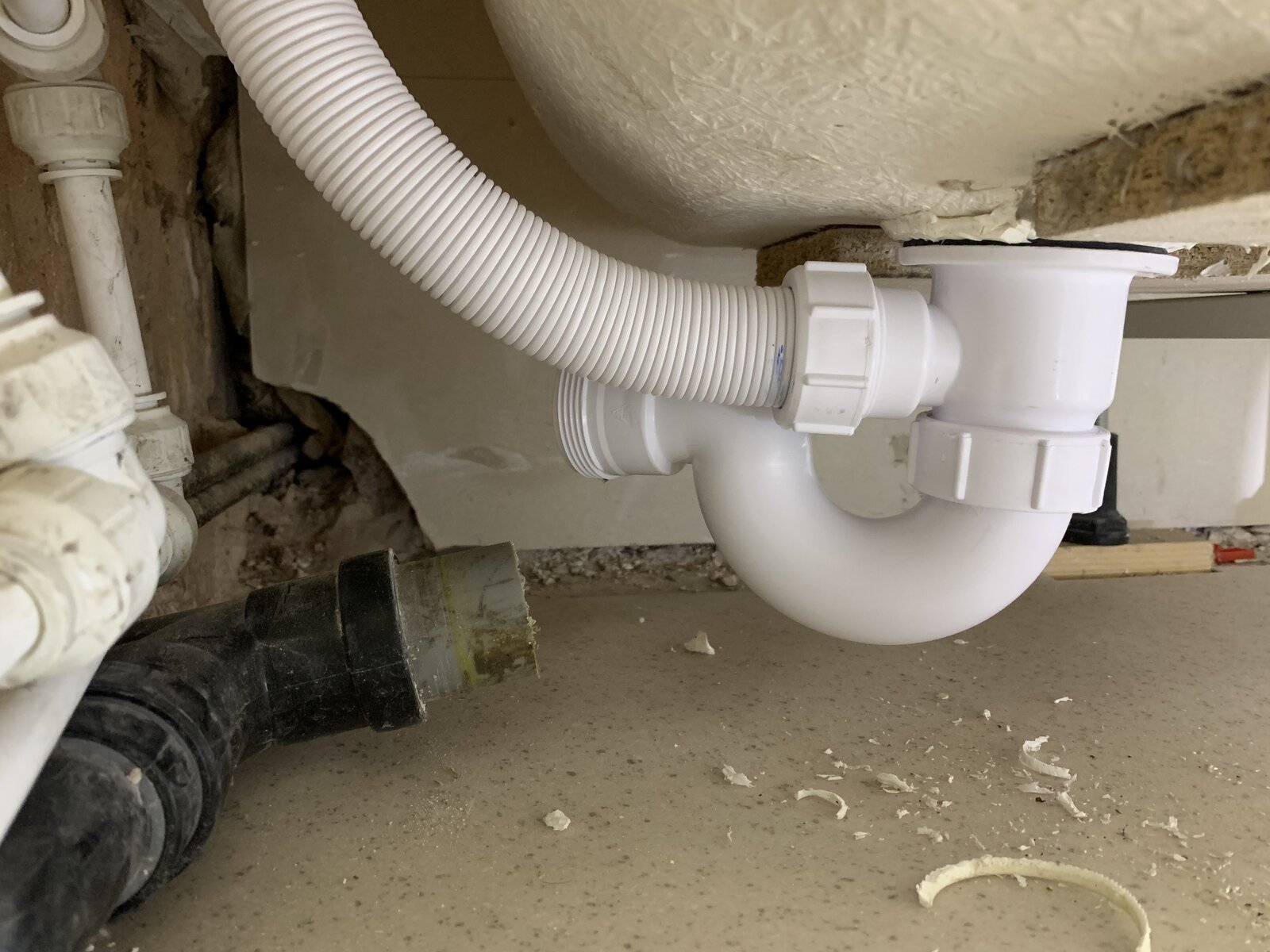

My bath trap is too high in relation to where it needs to be connected, I’m stuck!
Is there anything I can do other than going round the back and then forward with L-connectors ?
Use a flexible waste pipe ,and alter the position of the trap to suit.
I don’t like the ridges on the flexible connectors as they accumulate dirt.
I think of using a bent like in the photo, shall I go for a wide bent or a normal one as it is underneath the bath and don’t want to open it for cleaning.
Please ... Please .... Please .... don't use push fit, if you can't use solvent weld then worst case use McAlpine compression fittings.
Push fit is not good a good system long term, the seals harden and flatten over time (hot/cold/hot) and if they are then disturbed they will leak, 99% guaranteed.
