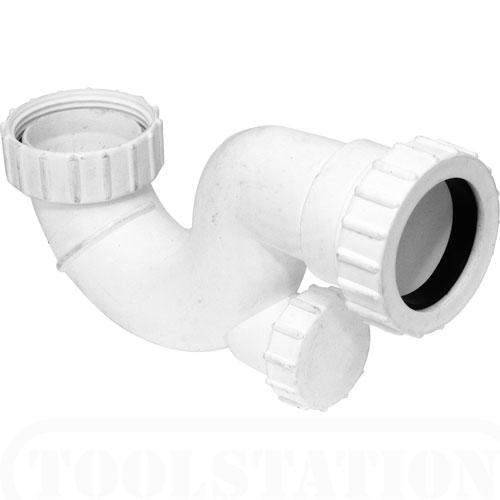

hi all,
fitting bath and the plughole doesnt line up with the old bath trap and waste, so I bought one of these from wickes:
http://www.wickes.co.uk/Flexible-Connector/invt/431945
however, as you can see there are no threaded connectors at either end, so I'm guessing I need to buy some sort of pushfit device? could anyone tell me what kind of thing i need and where i should be connecting it to?
Also do I put the flexible connector between the bath and the trap or between the trap and the waste pipe? Both the bath wate and the trap are 1.5 inch fittings.
Hi there,
THink they are designed to go into compression fittings.
It goes between the trap and the waste.
The trap should have a compression fitting on it already and then just get yourself a compression straight connector.
Like these
