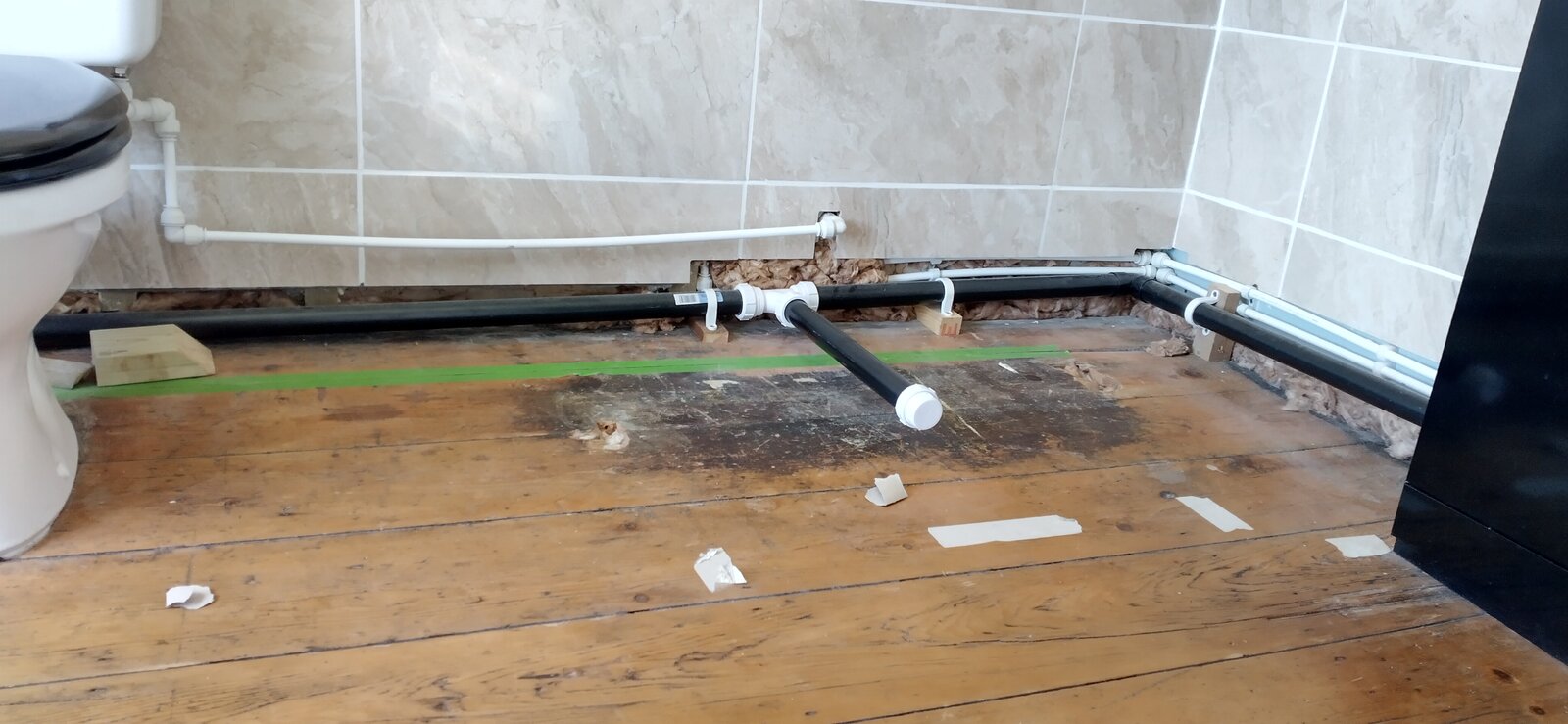

Unfortunately I can't get a waste pipe run to the soil pipe under the floor without going through a number of floor joists, and it's also too tight in the corner of the room to get a new boss into it.
(The soil pipe is boxed in internally, and runs about 15 metres under the floor in the rooms below to reach the drain).
The particular difficulty is the tightness of the space between the back of the bath and the T joint, but maybe I'll just have to resign myself to carving up the floorboards!

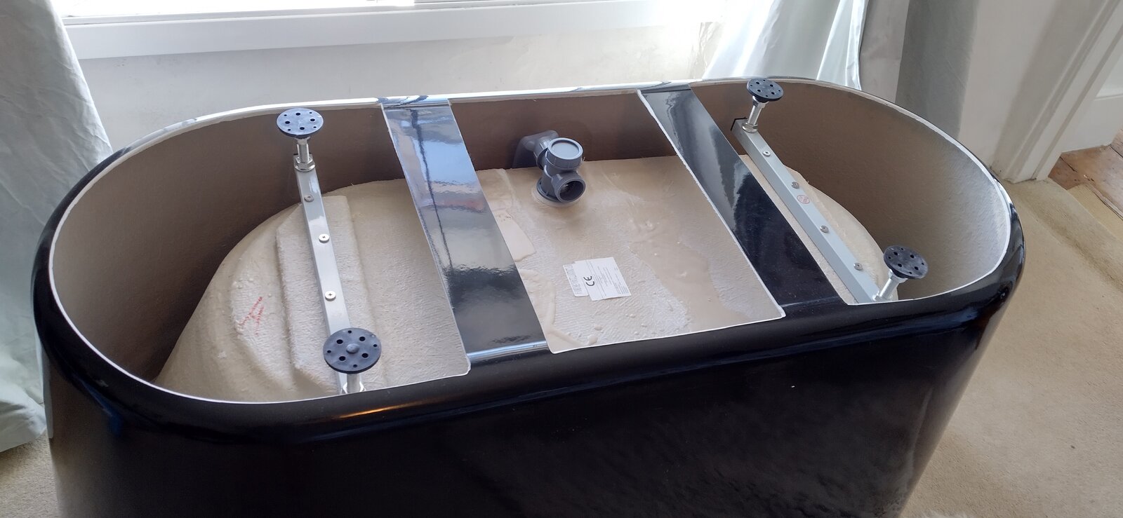

-The fitting instructions direct to silicon around the bottom edge of the skirt - is this just to keep it in place? If so, could I instead rout out recesses for the feet in the ply sheet I'm going to sit it on?

Time to look at using a waterless (HEPVO) inline trap methinks, with as short a flexi as possible running into it. given it's a floor level freestanding bath, it should have come with a flexi andway as you have to hold the bath up, connect the waste to the trap with a flexi then put it back down again. I presume you'll be cutting a section out of the side of the bath anyway to get to connect to the waste run?
That waste run does look a bit flat/uphill. Is that grey block on the bath a trap or just a coupling?
If the main waste run does actually have a fall to it then looks as if a cutout in the floor to accommodate the trap would work.
There's going to be precious little fall from trap to black waste run....
I do appreciate that it's a DIY job but you do need to be careful, if you don't get it right to start with it will be a real mare to correct afterwards. Even down to taking out the floorboard around the edge to give you that extra 20 odd mill of fall.

-The grey fitting on the bottom of the bath is the waste outlet coupling - either horizontal or vertical with a blank for the other.
- I can run the trap and waste under the floor and bring it up again to connect to the T
-I can get to the T behind the bath, and realise that with a flexi waste I can lift the bath to connect/disconnect
-The existing waste run has enough fall (I put the shower on a plinth to make sure!)
