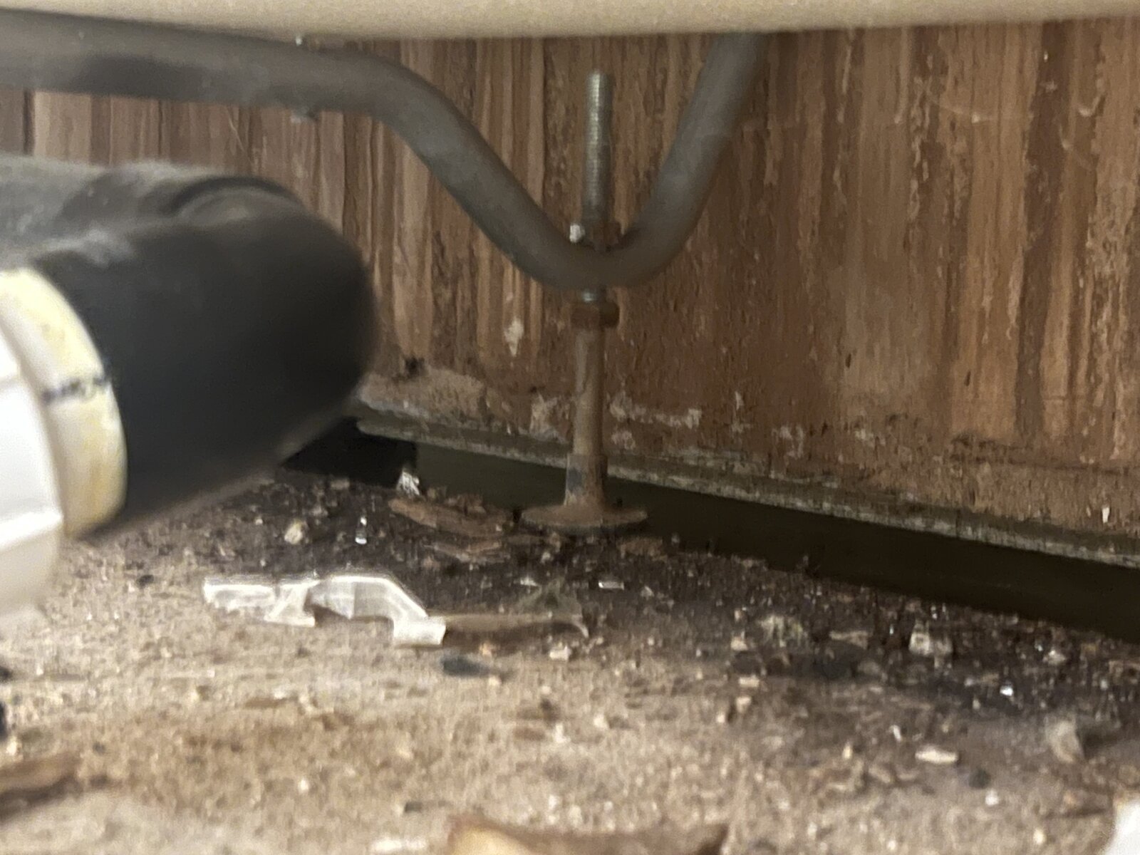

I’ve noticed 1 leg is not sitting on the floor of my bath? And the floorboards are missing on side of bath. Is this an issue. I had a builder round and he said it’s fine as no movement from bath as the sealant would crack if was and there’s a frame around bath.
We have been in the house for 4 years and been all good. There was a leak before we moved in but all good now

Don't know what exactly is supporting the bath ,but that leg isn't. It should be sitting on a floorboard ,and the lower nut isn't even tightened up.
