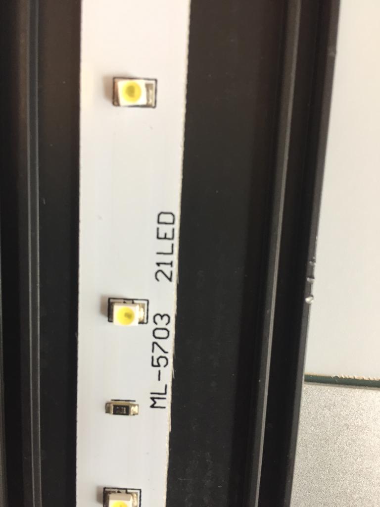

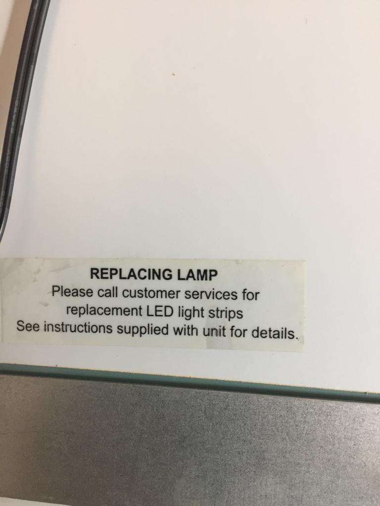

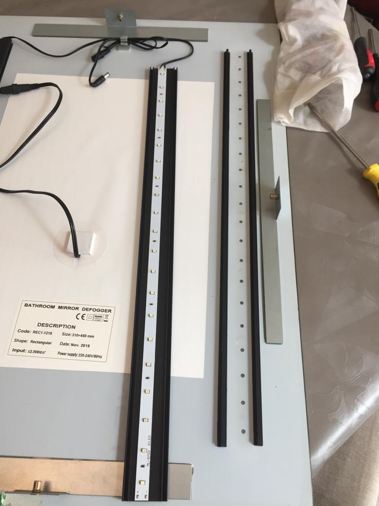

I am trying to replace Led Strips as per attached photos but I am unable to find the supplier/manufacturers/brand to get hold of led strips.
I will be glad if anybody has information so I can buy replacement.

A quick search doesn't bring up any specific results for the strip, for me.

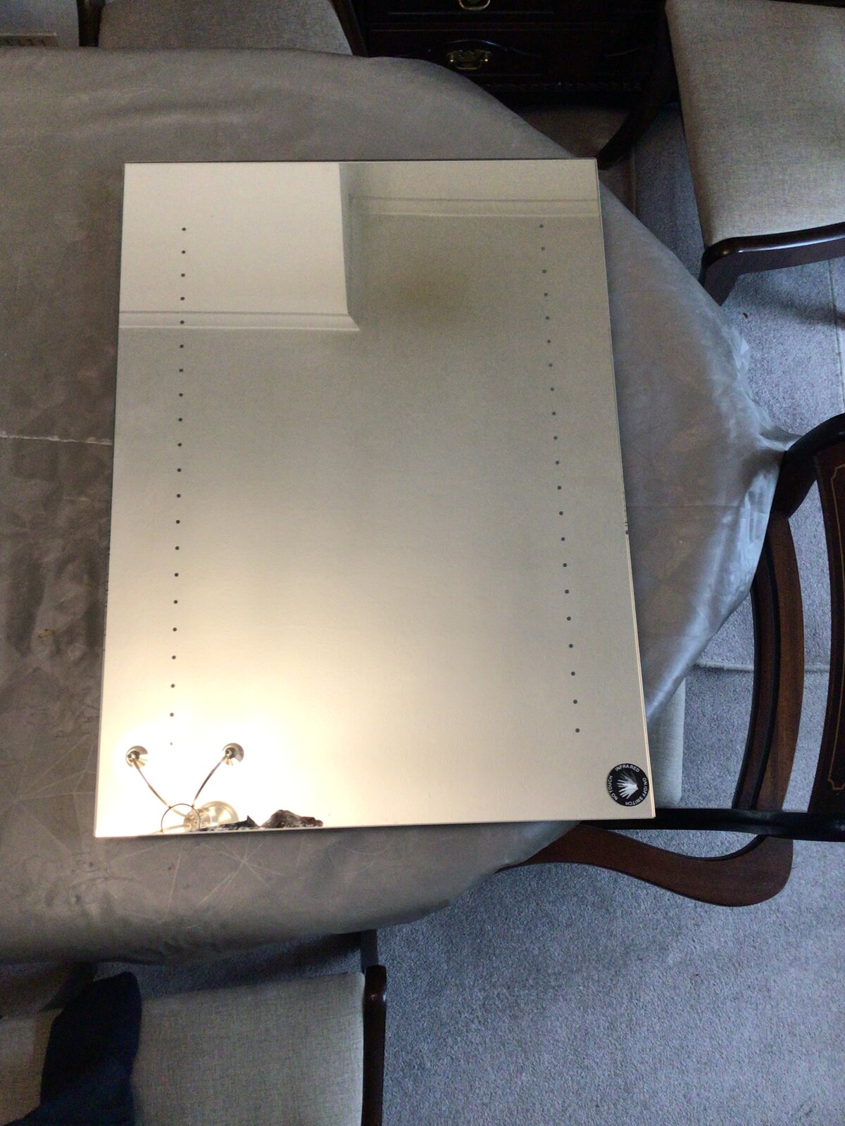

Theoretically, any led strip of the appropriate voltage could replace the existing. However, matching the hole spacing, to the LEDs may be a problem.
If you don't have any luck finding the correct strip, you could look at a COB (chip on-board) LED strip - this provides an almost seamless light source - at least some light should come through the holes!

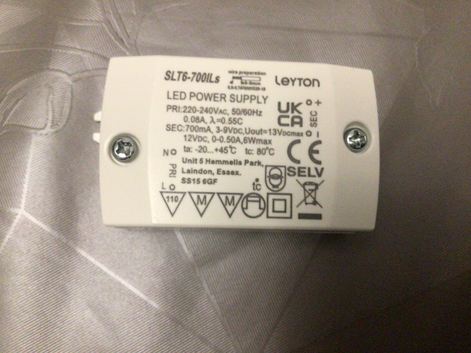

As suggested by RandamGrinch, I have managed to buy 12v cob led strip which has 252 leds per meter and wonder, if I will be able to use the led switch (photo attached) for powering it.
Many thanks for help.

No, that is a constant current 700mA supply.
You need a 12V constant voltage supply with a power rating higher than the rating of the strip.
Do you have a listing for the led strips you have bought?
The COB strips I have seen have a power rating of around 8 or 9 Watts/metre (at full brightness).
...so it depends on the length of your mirror, but a 6W power supply may not be enough - I'm sorry if my suggestion costs you more money! :oops:
Hi RandomGrinch,
Thank you for your reply. Mirror length is 590mm x 2strip.
I am unable to confirm the watts but have written to Seller and on response, I will let you know.
Please don’t worry, I should have checked the wattage rating but no worries.
I also tried to get short pitch LEDs strip as per old ones that are 30mm apart.
Thanks for your help.
