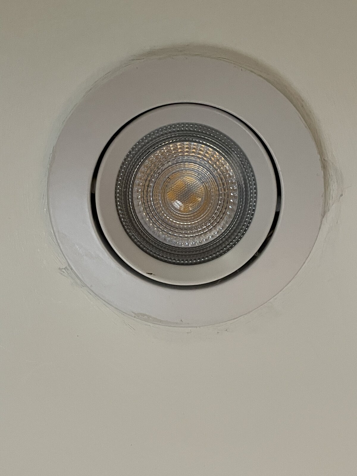

Does anyone know how to get the bulb out of this bathroom ceiling light? There’s no obvious clips holding the bulb in place, so not sure if the whole thing comes out the ceiling (so the mounting and the bulb), or just the bulb - and if it’s just the bulb I’m not sure how to get it out. Any advice much appreciated. Thanks

There are three basic types, G5.3 is two pins normally there is a cir-clip with that type, integral where you need to change the whole thing, or GU10 where you turn the bulb using a sucker
I am not sure with picture if integral or GU10, normally you can turn GU10 without the sucker but pressing fingers on the bulb.
