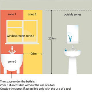

There seems to be a lot of discussion on other forums about putting an FCU in a zone 2 area of a bathroom. Some say it is classed as switch gear, i.e. removing the fuse cartridge is in effect a switch by then isolating the connected unit. The idea was to place the FCU higher up the wall and run a cable inside the wall to the illuminated mirror. Thoughts please.
Unless your FCU is IPX4, or IPX5. no.

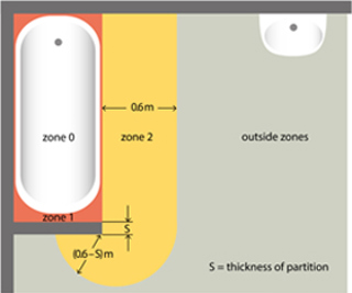

Zone 2:
"The minimum degree of protection for equipment installed in zones 1 and 2 is IPX4, or IPX5 where water jets are likely to be used for cleaning purposes. An exception to this requirement is a shaver supply unit complying with BS EN 61558-2-5 which, although it does not meet the requirements of IP4X, is permitted in zone 2 but must be located where direct spray from showers is unlikely. This type of shaver supply unit is the only type that is permitted in a bathroom or shower room."

My vanity unit 600mm wide will be next to the end of the bath, so I guess within zone 2 with the FCU located just below the ceiling. I have to build a small partition wall leading into the bathroom, and wondering if it’s better located there I would pull back the cable from the current location drop it to the FCU high up on the partition which will be outside the bathroom then run a new cable from the FCU to the mirror light. Obviously this is only if the FCU is not acceptable in a position above the vanity unit.
