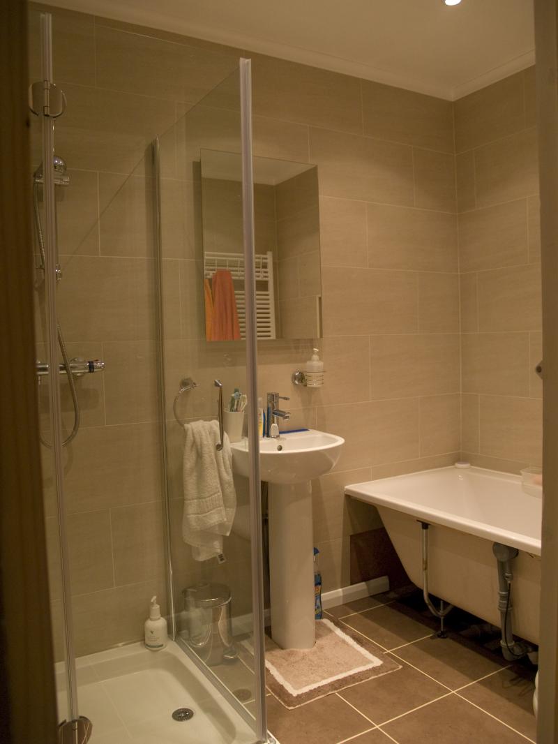

Have a look at this BAS...
It's my (unfinished) bathroom lit entirely by those 5 downlights. No other sources of light when I took the photo. Looks perfectly... illuminated to me! Apart from those daker areas at the top, the walls are uniformly and well lit, as is the floor - no bright spots and areas of darkness. In fact I might even say I like the darker areas at the top - they draw eyes away from those dead areas and into the room. Whoever said the goal of room illumination was to achieve a uniform light over every square mm of surface anyway? With the 120 degree LED lamps in, those shadows are much higher up the wall and more difuse - hardly noticable. The overall qualty of illumination is even better than with the halogens.
So perhaps you can see the problem myself and many others have with your ridiculous statements like: 'crippled and inefficient function', 'not acceptable under any circumstances', 'utterly wrong to use them to light a room', 'not designed to illuminate a room', 'they are offensive' etc etc etc ad nauseum. The fact is they are laughable statements - laughably incorrect. You seem to pride yourself on accurate knowledge, but these statements couldn't be further from reality as experienced by many people who have installed downlights. You're entitled to your opinion, of course, wrong though it may be, but when you rant and rant on every related thread, often resorting to unpleasant personal insults, it's tiresome to say the least. The only person coming accross as a childish troll is yourself, which is a shame, as otherwise you are one of the most valuable assets to this forum.
It is extremely imperfectly lit because the design is so inefficient.
Nobody.
But that does not make deliberate inefficiency an acceptable design principle.
