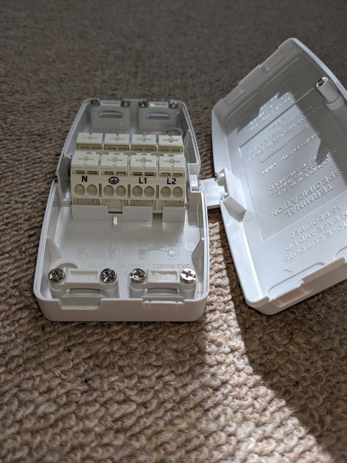

Hi,

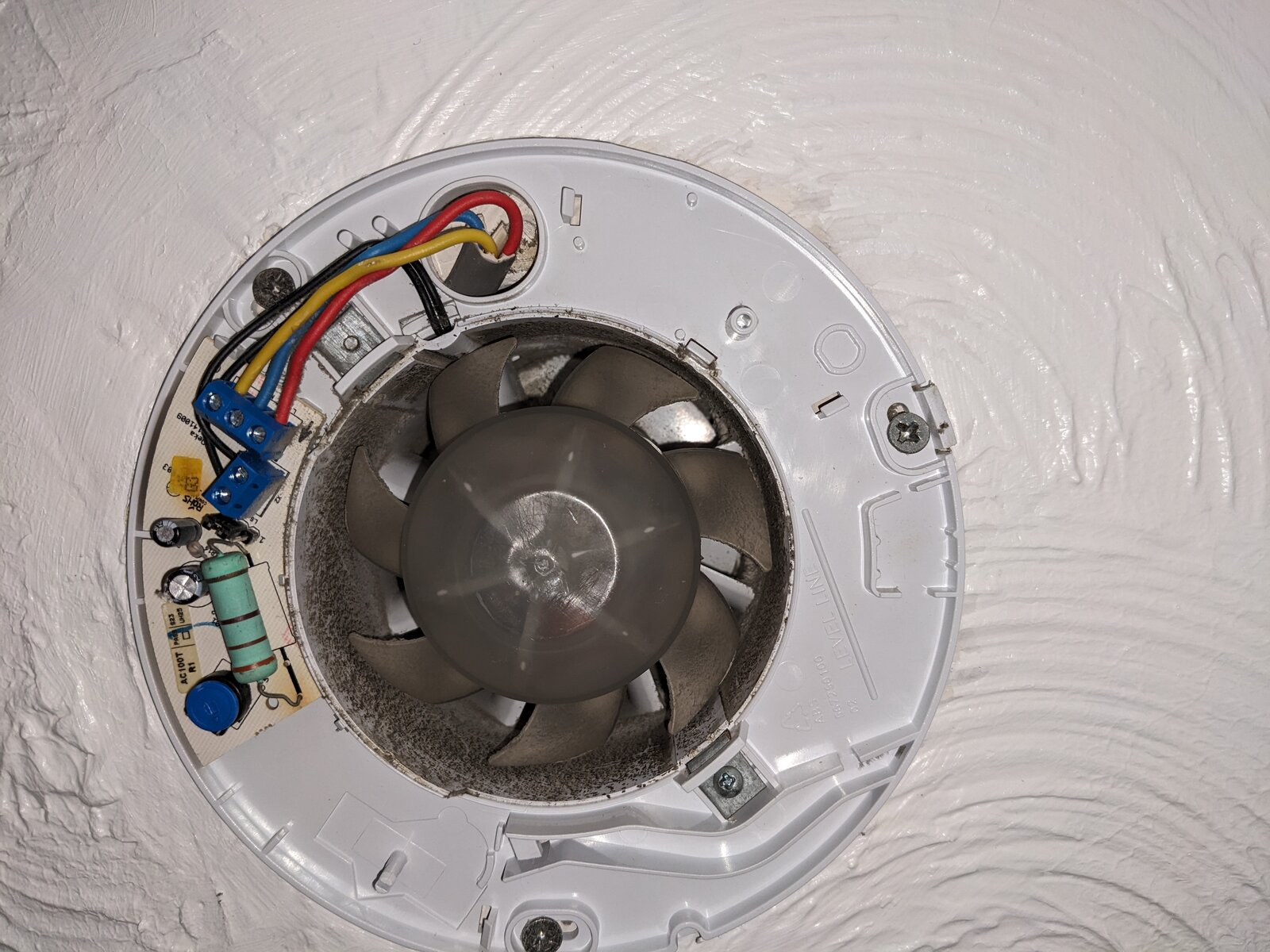

I'm looking to install a new bathroom extractor fan in my bathroom as I have a windowless bathroom and the current one I have installed in bathroom ceiling is just a standard one and isn't powerful enough so looking to change this to a Manrose MF100t inline extractor fan.
Attached photos of the Hager J804 4 way terminal maintenance free box and also image of current existing wiring in current extractor fan. I have the 3 core and earth 1.5mm.
Looking at the current wiring in current fan, we have red, blue yellow and black wire.
The 3 core and earth cable have 4 wires - grey, black, brown and a bare wire without sleeve.
Just wanted to check, looking at the terminal box we have 4 terminal blocks with each block have 2 ports (not sure why).
Would this work as follows:
N - blue existing wire (one end) , grey wire oppostite end
Not 100% sure but 2nd terminal block appears to be for earth - yellow existing wire (one end), bare wire with a yellow / green sleeve on other end
L1 - red existing wire one end , brown wire opposite end
L2 - I am unclear on this one. We have black wire currenting exisiting and on new 3 core and earth. Would these connect together?
Also does anyone know why 2 ports per terminal block?

I can see 8 ports, 2 ports per terminal block, 4 terminal blocks. One side. The other side also appears to have 8 ports, 2 ports per terminal block but 4 overall blocks.
There are four terminal blocks, each with four ports; two each end so sixteen ports altogether.
Yes.
Yes.
Yes.

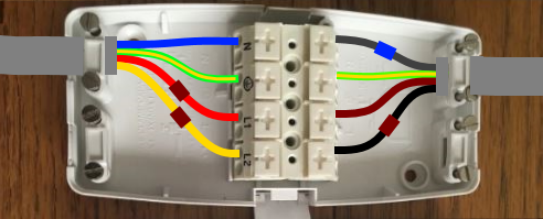

No you don't. There is no black wire in the red, yellow, blue cable.
Yellow one end, black (from brown, black, grey cable) opposite end.
Thanks. We have two yellows now. I thought I didn't have earth wire.
2nd terminal block appears to be for earth - yellow existing wire (one end), bare wire with a yellow / green sleeve on other end to connect you said yes but then you mentioned for L2 port - Yellow one end, black (from brown, black, grey cable) opposite end.
Theres only just the one yellow wire from existing.
In existing connection in fan, two black wires running into a seperate block. What happens to this? Does this still go in the 4 way hager terminal box or does this wire need to be terminated?
The yellow is nothing to do with earth.
The earth wires are the bare ones which might have green&yellow sleeves.
Yes.
NO
Ignore the sleeving - a bare wire both ends.
That's right.
Nothing. Leave it - that is the wires to the motor.
They are not connected to your cable
I don't understand.
I don't understand.
Many thanks.
The last part was in reference to the two black wires but you answered this here in that they relate to the motor. All clear now. In other words just to add so the bare earth wire in the 3 core and earth (new) we do nothing with this as I have no earth in existing so we leave as is in the new 3 core and earth cable, doesnt require stripping.
