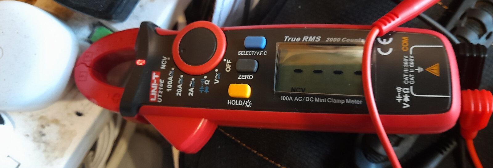

I have two testers, Testing for live.jpg1727654624119.jpeg both can detect voltage without making direct contact it is called NCV or non contact voltage, and these can test without opening the fan to see if there is power, first one expensive £35 second one wife got for free, adverts say £1.03 so cheap enough the polarity test useless, but rest works OK. These 1727655193833.pngwere what we did use, but at £26 (screwfix) seem expensive specially since the new ones show the NCV in 4 stages, plus a load of other functions.

I have two testers, View attachment 357268View attachment 357269 both can detect voltage without making direct contact it is called NCV or non contact voltage, and these can test without opening the fan to see if there is power, first one expensive £35 second one wife got for free, adverts say £1.03 so cheap enough the polarity test useless, but rest works OK. These View attachment 357272were what we did use, but at £26 (screwfix) seem expensive specially since the new ones show the NCV in 4 stages, plus a load of other functions.

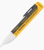

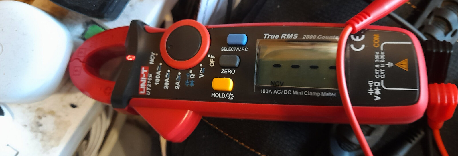

The tester seen here held close, but not that close to an extension socket, it was beeping slow, showing red light flashing slow, and one bar of four showing on the display, so should detect power without opening the fan. Note finger hold other end of tester, you do need to hold it to be that sensitive.
That is the beauty of having four levels, the same applies to my clamp on with NCV but showing this as so cheap.
I'm a bit surprised by this statement.
It may detect voltage, but it certainly won't detect whether the wires have come loose, or whether there both wires are connected elsewhere. It is very likely to give meaningless results, being basically a neon screwdriver.
Those magic wands detect voltage - not reliably either. For the fan to work you’ll need a live - which the wand might indicate, but you’ll also need a neutral. Being zero volts, the wand cannot test for it. You need a two probe voltage tester or that cheap multimeter.
There are other ways using a basic lamp as a test device. But that needs care and knowledge.

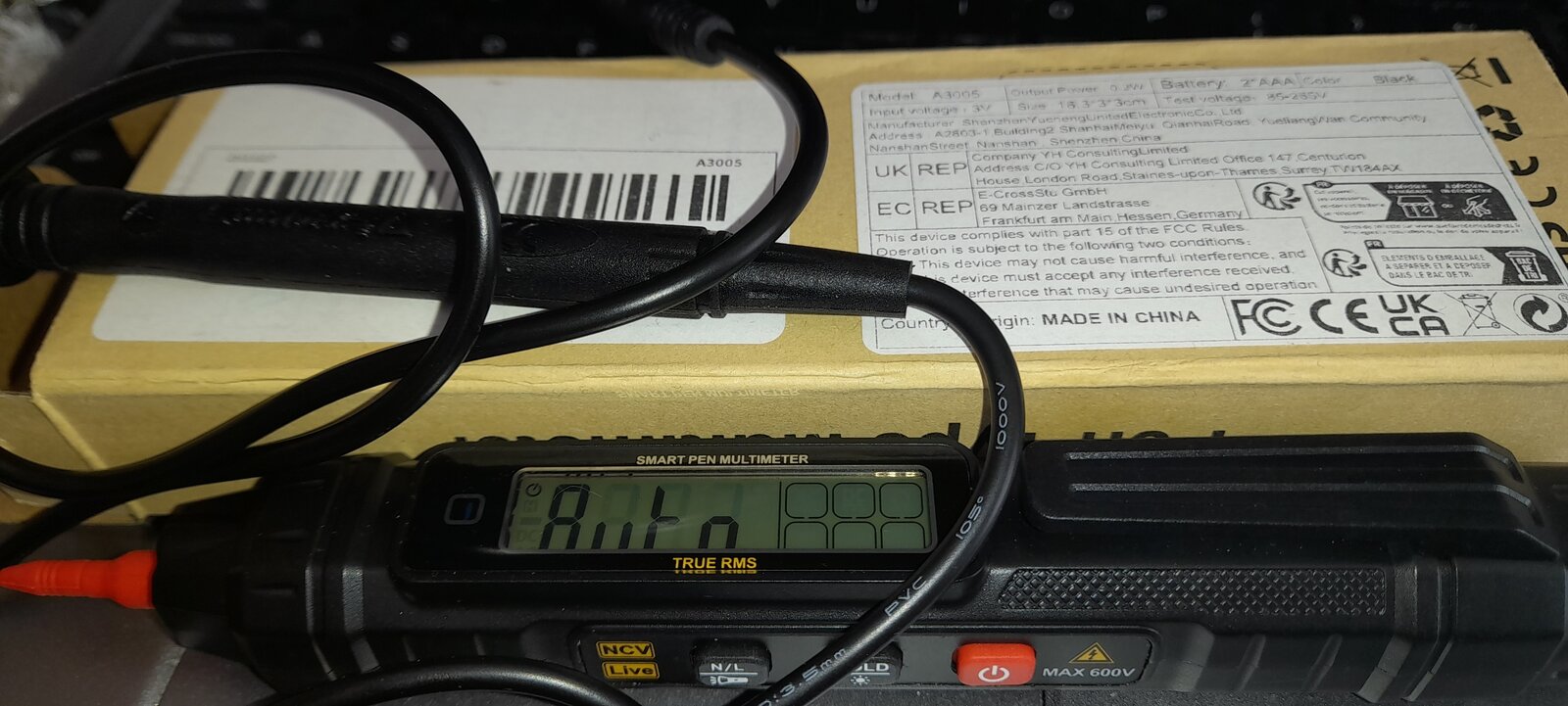

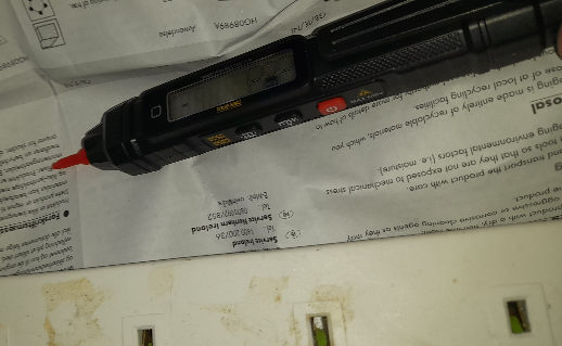

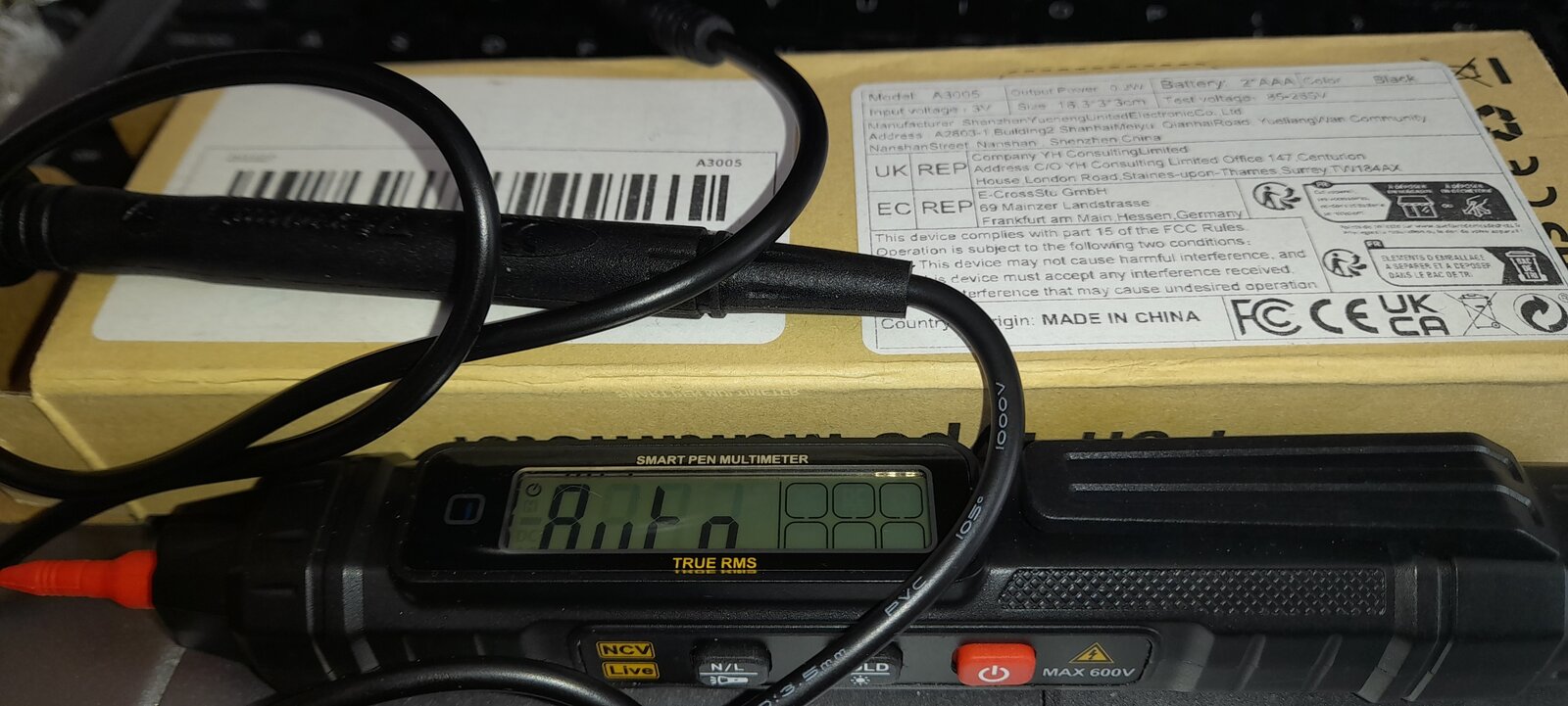

OK, something like this?

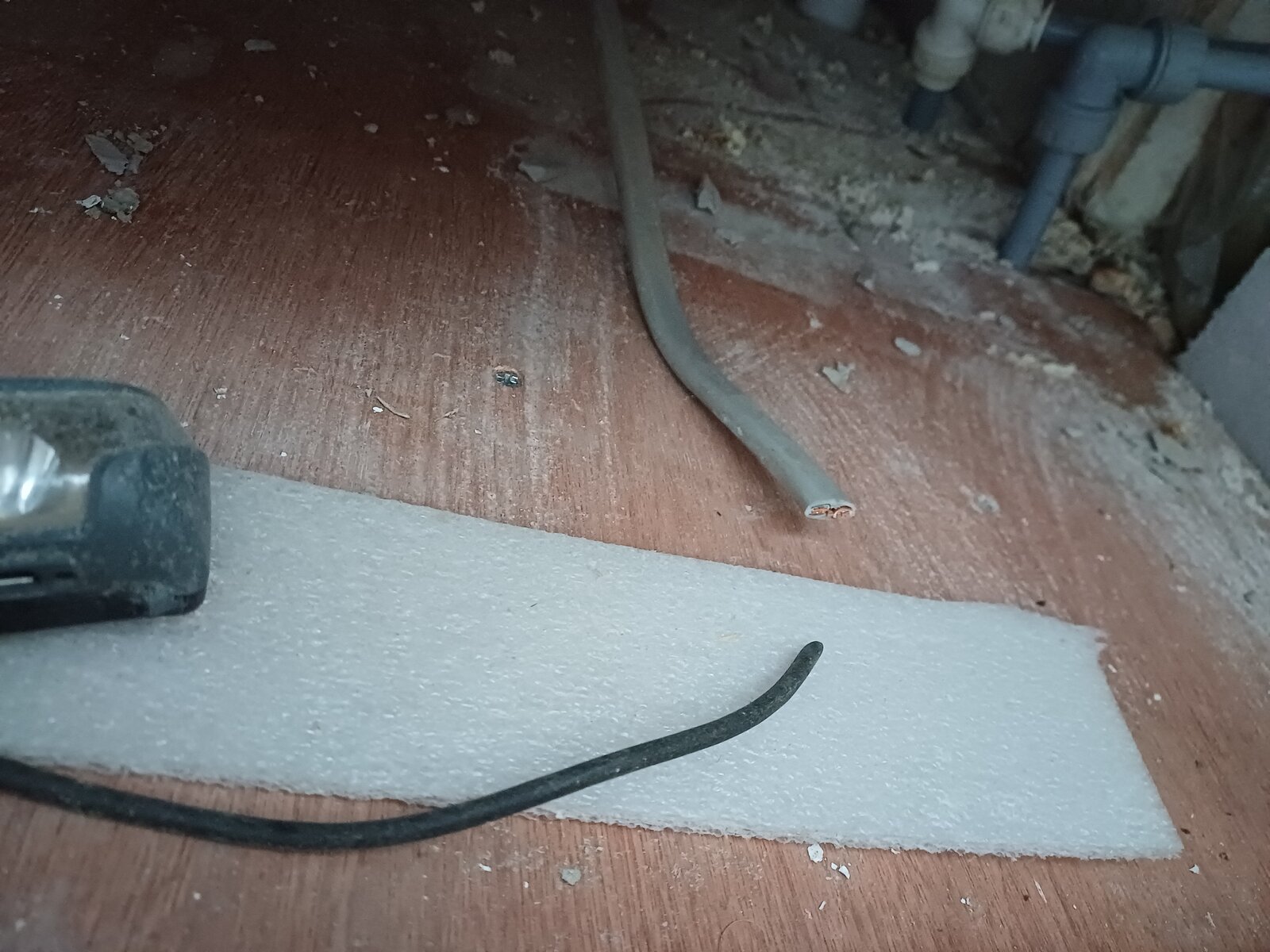

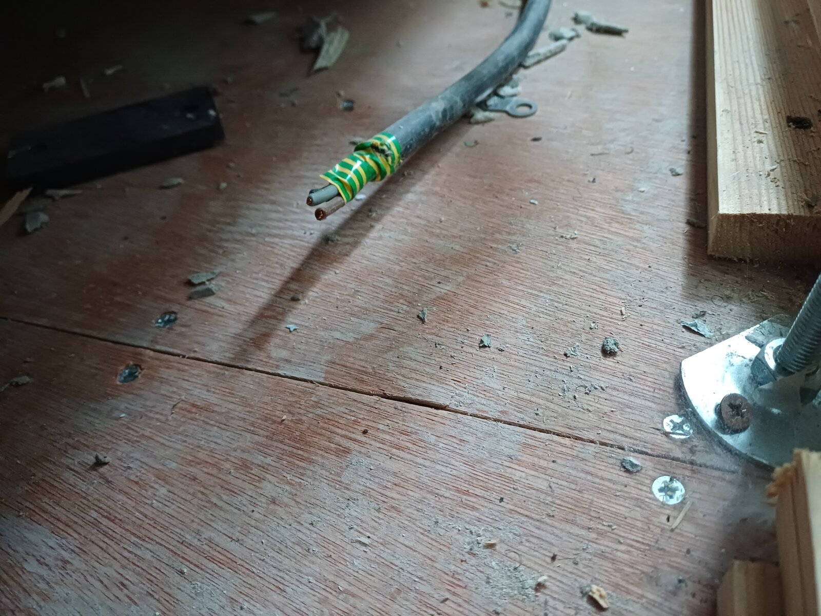

Will it also allow me to check if these two cables are 'live'? I removed the bath panel to fix it properly and found these, along with the usual array of crap that bathroom fitters seem to think is acceptable to leave under the bath, including a power tool battery charger!
