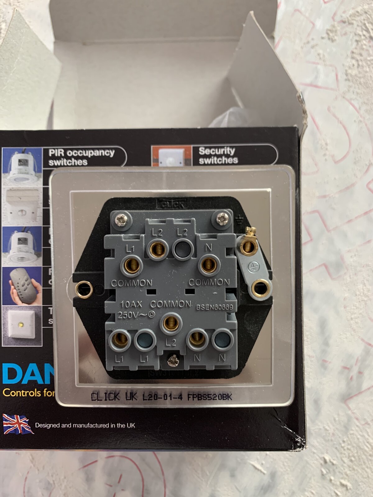

Managed to get some pics of the isolator I'll be using and the wiring diagram Scolmore provide.
Am I correct in thinking, L1 on the load (top row) is live feed in from my lighting circuit, then L1 on the supply (bottom row) is my permanent live to the PIR?
I can confirm tomorrow but I think the extractor fan also has a permanent live in which case this goes into L1?
Then switch live from the fan, and live from the mirror demister all go into L2?
Neutral from feed into N on top row and all neutrals from PIR, fan and mirror demister into N on supply?
And finally all earths into earth terminal.

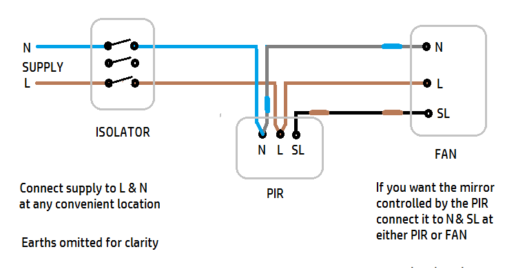

You haven't marked which terminals are which on the PIR nor fan.

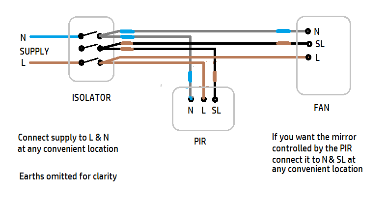

You do not need a three-pole isolator if you are not using the light switch to turn on the fan.
Do you intend to connect all the wiring to the isolator switch for a specific reason?
Would it not be better to wire:
supply > isolator >>> PIR >>> fan - connecting the mirror at the easiest/nearest position.

could I still use the fan isolator now that I have already got it?
Yes, of course. Do you not think my diagrams show that?
If so would I be correct in thinking I can just run a twin and earth to L2 (permanent live) and N.
Yes.
And leave out L1 (switched live) on the supply side.
Yes, but it does not matter whether you use L1 or L2.
And then from that head off to the PIR, fan and demisters?
Yes. Again - what do you think my diagrams show?

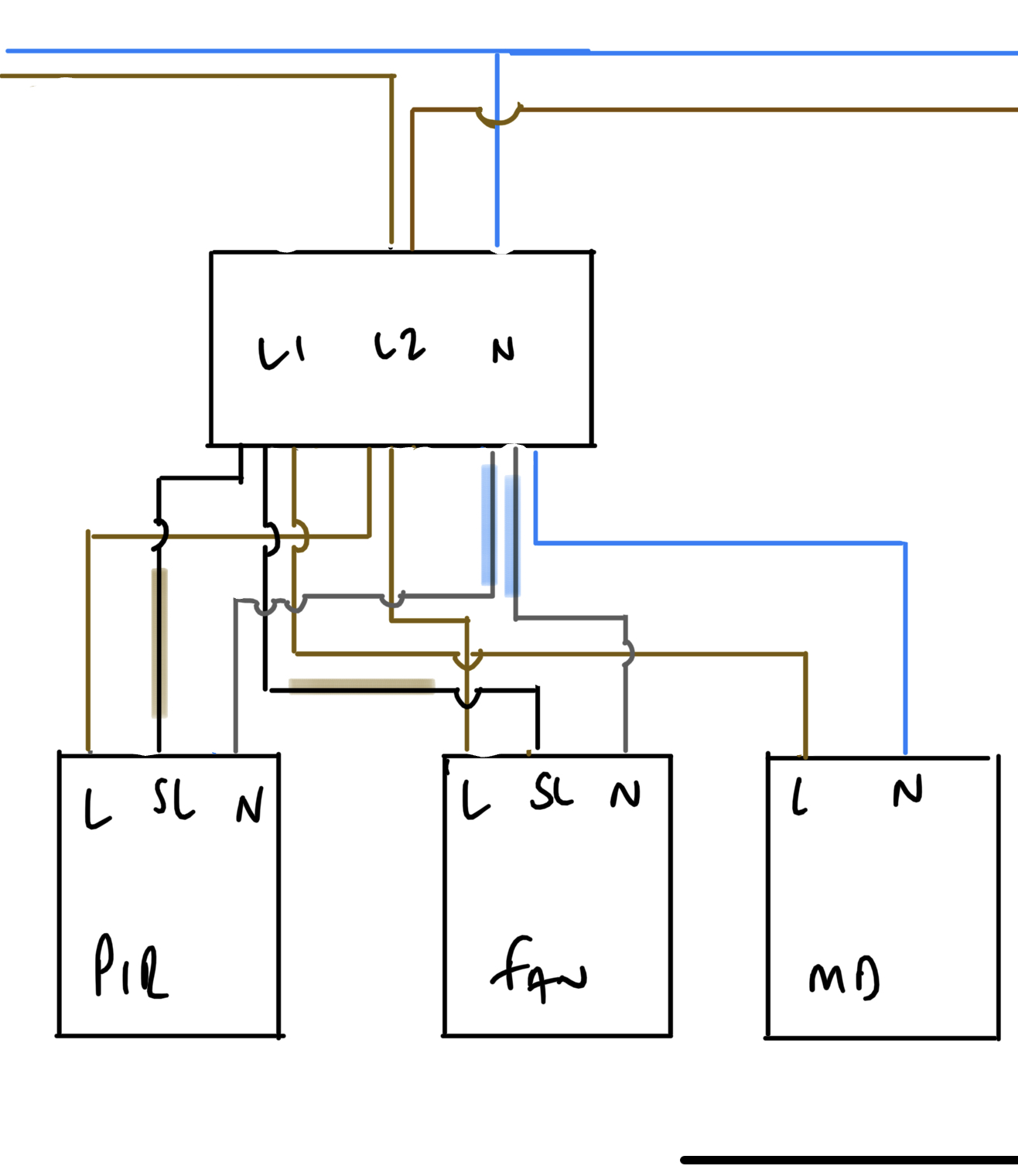

I’ve re done the drawing but want to check if this is ok before posting it here for confirmation.
I cannot see any new drawing.
Hi @EFLImpudence ,
Here is my updated drawing.
I didn’t include it earlier as I was waiting on your responses to my questions so I could amend the drawing if needed.
One question I have is with regards to the PIR & fan switch lives. Am I correct in thinking that although it’s the PIR that will activate the fan, they both are connected to live and switch live at the isolator as they both will continue to run on a timer function after movement is no longer detected by the PIR?
Why confuse the matter with the fan timer? Just connect the permanent line and switched line from the fan together, and connect this to the switched line from the PIR.
This leaves the PIR in control of the timing for all items.
Your assumption was generally correct though with your diagram - the fan will overrun after the PIR timer had expired which didn't sound like your original intention.
