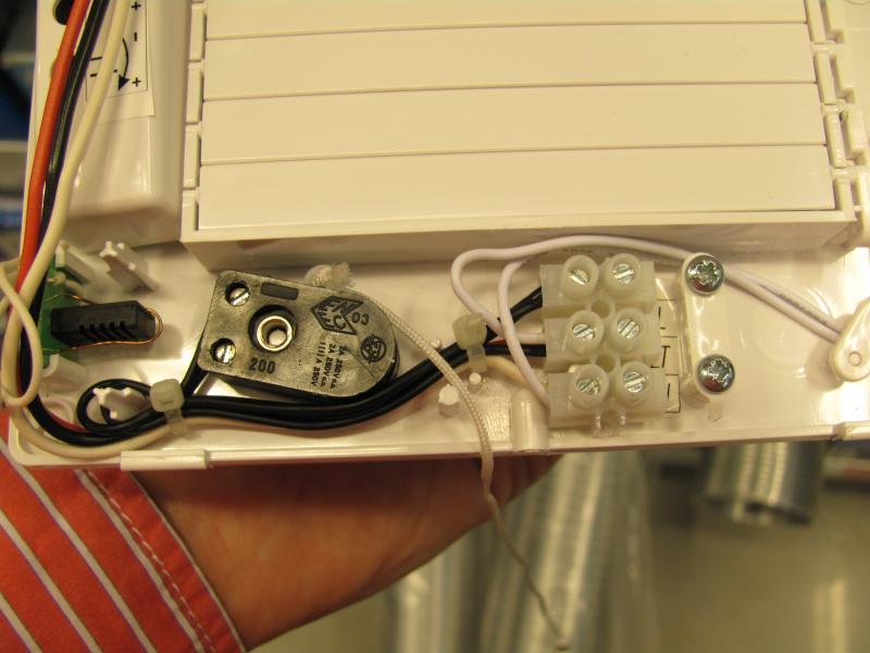

Bathroom extractor fan with timer, pullcord, humidistat help
I think this will do it but wait for confirmation from others
View media item 36712
Edit - Of course, if there is only one wire from the switch back to the terminal block you could remove the switch completely but it is difficult to tell from the picture.
Well I tried it yet again when I got home from work, and everything worked great. The fan switched off after a while once the lights were turned off, I was high-fiving myself.
But now I just went back in there to use the toilet and the lights won't come on, the ceiling switch still turns the fan on, but the actual lights don't go on. Is there something going on with the wiring in the flat??
Hi there, it's hard to tell from the picture, but the switch goes to L and SL. I removed the switch entirely and it worked fine until my new problem of the lights not going on...
Have you had the light fitting apart? If so maybe you disturbed a connection?
Maybe the bulb has failed/blown?
If the fan turns on when you operate the ceiling light then you almost certainly have a loose light drop wire to the light fitting (either the black/blue or the red/brown)
Or, as I say, the bulb has simply blown.

I haven't touched the light fitting, the fan is about 12 inches away from the light fitting with the wire coming in from ceiling. All I did was remove the old fan and put this one up. The light isn't blown, as it's a set of four halogens, unless they all have blown.
Do you have a safe/reliable way to test for voltage? MultiMeter?
Admittedly unlikely that all lamps have blown but either that or a loose connection at the lamp are really the only possibilities.
Do you have a junction box above the ceiling for the lights?
Yeah you were right; the light unit had died. It was an old halogen unit that was originally in the kitchen when we moved in. I put some other lights up as a temporary measure this AM and they are fine.
