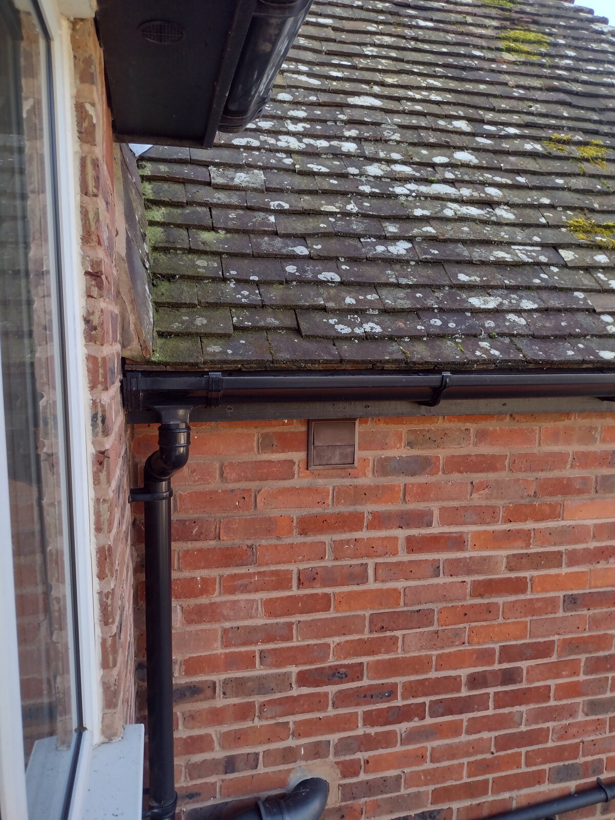

I am looking at replacing my bathroom extraction fan, because of the roof line the existing one goes out of the side wall only 120cm from the floor, even left on for an hour it still does not stop condensation.

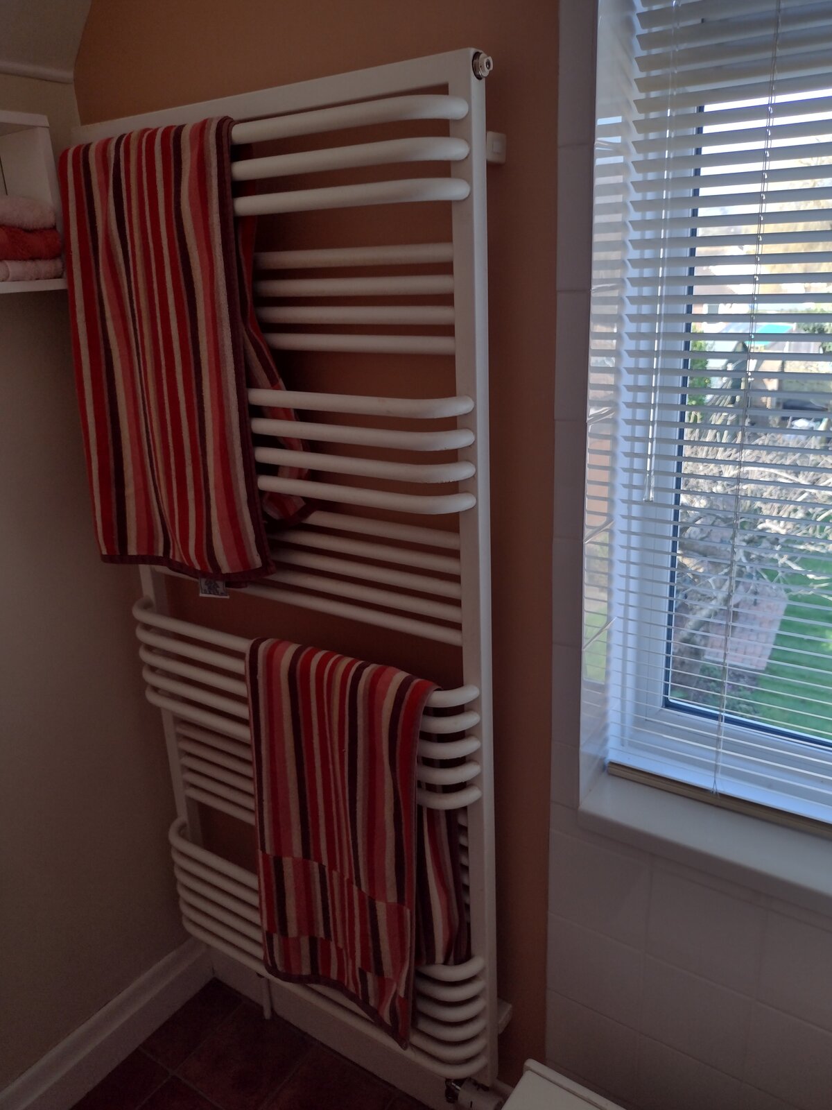

The rad is pretty big see photo.
There is a finger sized gap under the door, which is left open after showering with the fan running for about an hour.
The adjoining room is the home office.
Shower is over the bath and has a curtain not enclosure.

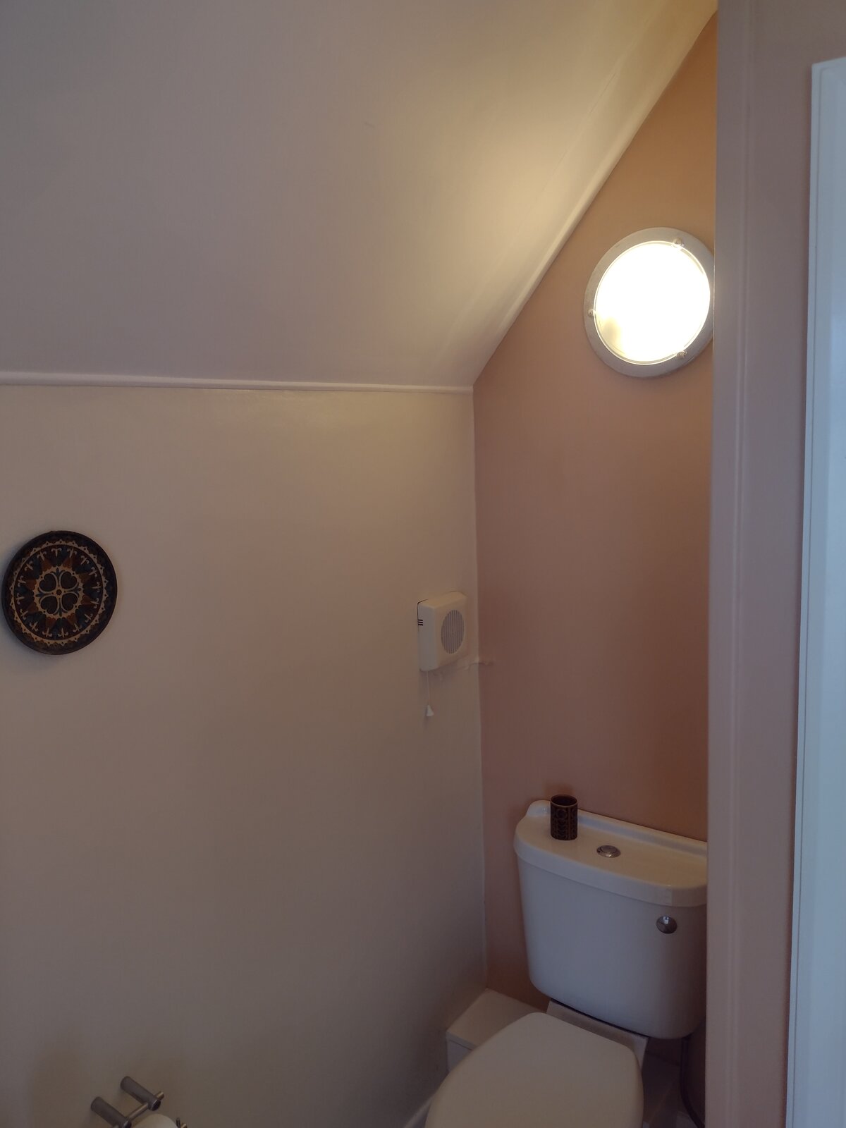

You can see from the photos it would be hard to pick a worse place for the fan apart from the skirting board! :LOL:

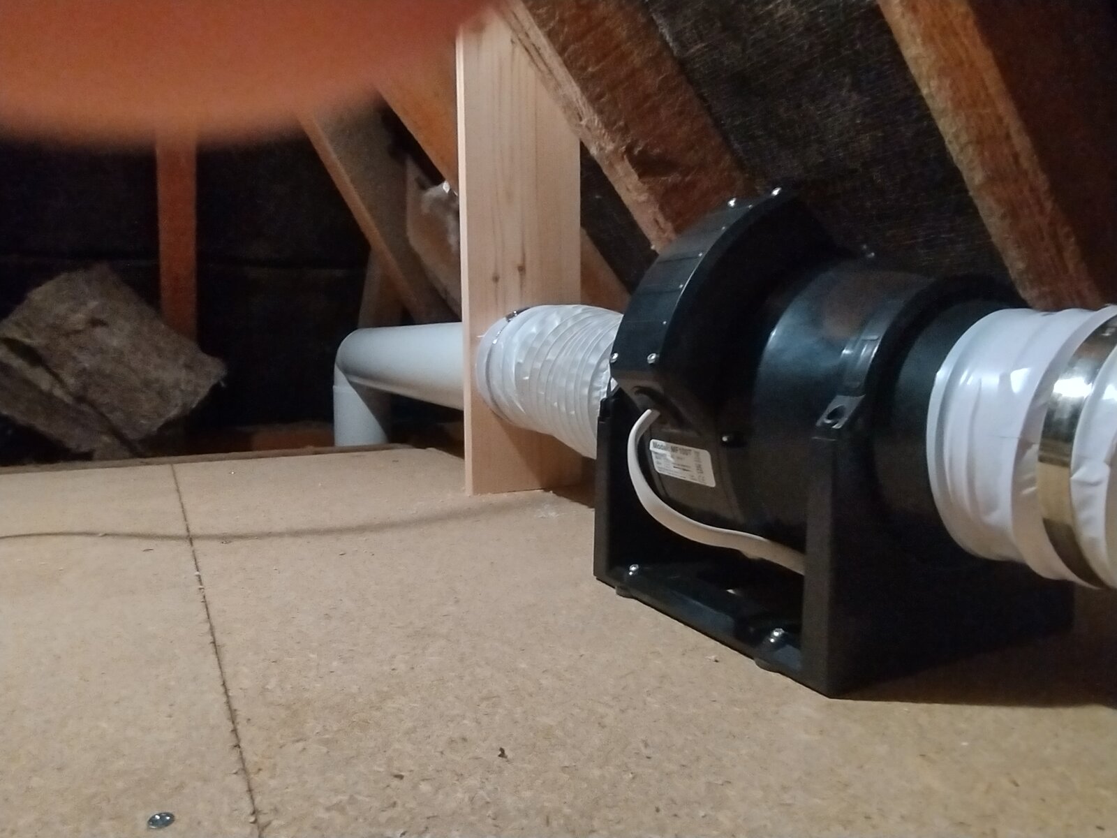

Yes JohnD, the plan is to put the ceiling vent over the shower end of the bath, run 4" flex to the unit and and duct down between ceiling and roof into the gutter and soffit hence the need to use flat duct, or failing that run the duct in the bathroom with an enclosure, but that's gonna look pants!

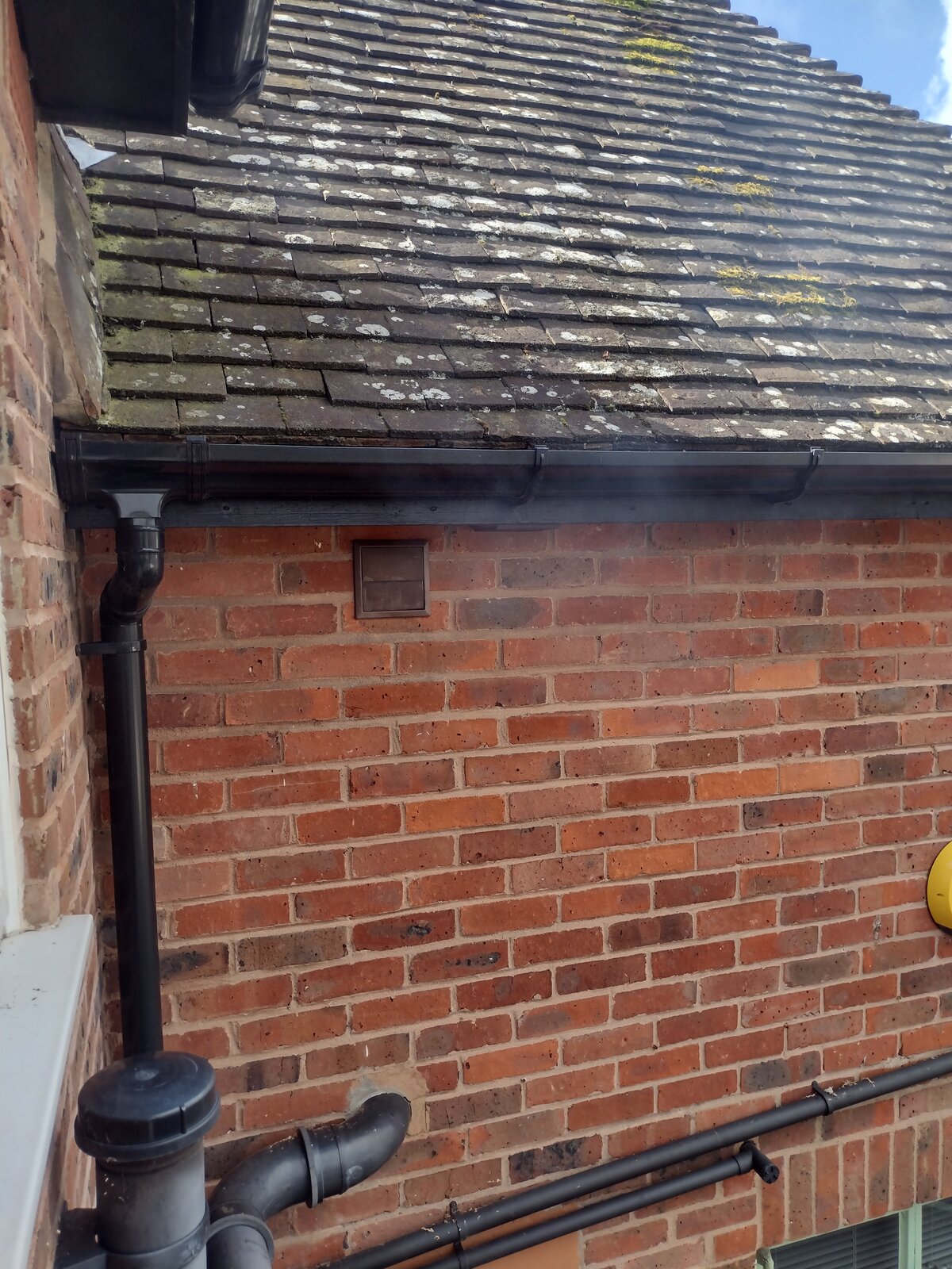

Update if anyone interested.
Went with a Manrose MF100T.
Old vent on wall now redundant.
Spent the best part of a day wheedling the flat duct through the pitched roof and through the soffit, but working fine now!(y):giggle:

PS I know in the picture it looks like in runs down both ends but it does drain to outside just my bad photography I guess!:LOL:
It is best to wrap the duct in insulation to combat condensation.
Some ducts are sold ready-insulated.
