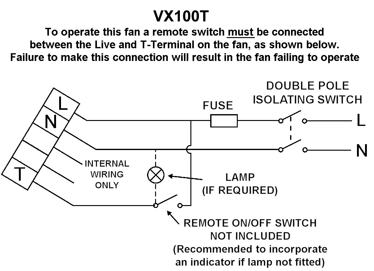

hi guys
I am changing my existing non timed extractor to a timed extractor
xpelair vx100t 12w/230v=0.05 amps
EEmm
should i include a a 3amp FCU outside bathroom and a 3 pole fan isolator in loft near fan or will just just a 3 pole isolator be ok, if i put just a 3 pole fan isolator 10amp wouldnt this trip the 6amp mcb if a problem occured whereas a 3 amp FCU would blow instead of mcb?
the existing non timed fan is connected to a light pullcord
thanks

thanks for your reply eric
i was just unsure wheather to use a 3 pole fan isolated being 10amp or 3 amp fcu or both
i.e if a problem occured with fan fuse blowing at 3amp would be better than mcb tripping at 6amp?
wouldnt it be safer,i also wanted to install same as manufacturers instructions but was a bit unsure.

The fuse is usually stated as 3A. The diagram is odd in not showing this.

1 light pullcord/ceiling rose straight to fan
2 light pullcord/ceiling rose -3amp fcu -fan with remote 3 pole isolator (diagram)
3 light pullocord/ceiling rose -3 pole isolator -fan
take your pick?

The 3 amp fuse will not discriminate against a 6 amp MCB. Most likely the MCB would go first.
Manufacturers instructions are for guidance and don't have to be followed especially if they are wrong as they clearly are here. Think what happens when they sell this fan in Europe where FCUs are not available or compliant.
