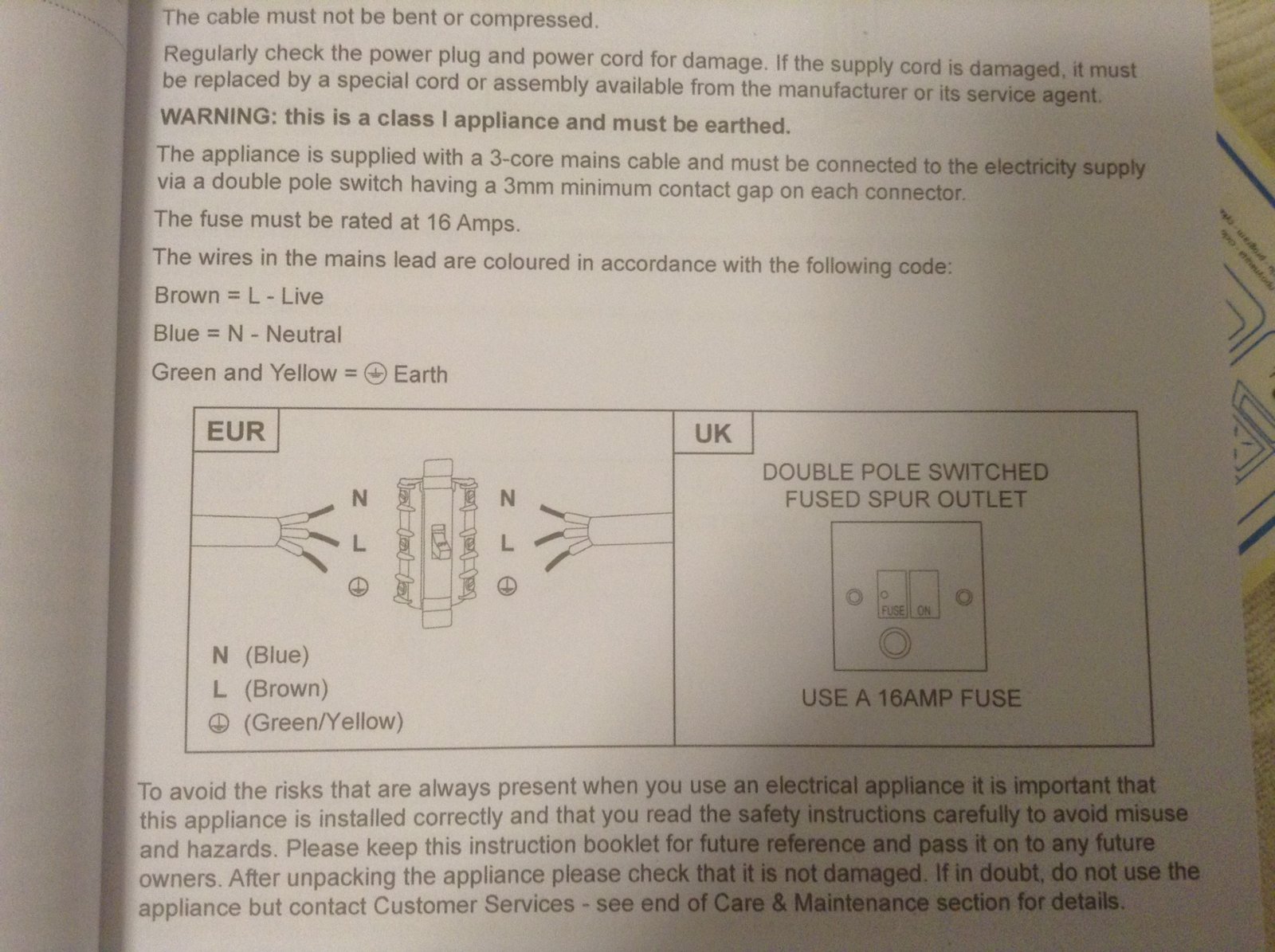

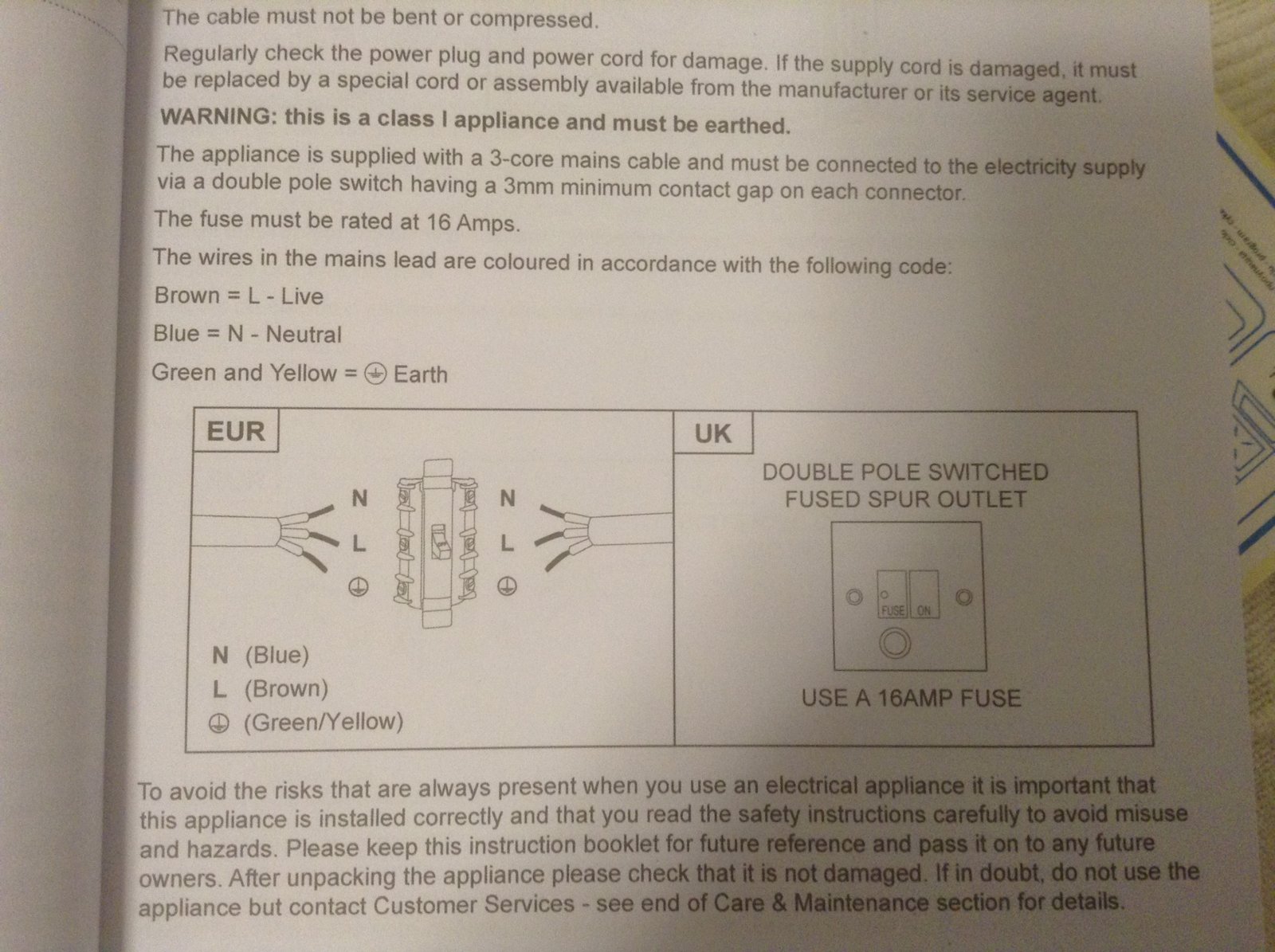

I don't have a link. It was a photo of a page from the MI for a Cooke and Lewis (B&Q) pyrolytic oven purchased by someone else who asked me where to get a 16a fuse.
