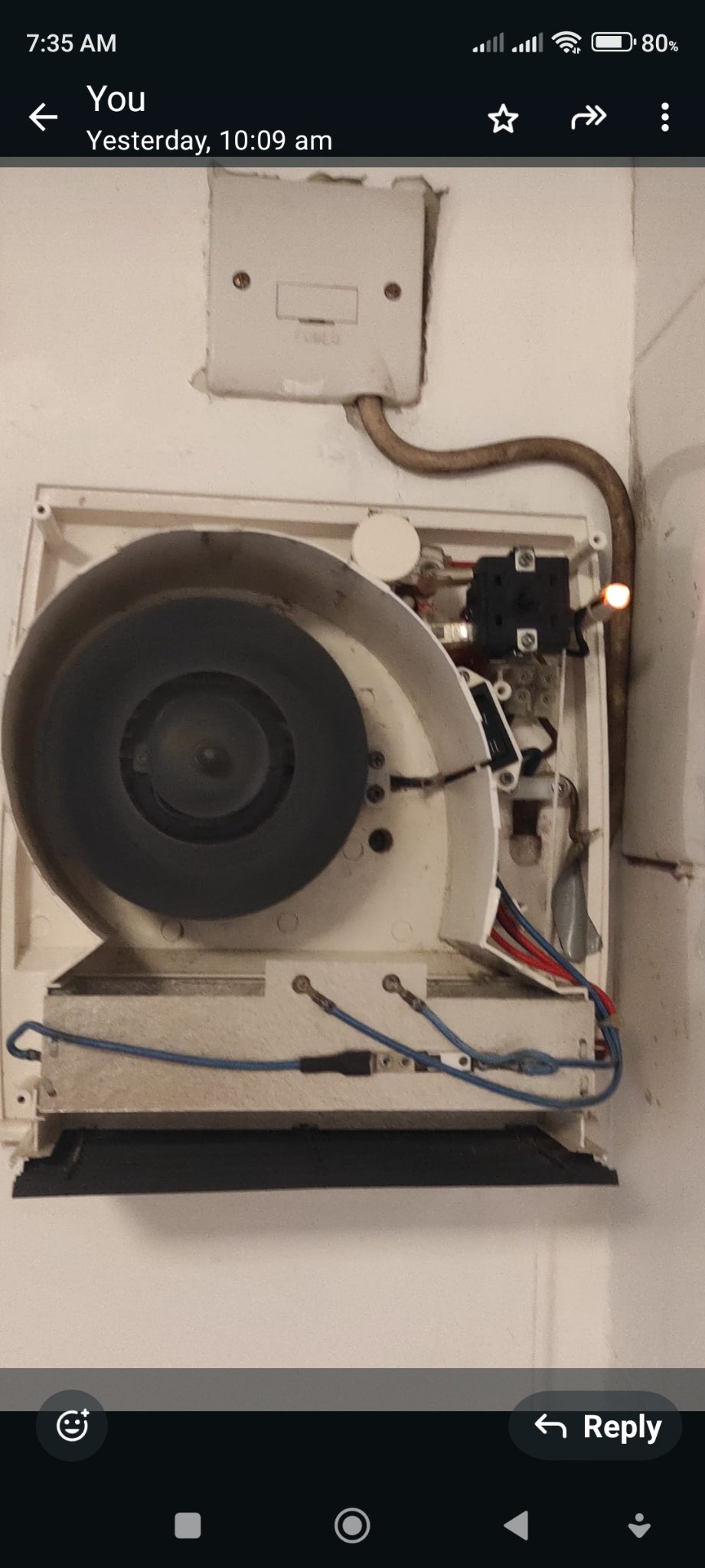

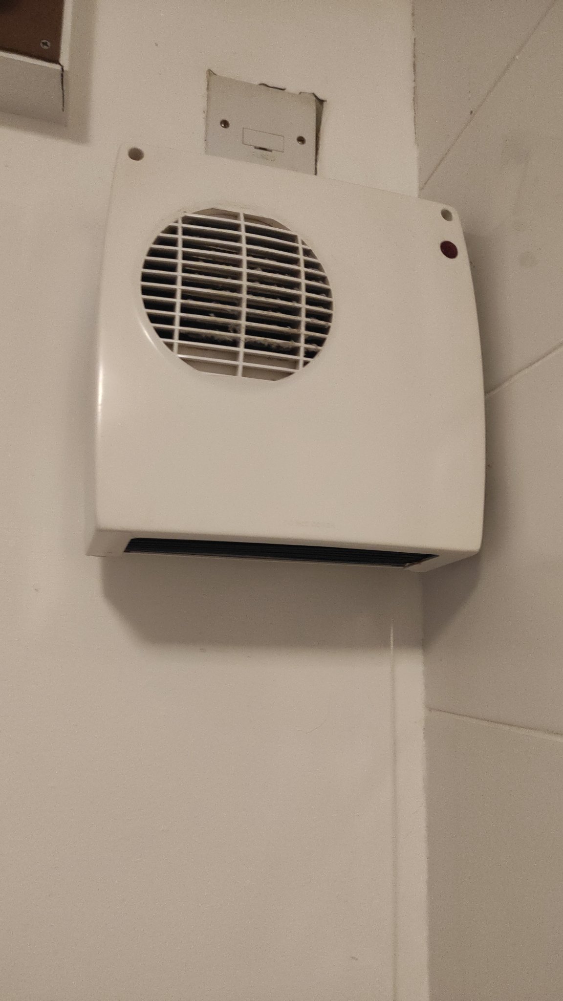

My bathroom heater is making a bit of noise. I opened the front cover and cleaned out the dust which helped a bit but the noise is still there. It it might be the bearings inside are not lubricated. Is there anything I can do to fix it e.g. lubricate a certain section? Should I use wd40 or another product? Any advice will be helpful..

It may very well have plain bearings. If you take it apart you can clean it out with a paint brush and white spirit.
Don't apply oil because fine dust will constantly be blowing through and will stick to the oil. You could try a dry lube like PTFE or graphite powder.
