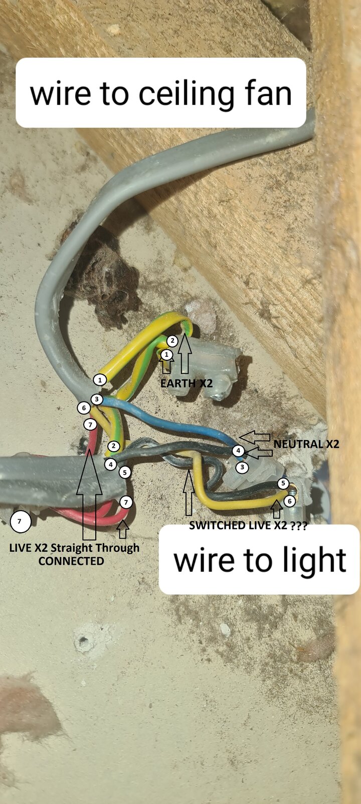

Wondering if any knowledgeable electricians could help.
We moved in to a property which has a light and extractor fan in the bathroom.
The extractor fan does not work when the light is turned on.
Replaced the fan and still nothing.
Gone in to the loft to look at the wiring removing all the insulation over the top of it.....whoever did this has created a fire risk by not using a junction box.
However, wondering if anybody can see anything wrong with the wiring causing the extractor fan not to power up???(picture attached)
Have tried identifying wires in the picture to the best of my knowledge.

Difficult to see but if it’s a timed fan have you got 3 and 6 the wrong way round (switched live and neutral)?
Do you mean at the fan??

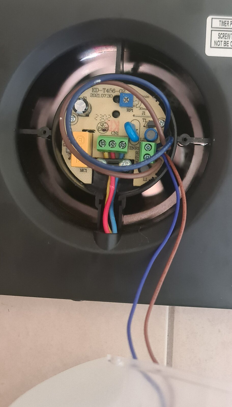

The fan is a knightsbridge EX004TPC with overrun timer
I have a voltage detector pen to check live voltage in wire
You need to check that there is a voltage on the L wire
You need to check that there is a voltage on the T wire that goes on and off with the switch
You need to check that the neutral (N) is actually connected to neutral. Your magic wand wont help you there, you need a multimeter, at least.

Weird.....so tested the terminals at the extractor fan with a multimeter.
Permanent live and neutral returns 247v
Switched live and neutral returns 0v when switch off.
Switched live and neutral returns 247v when switch is on
Does this mean the fan must be at fault?
