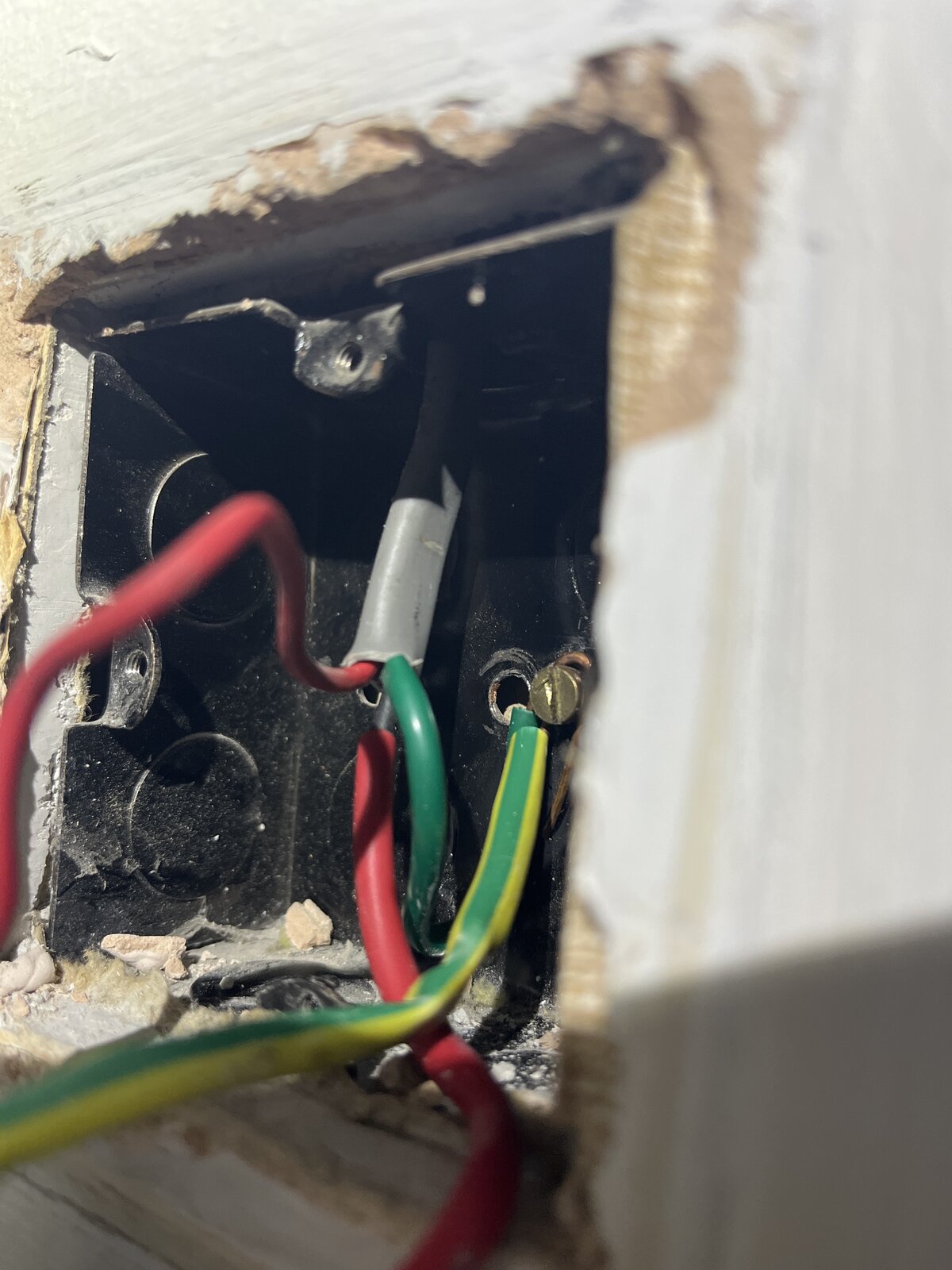

Hi all,new to the community but I would love some advice on my problem.Sorry if this is a bit long winded, but here goes.
Bought an LED light and LED mirror for the bathroom,wired the mirror to a connector in a pattress box box behind it,with twin and earth going up to the ceiling rose through the loft,wired the new light and the mirror at the rose,switched it on and both worked perfectly apart from the mirror wouldn’t work without the light being on. I bought a new double switch and that’s when my problem started,ran twin and earth from the mirror to the new wall switch wired switch one as the single switch was wired ,put a bridge in for the other switch and switched on the power put switch one on and the ceiling light came on but the stand by light was on on the mirror put switch 2 on and the circuit tripped now I can’t get the lights to work.I’ve tried taking everything out and putting it back to a single switch and I’ve taken all the wires out that I installed but I’m now getting the light staying on although it is very dim probably a bit like me I’m really puzzled by this.This afternoon I took the live wire and the black wire with a red sleeve out of the wall switch and the light is still on but dim.anyone know what I’ve done wrong or is it time to call an electrician TIA.

I assume you have mixed up wires, we are going to need to know what's going on in the ceiling, it looks to be a bit messy.
Oh and we don't normally use ferrules on fixed cabling (assuming it's not flex).
Are your existing cable twin and earth or single and earth?

Hi Guys,thanks for all the info and support,originally only one twin and earth from the light fitting and was wired as in the photo
The wall switch had red to L and black with sleeve to L1 and earth to back box.In the loft there is only one T+E going to the fitting,when I put the wires back to where they were originally I was getting 244v at the wall when on,0 when switched off,the sleeve was constantly 244v.At the ceiling T+E again 244v at red and 244v at black.on the LED light brown 156v and dropping .

you have 2 reds on the switch is that a T&E with 2 reds in - OR do you have 2 T&E to the switch and the neutrals are joined within the back box
not a great photo
can we see the Box as it looks like it maybe 2 cables - just not sure
Yes I have a fan but it’s independent of the wall switch although that’s not working too
Just one T+E at wall switch

so where does that go back to - a junction box somewhere
i see now its 1 T&E
the black is live - as it has red sleeving
that will go back to a junction box as shown in the links -
NO neutral there - so your mirror - where is that wired from >?

OK, so where did you connect the new T&E to ??
you will have a junction box in the loft - as that image will be a T&E with a Neutral black and the switched live Red (hopefully - BUT maynot be wired correctly at junction box for colours, so very unlikely - but could be ) Not trade but i have been involved in a lot of friends and family wiring upto 2006, and seen all sorts of things
The last post wasn’t about the mirror the mirror isn’t connected anywhere at the moment I’m just trying to get the light working again

it will all be about the junction box and what you did there
sounds like you have a meter -
is it still tripping ? and whats tripping the RCD or MCB or RCBO ?
did you take a photo of the Junction box - BEFORE you connected up another T&E to it ?
