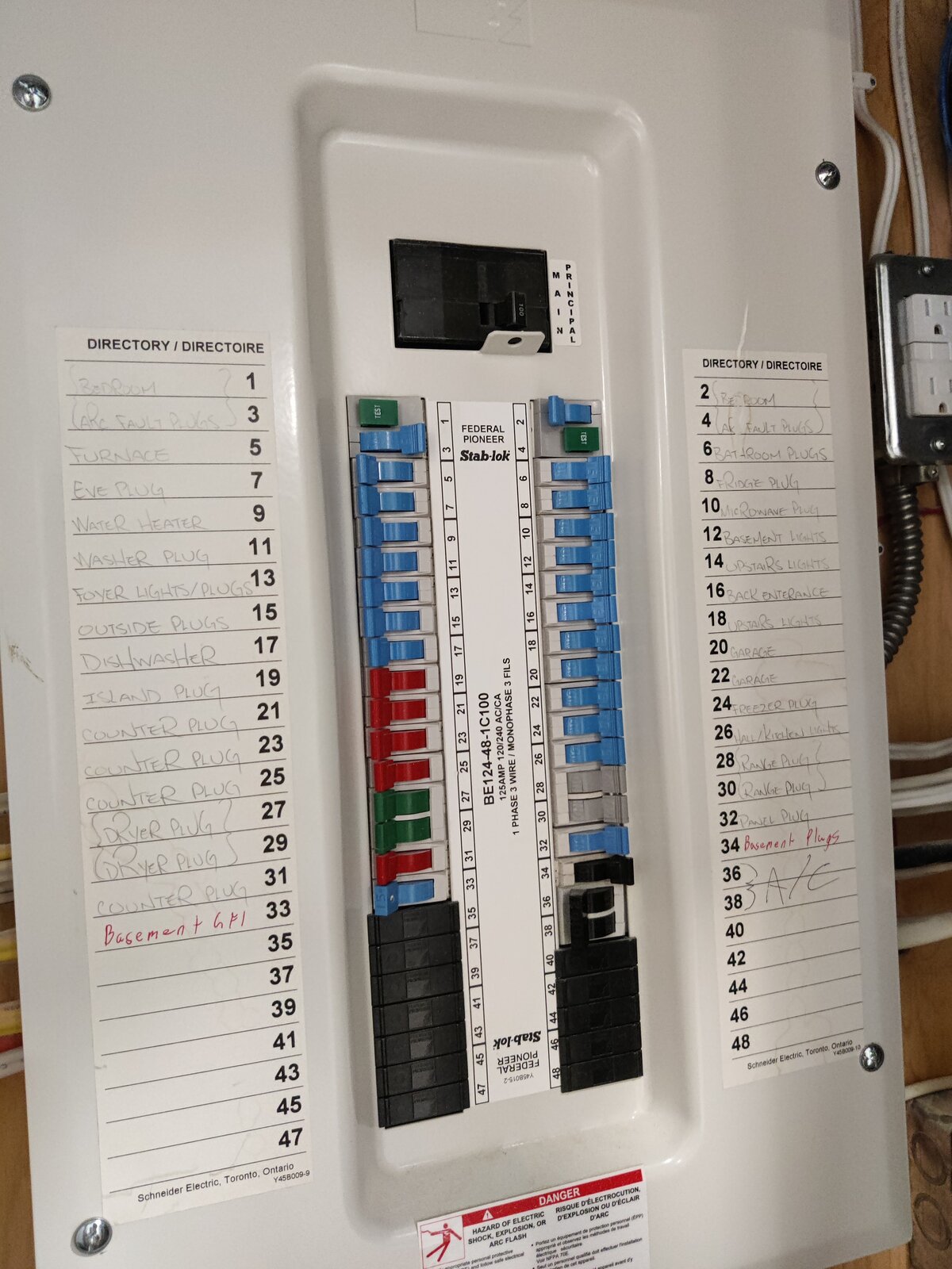

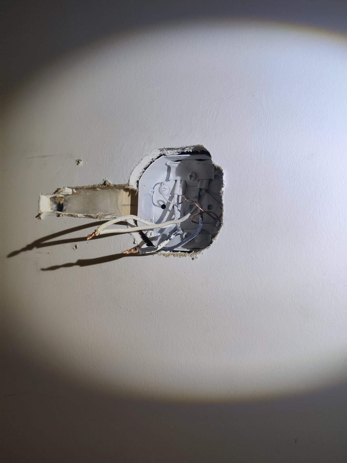

I'm installing a bathroom vanity light above a mirror in a remodelled basement suite. I got it working, but now I get nothing, possibly after fiddling with the base plate and screwing extra screws into drywall plugs. . There isn't a fuse tripped, the basement light fuse is working OK and ON.
When TEST is flicked, breakers 2 and 3 trip (Bedroom and Arc Fault). Basement GFI is ON and not tripped
This is in Canada. Can anyone help me fathom it?

I found the problem. GFI breaker on plug next to the light switch! Just reset and it's a go.
