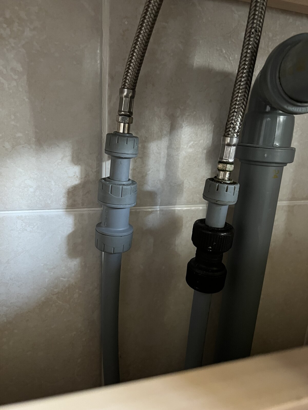

Evening all. Treated myself to a nice new mixer tap for the en suite this afternoon and thought I’d get on with fitting it when I got home.
Everything went to plan until I got to connecting the female thread tap connectors onto what I thought were BSP male threads.
I couldn’t get the thread to sit straight so I gave it up and put everything back.
Pic shows the current install which looks like the old grey Hep2O push-fit with compatible braided flexible tap connectors (which I’m guessing have a different thread to the ones on the new tap )
So, I’m looking for some advice on what the best solution/fittings is/are as I’d also like to add some isolation valves in too
Thanks all!!

Take it this Is a basin mixer?
Clear picture of connection nuts on new flexi connectors would be useful.
The originals look to be maybe 10mm push fit.

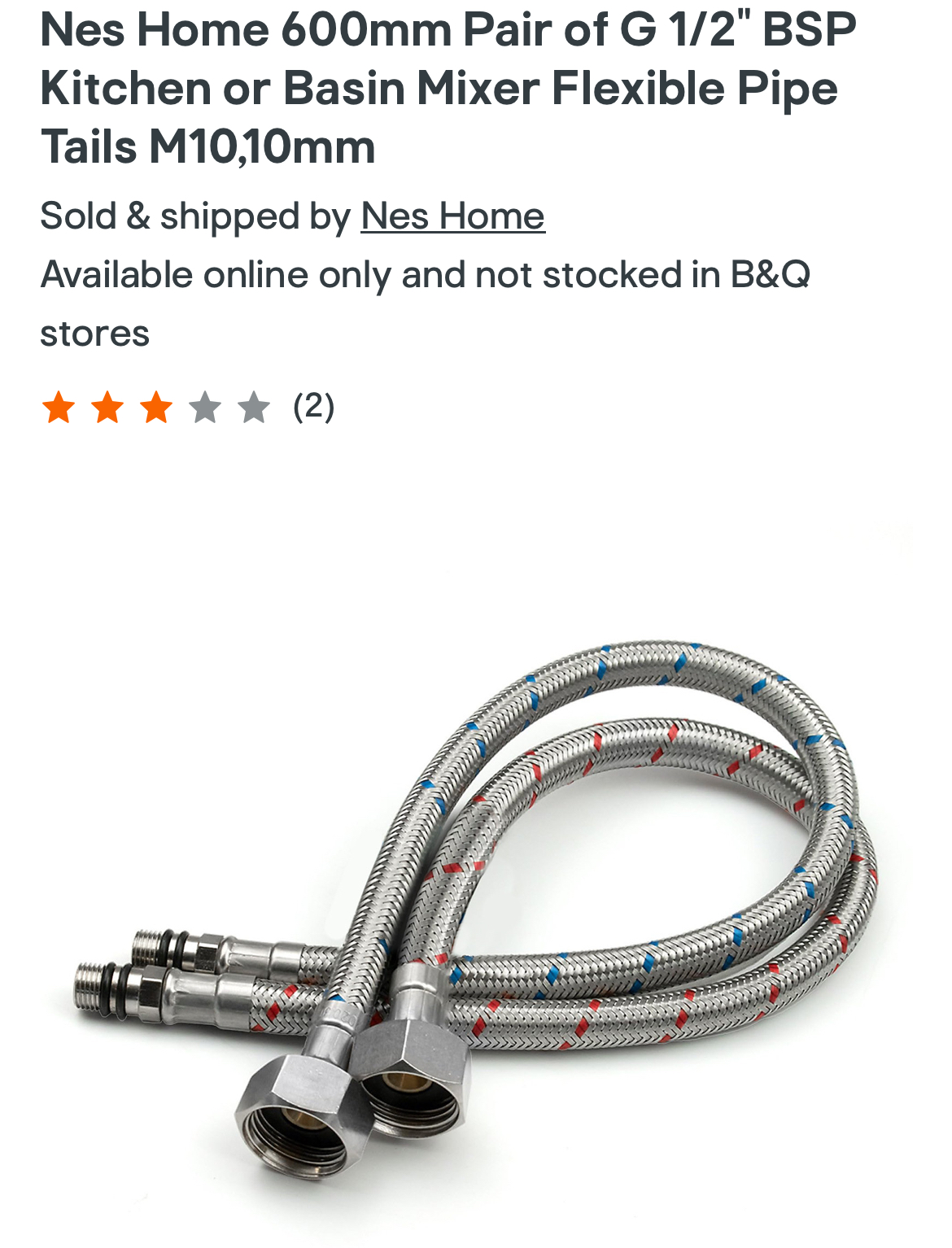

The new flexes are 1/2” bsp. I’m pretty sure it’s 15mm push fit pipe
Photo of new tap flexis.
It saves a whole lot of terminology confusion.
"IF" you're trying to screw the female flexi tap tails on to the top of those pushfit connectors (like it reads) then it will not work.
If you want to add isolators, I would use 2 of these with a short bit of 15mm copper between them and the pushfit couplings, the tap flexis then screw straight onto the top which are flat faced so won't damage the rubber washer in the flexis.
You could put them straight on to the pipe by removing the pushfit coupling but I don't like putting compression on to plastic pipe.
Your local independent trade counter should stock these (mine does but call them first) so you don't have to pay the BES delivery fee.
These lever isolators are better than screwslot type ballofixes which leak for fun.

Hi dilalio. Yes, that’s what I was trying to describe. I hadn’t clocked that the existing tap flexies had the grey plastic screwed ends and thought they were BSP threads.
I can’t get a photo of the actual flexies as I’m away with work today/tomorrow but they came with the tap and are identical to the pic below

Existing flexis more likely came with 10/12mm ferrules that pushed into polypipe stem reducer.
I must admit, I’ve never seen that type of connection on a flexi before but that basin has been installed for at least 15 years I reckon.
