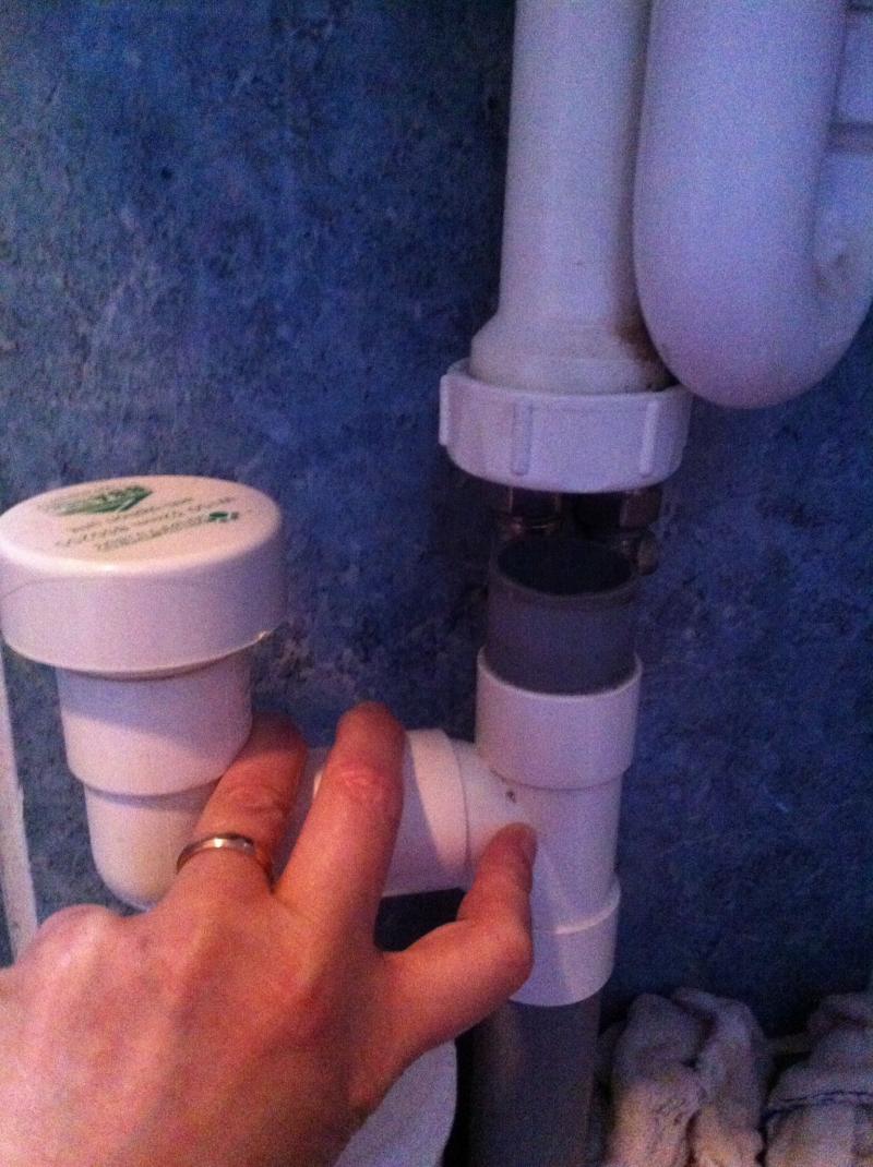

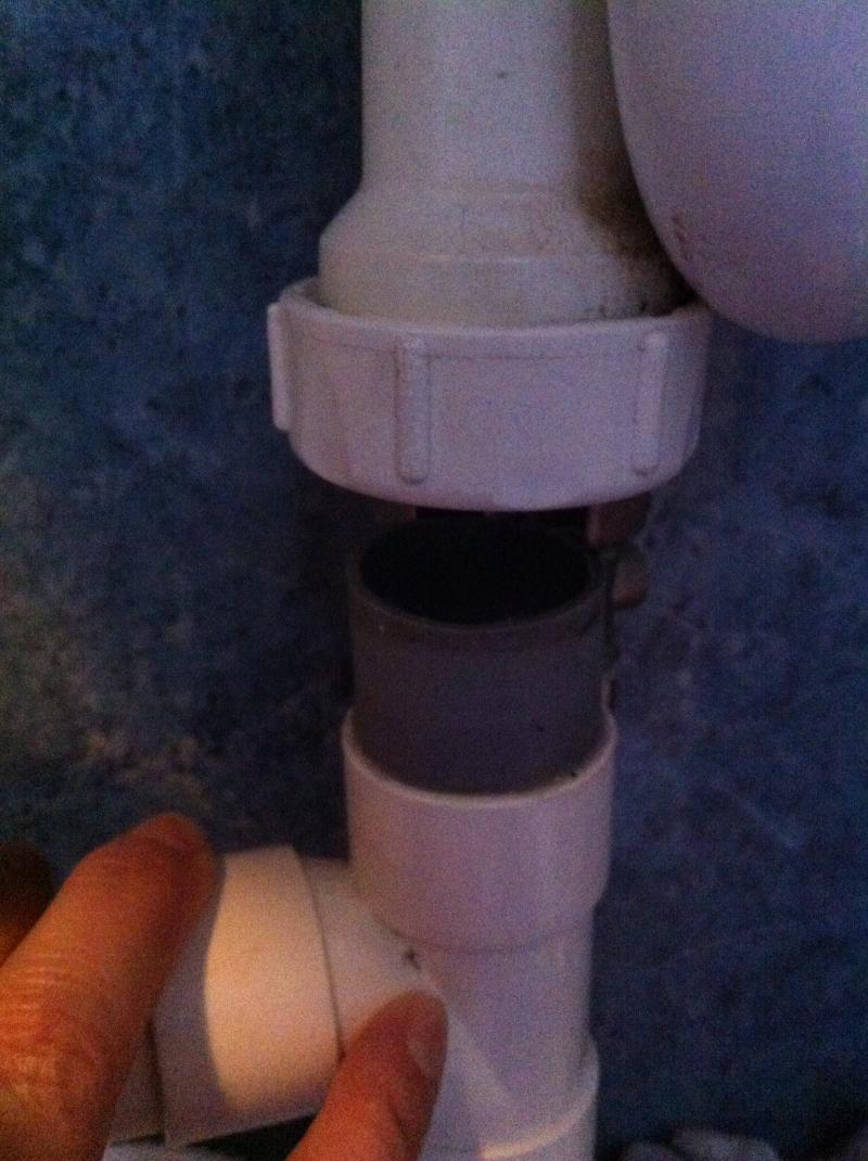

Which connection do I need to secure this grey pipe back into pipe above. Seems to me it was previously just glued in place as the screw above is not able to hold the grey pipe in place. Thanks in advance.
Eh...?
The grey bit goes in the White bit above...!
You need to unscrew the White nut bit, tread the nut over the grey pipe, then the plastic washer, then attach the black rubber seal to the grey pipe, cone side up, push it up, Then screw it all together.
That pipe will need clipping /supporting as the weight has pulled it out the socket.
The washer might be pushed up into the trap.
Brilliant, thankyou found the rubber washer inside the pipe, all fixed now. Many thanks.
