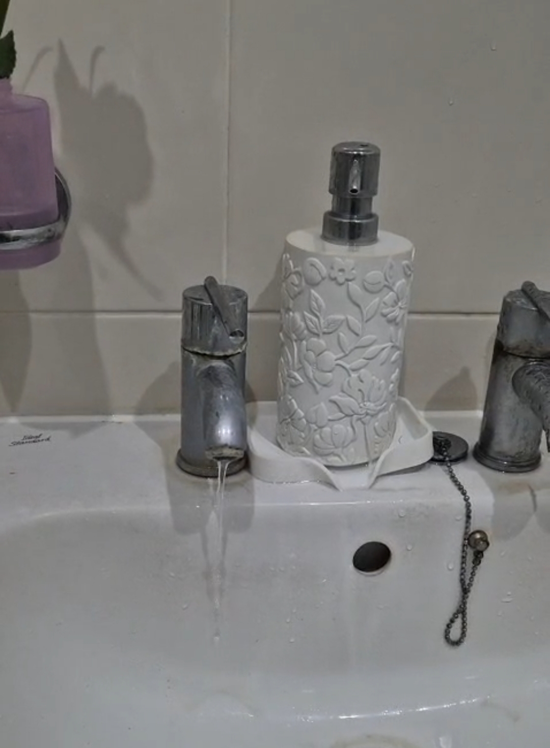

Hi
Recently the cold water bathroom tap starts running a bit of water with a sound but this only happens when the kitchen tap is turned on. As soon as the kitchen tap is off, the sound and running stops in the bathroom tap. The separate hot water tap is not affected.
Any suggestions?

Does water flow out properly when you turn the bathroom tap on, when the kitchen tap is either on or off?
If it's a groaning/horn type of noise then it's the water pressure acting on a worn ceramic valve, only solution is a new valve or tap. Loads available.
Presume you have relative good water pressure?

Have you got a cold water tank in the loft, and a hot water cylinder?
Or have you got a combi boiler?
You can get monobloc mixer taps that have a base that covers the 2 holes in an originally separate taps basin.
Where is the bathroom relative to the kitchen?
It seems a weird issue to me, but it must be caused by increased water pressure at the bathroom tap, and an inadequate valve or washer on the bathroom tap.
