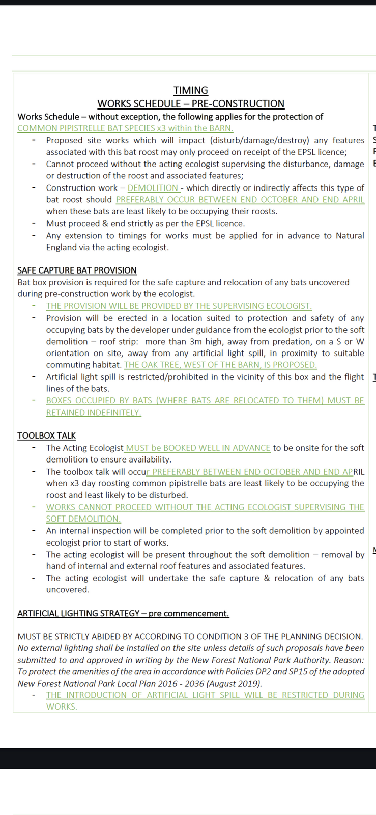

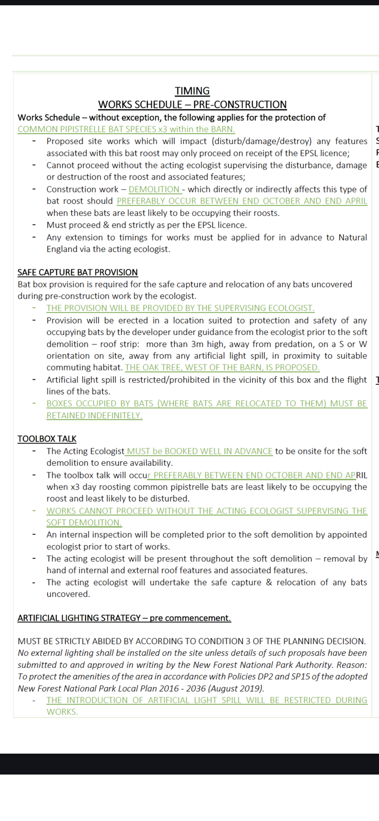

Fyi of a typical do as you are told spec
