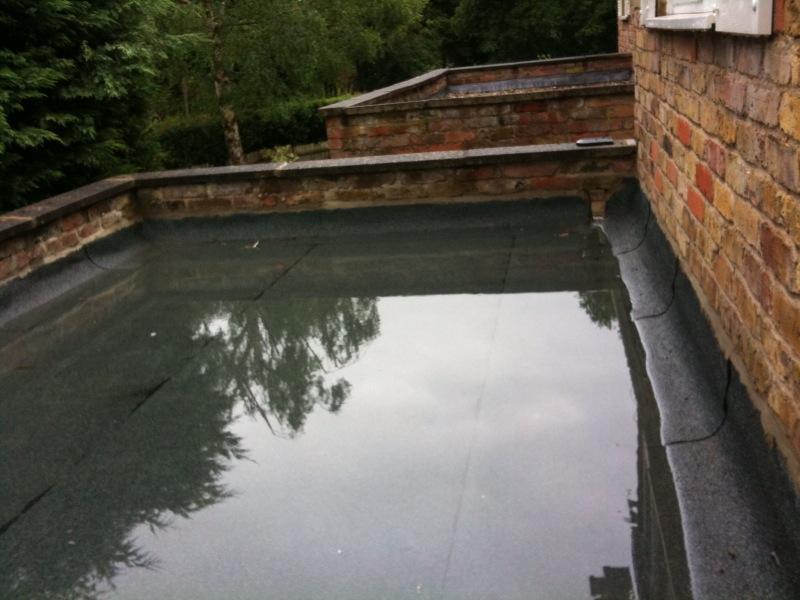

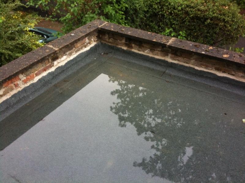

Images of the roof, looking at them again, there doesn't seem to be sagging, more that the roof is completely flat (will check tonight and upload an unflooded roof picture / as well as one with a bucket or two of water thrown on to see if it settles in the middle of the roof or evenly across).
As the roofer has only replaced the felt and not the roof structure, this would suggest that the pooling problem has been there for years. I can't say that I think your roofer is at fault here, if all he has done is replace the felt.
I agree with part of that answer. The pooling problem may have been there for years, it most probably was! But I would say most professional roofers on here would have checked it before starting work and advised that a new deck was laid with a slope to the outlet gulley. Or am I being too optimistic. It looks more like a paddling pool than a flat roof! It will leak again as soon as the felt lifts or finds a weak point near the outlet.
Emma, Can I hazard a figure that it cost over £1000 to lay the felt? Was it professional outfit or someone who cold called you? Were you advised it was pooling or did you tell them it was? What brought about doing the job? Suggest you get a surveyor in quick to give you a report in writing.
Looks more like a swimming pool than a paddling pool !!
As said before though, I don't think the roofer is at fault. If you asked him to replace the felt, then he has done just that. Must admit there's a lot more pooling than your original post suggests.

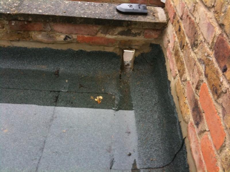

So before you poured copious amounts of water onto it did it just pool in the middle or one spot in particular or evenly? It looks like where the outlet is the felt is too thick and is impinging flow. Did you check with a level whether it is level or any fall at all yet? It looks like the coping around the top is level, is this parallel to the roof?
