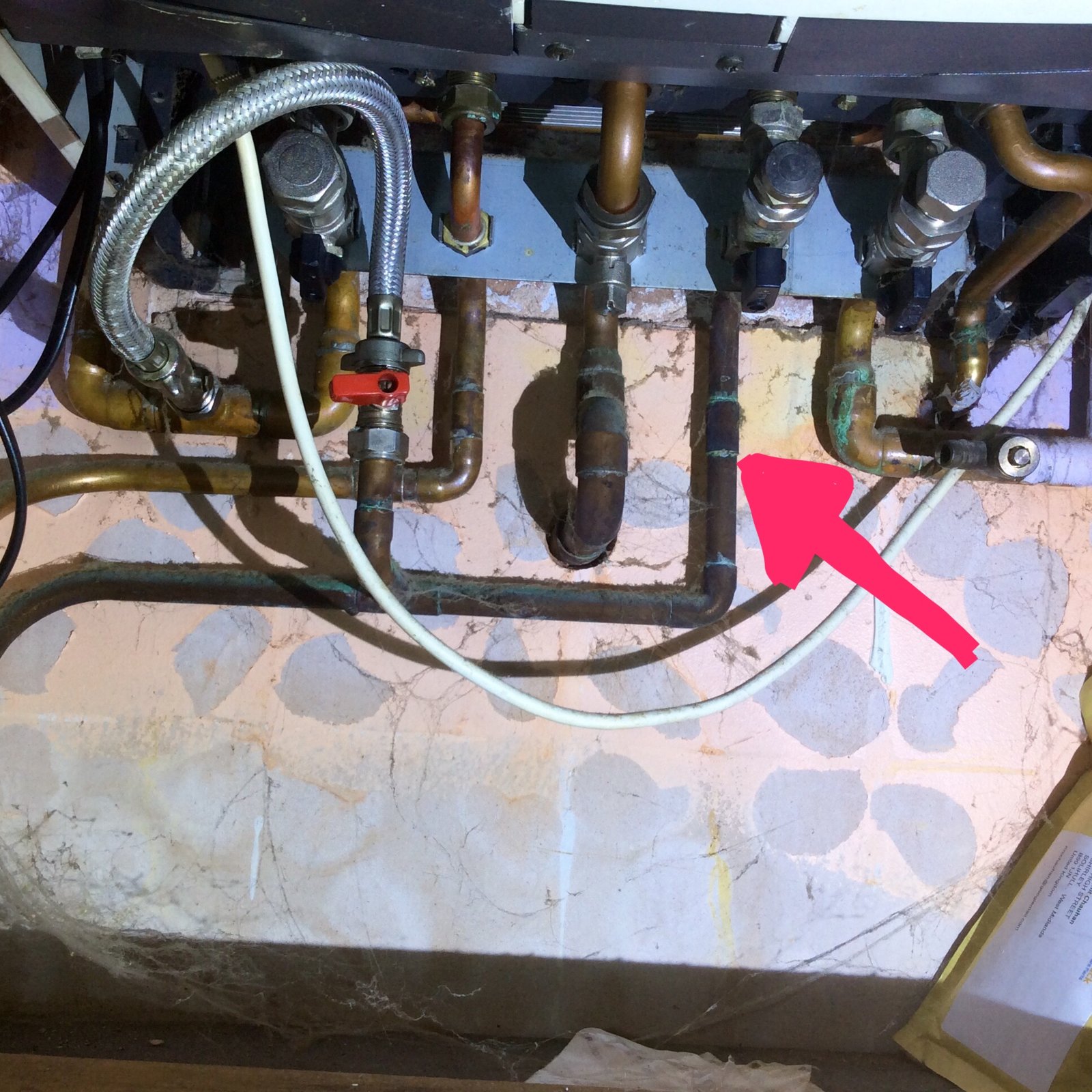

Hi all new to the forum I have had a issue with my Baxi 105e where the pressure is lost out of the boiler during winter when I have the central heating on I have to keep topping up the pressure manually, seems to drop of overnight to 0 so heating and hot water does not operate when requested. And get flashing temp led's .
As some of you may know the vessels are on the back on the 105e and not really accessible, so looking at adding a remote vessel
Anybody done this on the 105e and which pipes do I tap into ?
Any help appreciated.
I have attached a pic of the underside of the boiler.

Yes, that's the one. It's 22mm and leads to the valve with the black handle. Connect anywhere between the filling loop tee and that valve.

Ok so I could simple disconnect the filling loop fit a t piece in between and run a pipe off the T piece to a remote vessel and that's it?

You could do it like that, but I would fit a 22mm tee between the existing tee and elbow, and then connect new vessel. Before that I would make an effort to check the existing vessel. Unless it's boxed in, access is not that hard. Your choice.
It looks from your picture that your filling loop is connected into the flow pipe from the mains pipe (the pipe with the red valve on). The c/h return pipe that you need to connect the remote vessel to is out of shot.

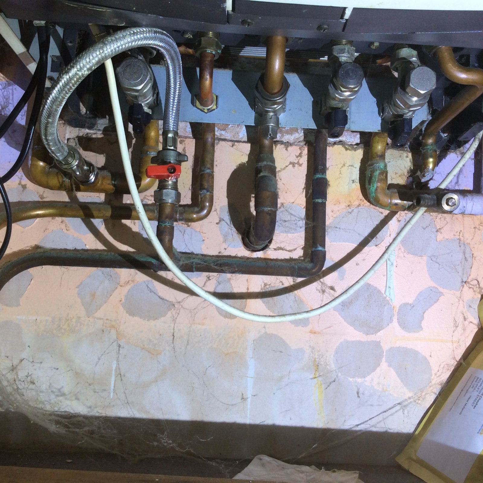

So looking at the small pipe which goes to the vessel it connects to the brass PRV and this pipe I have arrowed also comes off the PRV which is going to the filling loop.

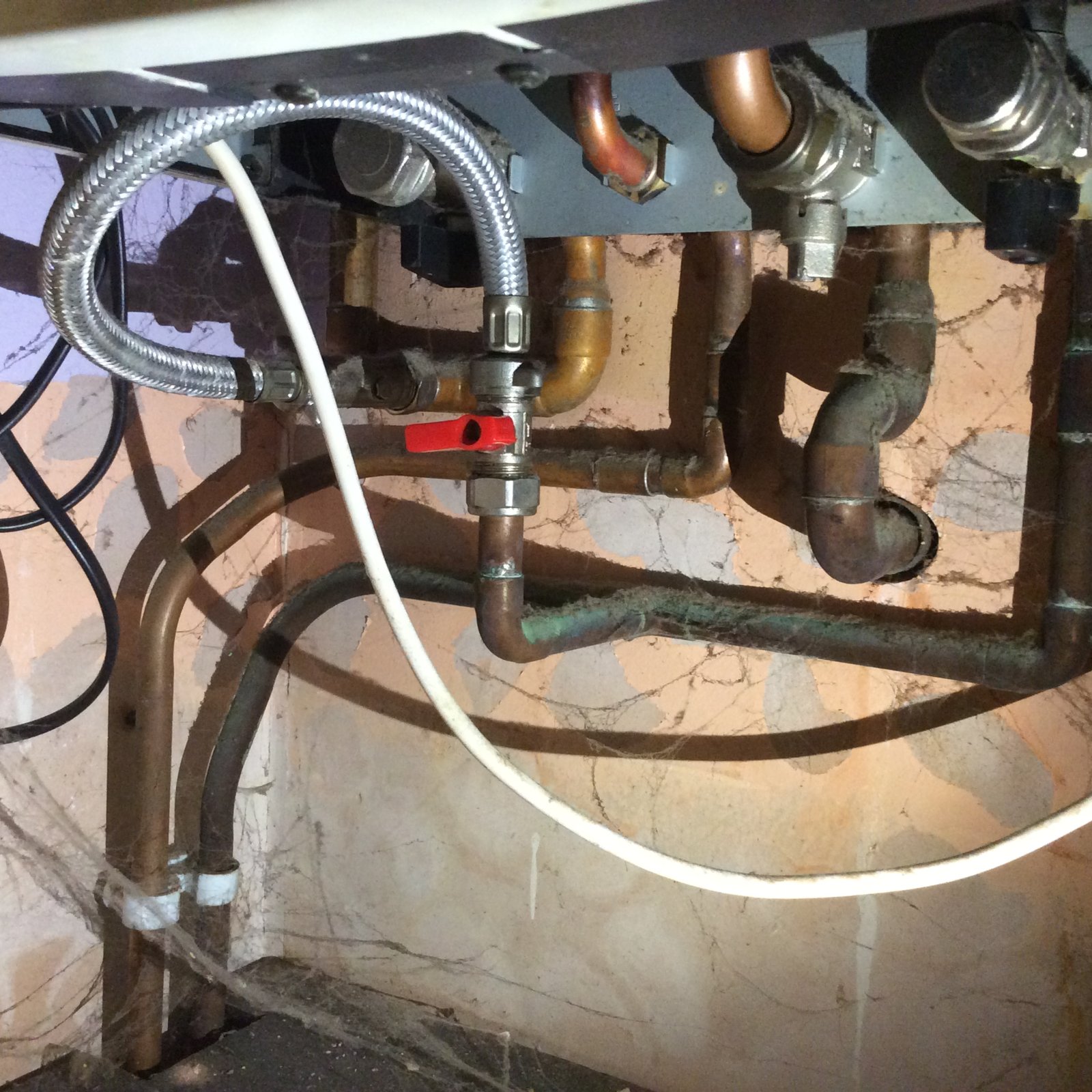

I have added another better pic of the under side if it helps.

That vessel appears to be goosed then, although that could be condensation. No harm in re-pressurising it and see if the bladder is intact. Don't connect a new vessel where your red arrow is!:eek: The pipe to the RHS is the ch return (the one with the drain off on). Connect it into there if you need it.
