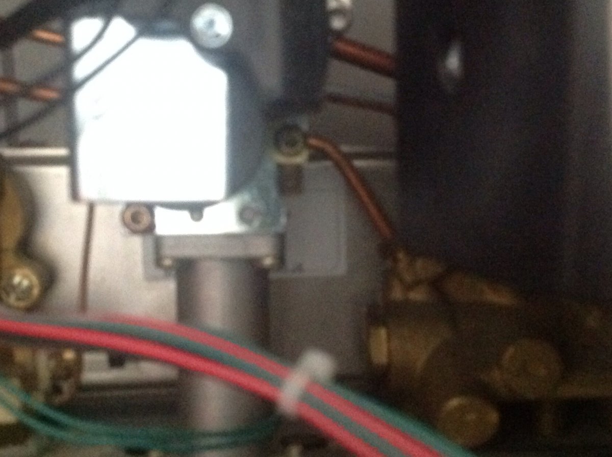

Hi all i got a new venturi ass got the boiler cover off on the diagram is it the 23mm nut thats hard to get to lol where the venturi sits
yep use a 24mm ring spanner just turn cold off no need to drain it then get your finger or lump of blue tac into hole and pull out any broken bits left in there
