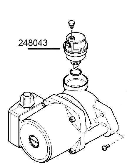

My question is:- on top of the boiler pump there is a small air/vent screw? is it supposed to be left open? if so, how far open i.e. 1 turn; 2 turns? or is it supposed to be screwed in?
At the moment it's about 1.5 turns open and there is a small amount of water coming from it...

Leave it open so it can automatically vent your boiler if needs be,just leave the cap loose,if you vent your rads then when you fill the system up this needs to be open or your system will start banging and cutting out
oh its leaking i didnt read all of it ,its knackered if its alot of water ,shut it up and get it replaced

Thanks for the replies Zimmers - it's just a drip, not a lot of water.
I have re-charged the pressure vessel and put water back into the system (1 bar) and after 3/4 hours I checked and noticed the small drip (not constant_ and traced it to that screw on the pump.

It might be losing more water than you think, because it's hot and most of it evaporates.
Not a big deal to renew it.

it is an aav, you need to replace the inside of it as it will keep leaking
This part:

The pump om my boiler is a GRUNDFOS Type UP 15-60 AO and the serial number is :- S/N 59926502.
I take it the AAV in ChrisR's picture is the one suitable for my pump? (just to be sure)
Also, what do you use to unscrew it as it's round(ish)? Will it turn by hand or will I need a special tool?
I wouldn't go to all that bleedin effort to show you the wrong part :wink:
