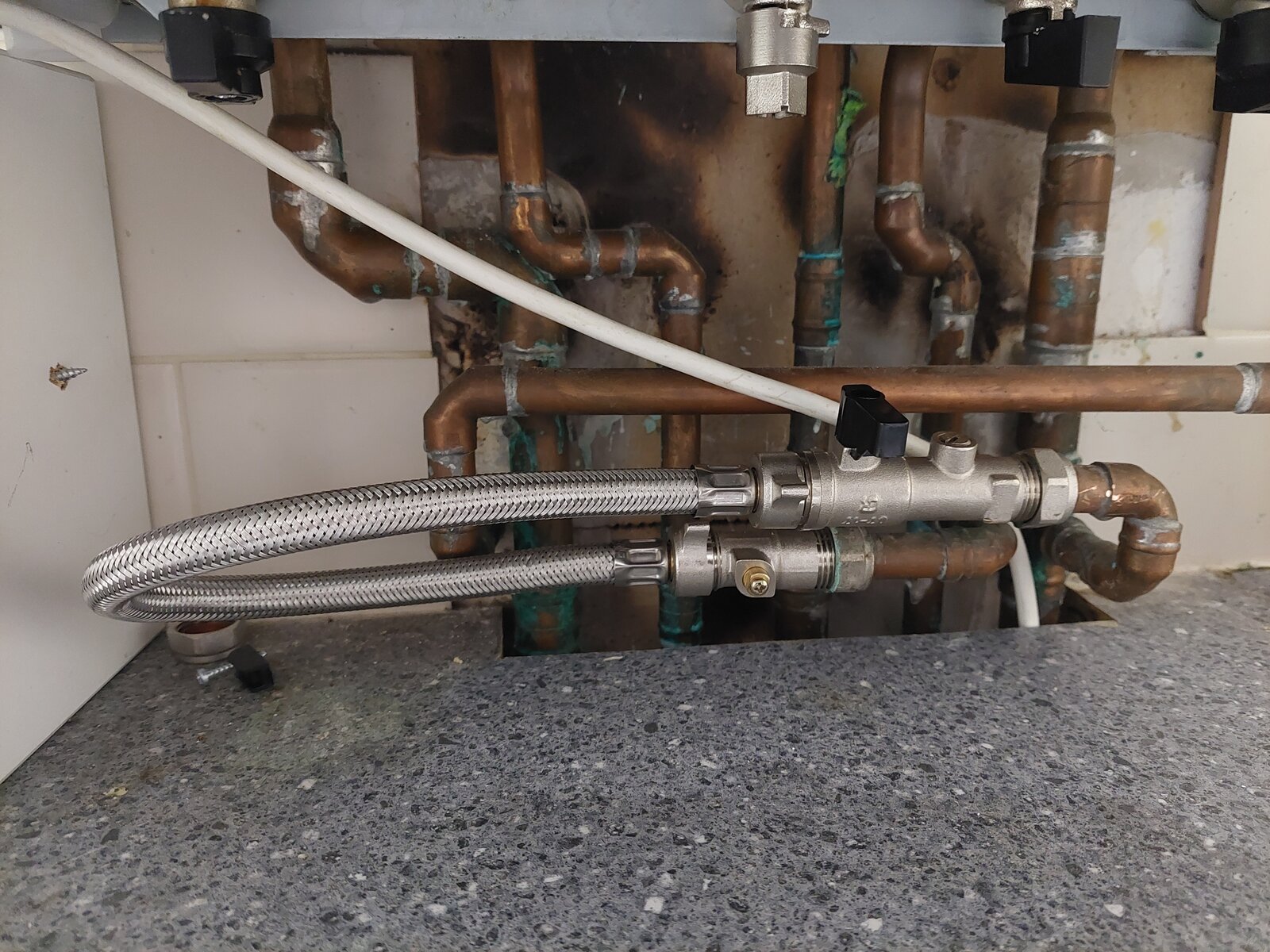

My baxi boiler is showing the error code E119 and the pressure is around 0.5. I've exhausted the online resources for repressurising the boiler but the filling loop on my boiler only has 1 valve and all of the guidance online refers to 2 valves. I've tried opening the valve but that is doing nothing. There are various other suggestions online and I have tried those too but not having any luck. Any advice is welcome!
you have 2 valves , but the plastic handle is snapped off the bottom one you will have to use grips or an adjustable spanner to open it
Oh my goodness, it seems so obvious now you have said that!
Problem solved, thank you (y)
