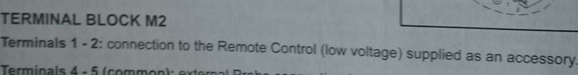

Picture 1 - user manual on thermostat connection

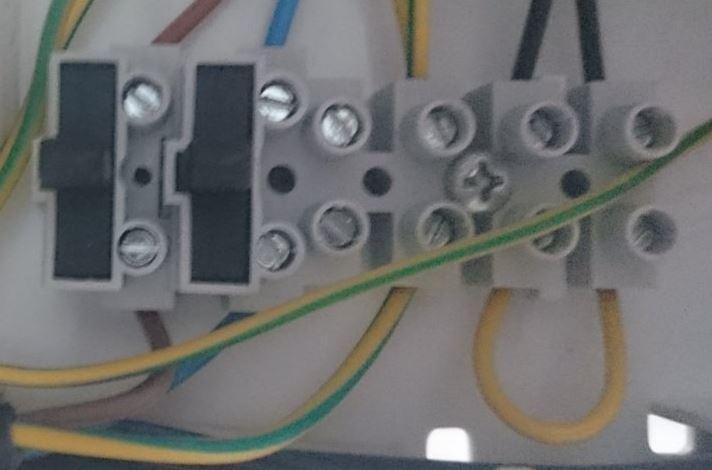

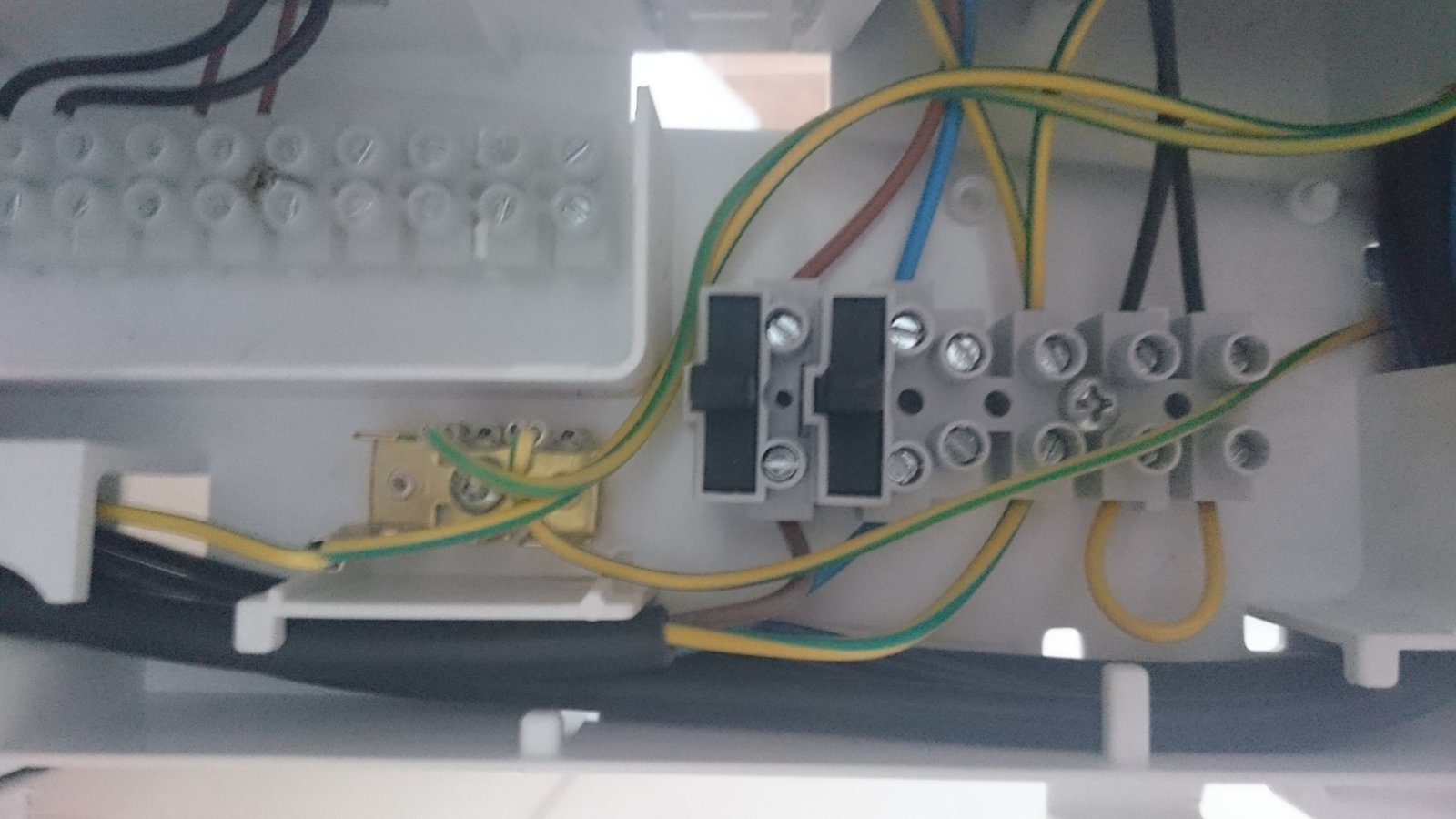

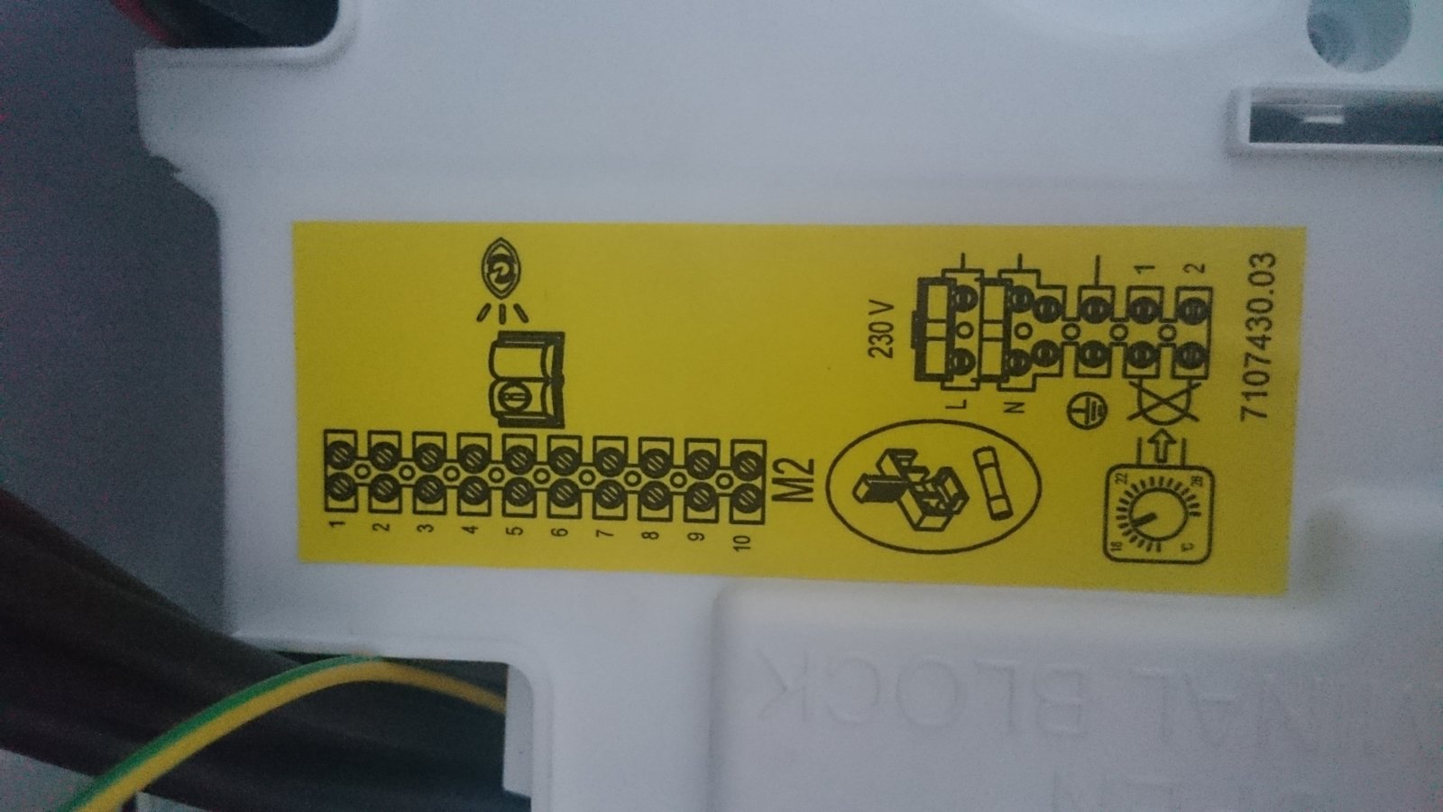

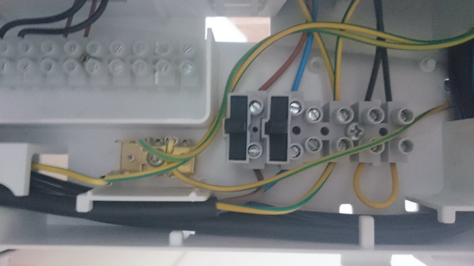

Picture 2 and 3 - the terminal box on my Baxi

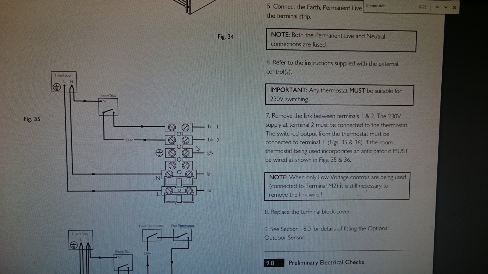

Picture 4 - service manual found on Baxi website
So as I understand, I would need to connect Terminal 1 and 2 to the HeatLink, and here is where I have some questions:
  1. Which terminal should connect to which connection in the HeatLink? Manual that I have, and the one on Baxi website seems to show terminal 1 and 2 in different positions.
  2. As I understand, Heatlink would still need external Live and Neutral wires for power supply, correct? Or could I power it using the L and N terminal in the boiler?

There are different ways of connecting Heatlink's to boilers hence the appearance of what often appears to be contradictory information. Also boiler manufacturers modify their products from time to time, so it's important to use the information supplied with your boiler and not supplied by Google.
If I were adding a Nest to your boiler, I would remove the link between boiler terminals 1 & 2, shown by the 'X'
Then connect these terminals to Heatlink 2 (Heating common) and Heatlink 3 (Heating call for heat). It doesn't matter which way around they go, it's just a switch. Under no circumstances add any additional wires to any of these terminals. They are "low voltage" and would not appreciate being connected to the 230V mains.
Then add a permanent N, L & E mains Supply to the Heatlink to provide it with power. This should be connected to the same 3A supply as your boiler, so that the same switch isolates the Nest and the Boiler.

The snip that you give is referencing to the Terminal Block M2, where some proprietary Baxi remote control could be connected, while the thermostat should be connected to the block M1, and that is rated 230v. But if it doesn't really matter, then I guess all good. And I did see some similar topics with very similar boilers and pretty much exactly the same terminal blocks, where everything was working fine.
As for the stranded wires, Nest website states that it will not work with high OR low voltage systems with stranded wires. Over here. But I guess it only refers to the Nest itself.

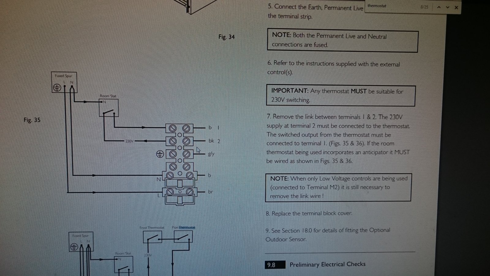

Regarding the connections, if these are the terminals 1 & 2 that you are referring to, in the bottom right in the diagram:

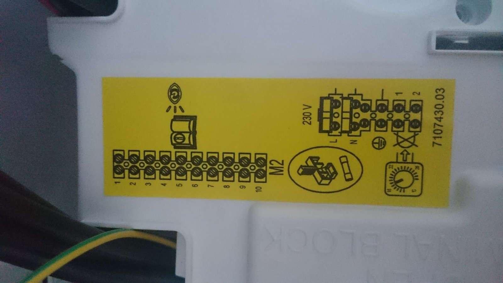

and they are the same as in this photo with the yellow link:
then I believe that's fine, and it can be wired as we have been discussing. The terminals to the left can provide you with the 230V for the power supply to the Heatlink.

"Stranded wires may indicate that your heating and cooling system uses high voltage (line voltage). The Nest Thermostat is not compatible with high voltage systems OR with low voltage system that use stranded wires."
Here we can use the switching terminals 2 & 3 with 24v or 230V as they are voltage free. Probably best to get it checked out locally just to make sure.
So I did some more digging, and it seems that the stranded wire and low voltage requirement is only for US, as they do not use the Heatlink. The Nest manual that I linked to was not local, it's for US, so my bad, sorry for that. And I will be purchasing UK version in any case, so I do think it will be fine. Thank you for your help again
