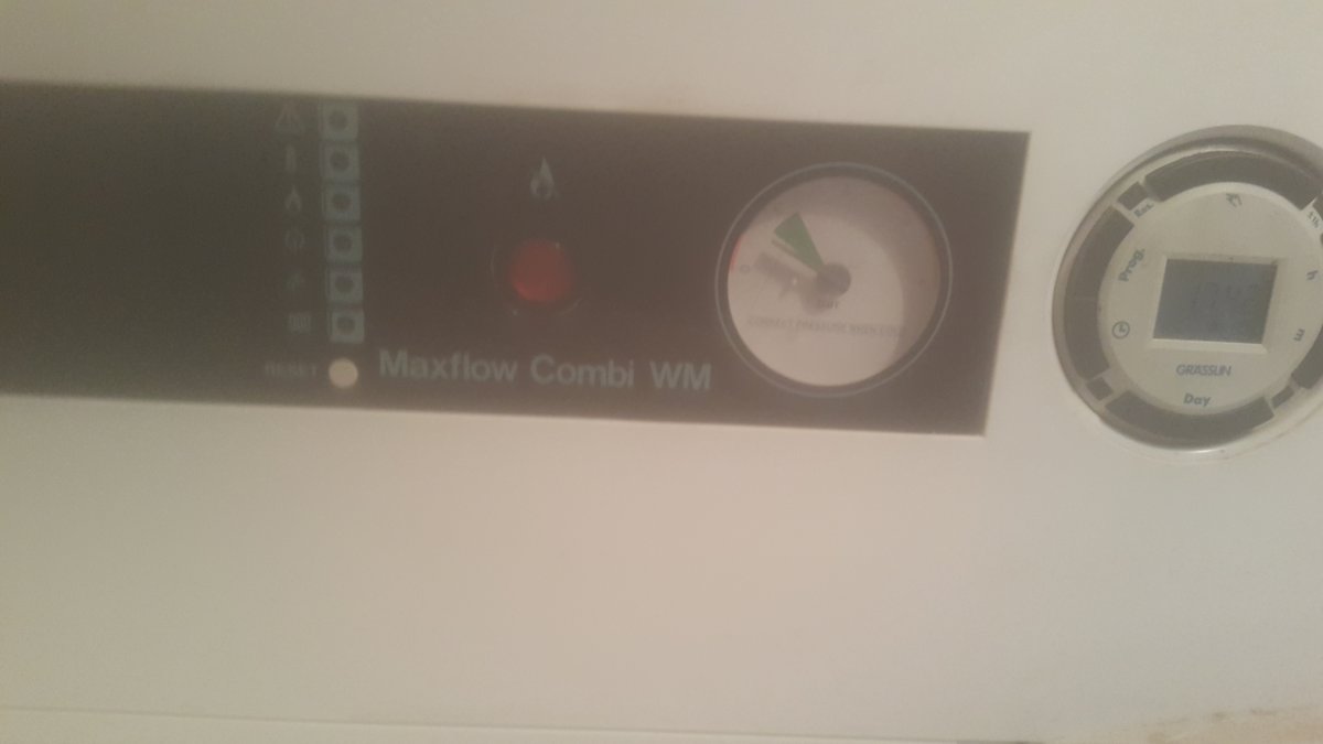

Boiler went off last night. Fuse supplying seems OK, clock working but no lights on the main panel not even a red as not working. Completely dead and not responding. At least it's a bit warmer!
Here's a view of the panel. pressure a little under bur OK
There's also a fuse at one end of the boiler mains wiring connector which is inside the lower section of the front panel. See page 22 of the installation manual.
jackthom you are a star!!!! I looked for an internal fuse but couldn't see, of course the manual pointed me straight there. Down to the local DIY shop £1.30 for 2 x 1amp fuses works a dream.
Thank you and have GREAT weekend :)
