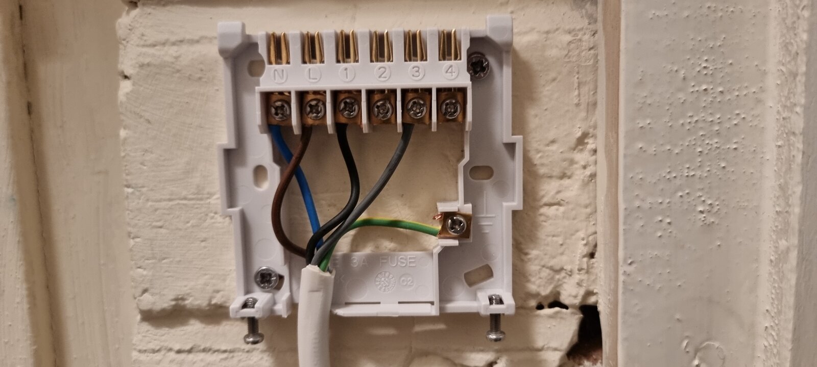

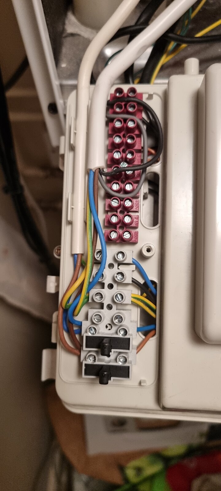

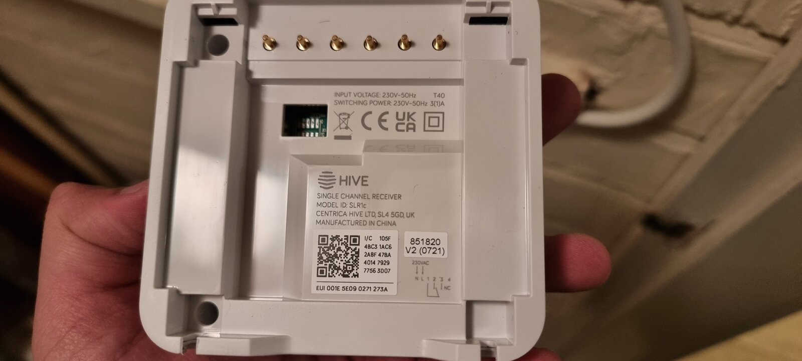

I have a Baxi neta 28 with a hive wired in.
Can I just get a double check on my wiring if possible please.

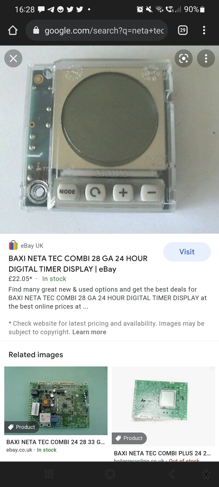

It has the clock below fitted in, do I need to remove this clock?
Thank you

Hi,
Only a DIY'er, I'm sure you will get some pro advice soon!
The wiring looks ok to me, can your existing clock be set to 'always on'?
Edit:

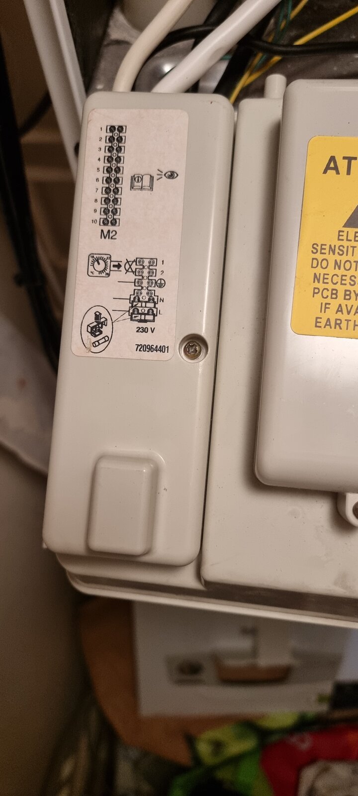

Sorry, I'm wrong. I think your thermostat black and grey wires should connect to terminals 1 and 2 on the large grey terminal block in the boiler?
Terminals 1 and 2 on terminal block M2, are for connecting Baxi's own wired and wireless controllers - providing both power and signalling to the controller.
