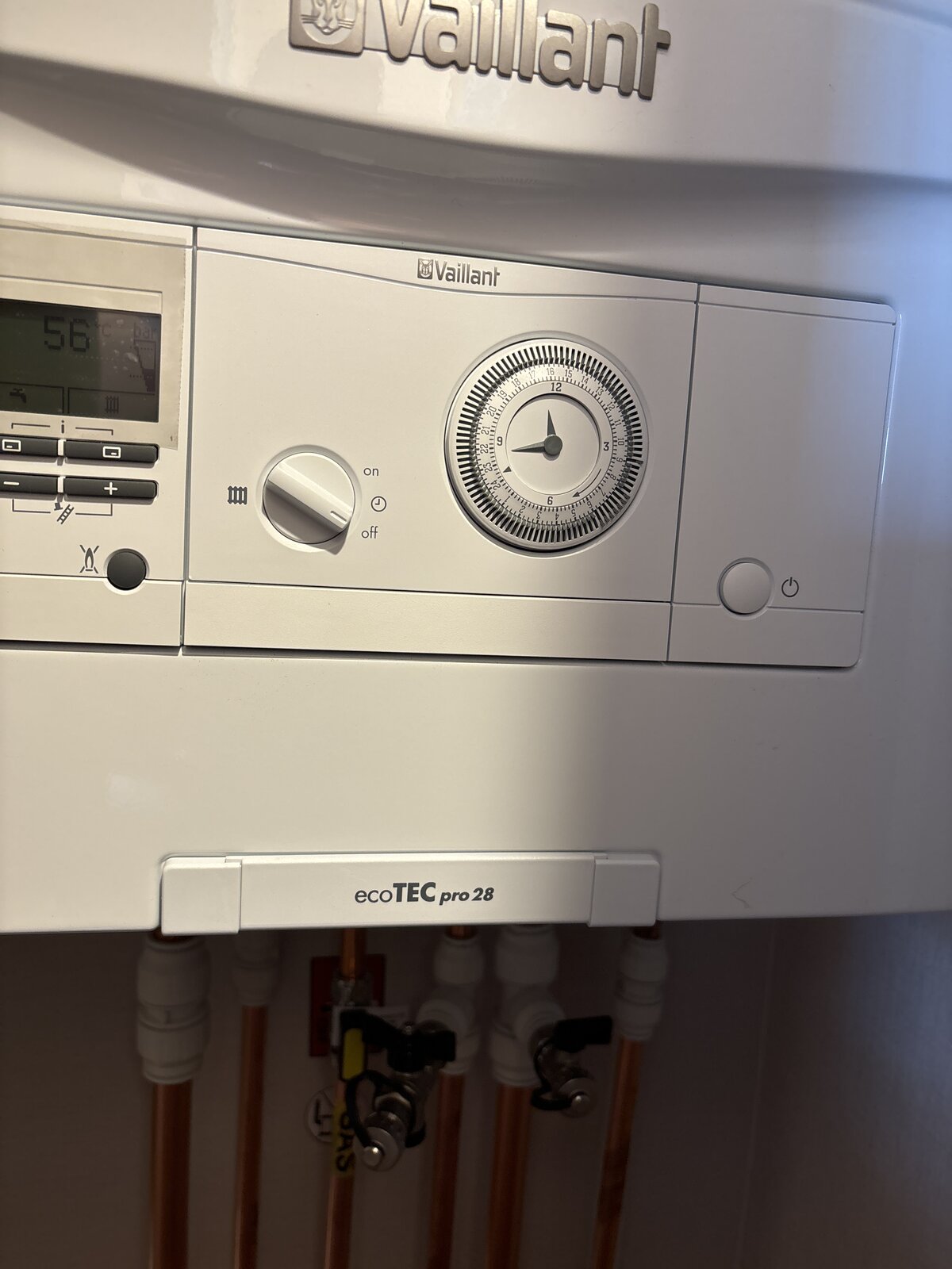

Hi all,
Just got a new caravan with a new boiler in.. Ecotec Pro 28, they have installed a time clock in it, but I want a thermostat.
Easy enough to change to Hive? Take the time clock out, fit a blank and wire in the Hive receiver?
TIA
What time clock is fitted to the boiler? Also, removing the cover on that particular boiler forms part of the combustion circuit, so needs to be checked for safety afterwards.
Picture attached.. if it helps
Yep, that can’t just be unplugged and “wires” utilised as it plugs in and uses pins. To use Hive with that just wants the Hive wiring in and set the time clock to permanently on, bearing in mind what I said about removing the cover.
