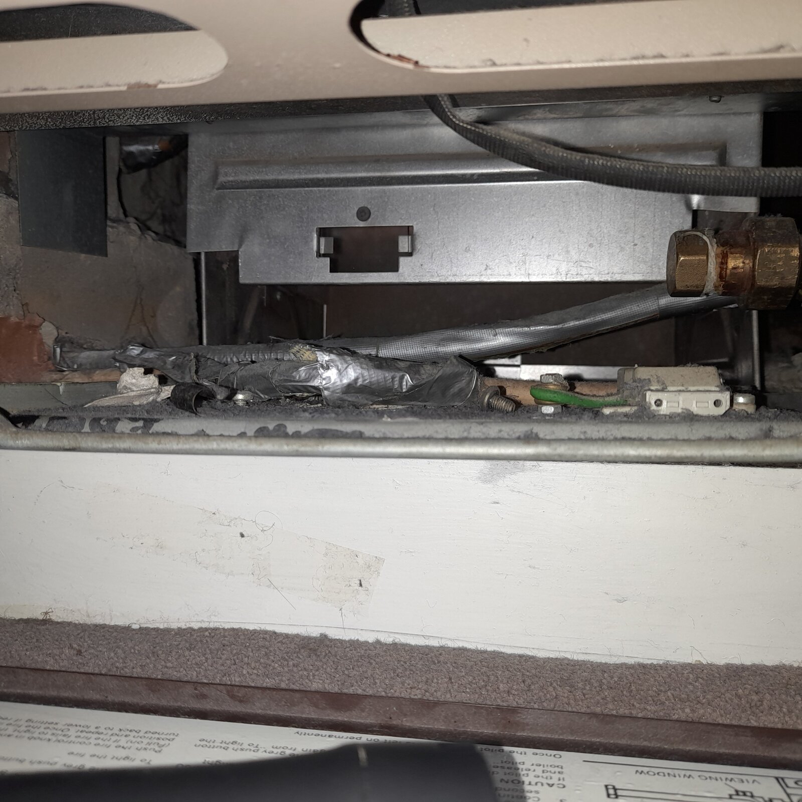

The fire you have is very very reliable, needs very little servicing, unfortunately Aberdeen has a real problem getting Gas Engineers and the ones they do have tend to be of poor quality, as you are in a private let , you are at the bequest of your landlord, I know a good guy in your area , but quite rightfully, he wouldnt touch it without your landlords or letting agents request, it is not your fire it is theirs, did you do as previously asked and remove the lower panel of the fire ? it just pullsoff, only two simple clips, do that and take a pic of what is in there and post it on here

I f your fire was origionally fitted as fire only, which is possible then it will be fine, and doubt if you need a chimney sweep, if it was fitted with a BBU , then sorry it will have to be de-commisioned properly, looking below when you remove the panel I described will let us know, if it does have a BBU would love to see anyone sweep that chimney :LOL: sadly you have been caught up with the industry problem of short course under trained so called engineer who think they know it all, a spillage test at this time is pointless, till we know if you have a bbu or not
Photo with bottom panel off.

Looks like a bbu behind imo. Plus the visible blanking cap. Ian or 112 should be able to confirm this.
you do indeed have a BBU , but if it has been de-commissioned properly, which it looks like it has then you can indeed keep your gas fire as long as it is serviced and passes the spillage test
that is not a proper gas fitting capping the 3 way tap its a brass one used on water i would take the off and use a black iron one on it
