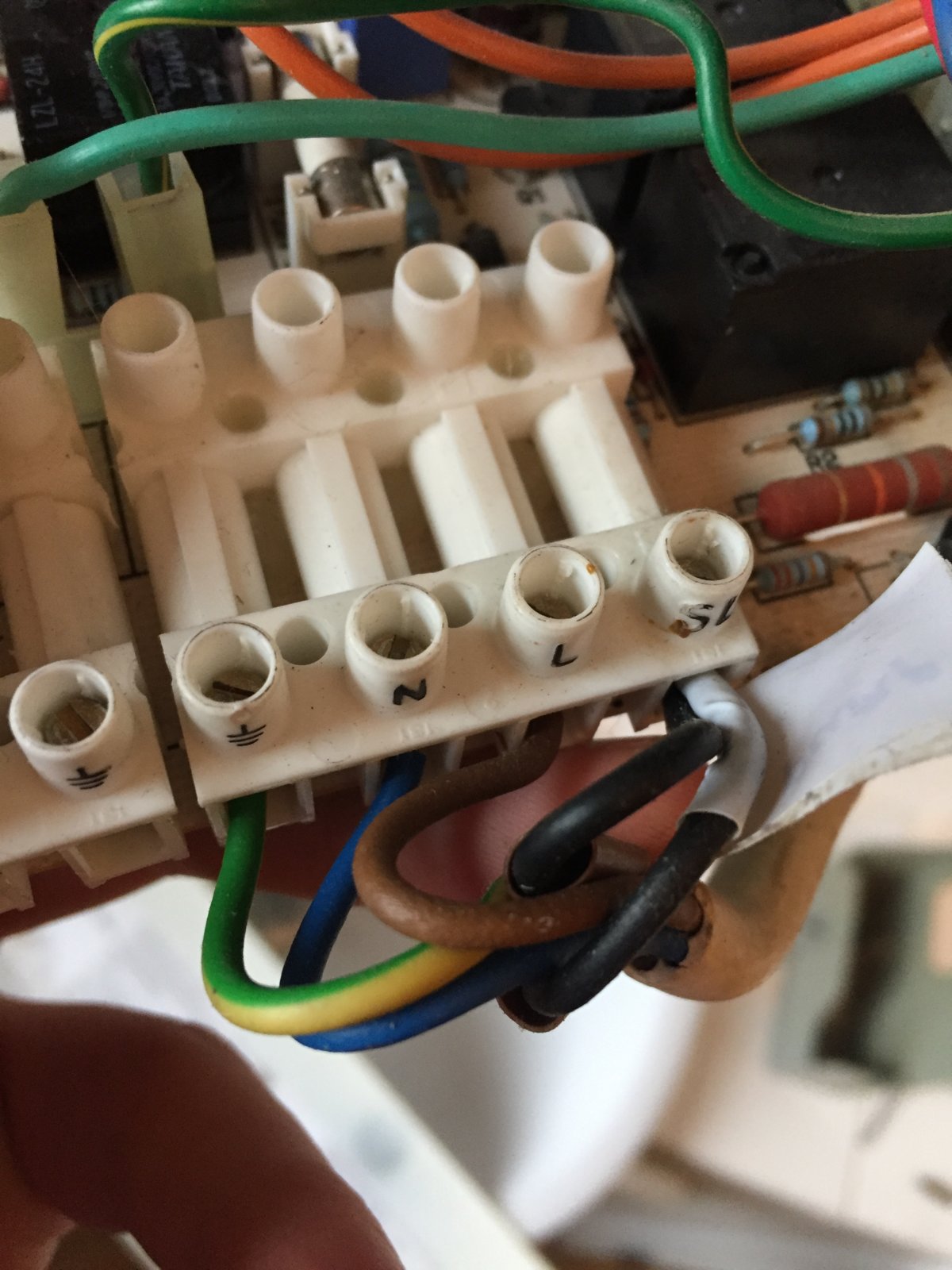

Hi,
My first post on the forum, hoping for some help! I have a Baxi Solo 3 PFL 70 that recently has started overheating regularly. When I say regularly, it tends to happen once or twice a day.
I've replaced the overheat stat and the PCB recently but the problem persists. One perhaps quite significant thing to note is that I had a Hive system installed recently. I didn't install the system myself, but from observation can see that the system is set up so that when the desired temp has been reached it cuts the power to the boiler.
My understanding is that the boiler pump is supposed to overrun to carry on circulating after it stops heating so that it doesn't overheat. My question is, with this Hive system cutting power completely to the boiler, does it prevent the boiler being able to carry on running the pump to prevent overheating? Is this the normal setup for this kind of system. It should be noted it was installed by a qualified electrician.

The system is currently wired incorrectly, the hive control must not completely turn off the boiler and all it's ancilliary controls as you rightly suspect.
The main pcb board has two connections marked S/L and L, these are for the *external controls* such as clock/programmer/roomstat, these terminals are which the hive system need to interact with.
A permanent live to boiler 'L' terminal, a switched live to the boiler 'S/L' terminal.

Thanks for the response, it's good to have my suspicions confirmed. I've had a look at the installation manual here and can see that the pump electrical connections that should provide the permanent live. It looks like when the boiler was originally installed the engineer didn't install the electrical system properly. There's only a single power source coming in through what should be the switched live. Here's a picture from when I changed the PCB.

I've had a better look at the whole system today as I've not taken the time before to do so. I can see in the cupboard where the Hive wiring has been installed, there is an auxiliary pump which explains why the boiler pump wasn't wired in. Checking the pump when the CH is turned on/off I can hear the pump does too (immediately).
So it looks like there should be a pump overrun timer fitted to the system so the Hive doesn't turn the pump off with the boiler. Would this be correct? Is this a typical setup?
Obviously the pump overrun (8 min timer) is supervised by the pcb, there should only be one pump connected and must be on the flow pipe from the boiler. I cannot comment on why any other/extra pumps are fitted without being there and seeing how it is connected.
Why is the boiler pump not connected, if it was it would continue running for a timed period when the "external controls" loop was turned off.

The Solo 3 doesn't have a pump mounted inside it. As MrTherm says there should normally only be one pump which with the Solo 3 will be external to the boiler and supply both the radiators and the hot water cylinder. That pump (unless you do have a thermal store with separate pump control circuitry which can provide a pump overrun facility) should be connected to the three pump terminals shown on the left below. These terminals remain powered by the PCB for about 8 minutes after the boiler goes off to keep the pump running to dissipate residual heat and prevent the overheat tripping.
The switched live shown on the far right is what the Hive should be switching.
The permanent live, next to be 'permanent' and not switched to provide the live supply to keep the pump running once the external controls have switched off the 'switched live'.

Certainly seems to be the case here. So after a lot of cable following, I found the boiler does have a permanent live, and the hive is providing the SL as you'd expect. From the first pic I posted you can see 2 cables going into the SL. So it turns out the second cable is the live for the pump (why it was put into the SL I don't know). I've put the pump live into the correct pump live on the PCB, tried the system, pump starts when the boiler goes on, and carries on after it's turned of by the hive - great! This suggests the wiring was changed when the Hive was installed as it explains why the overheating has only started recently.
