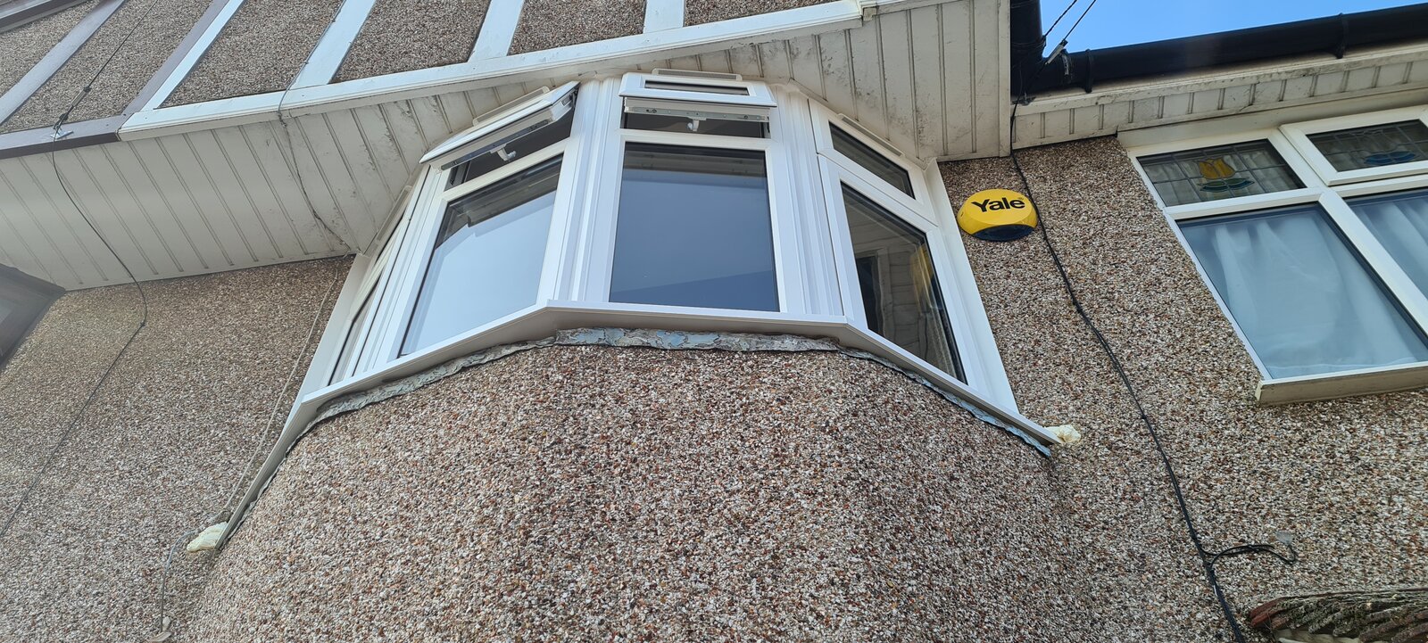

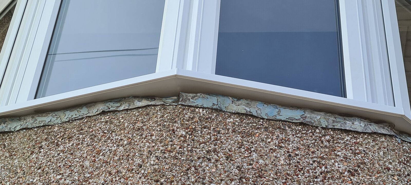

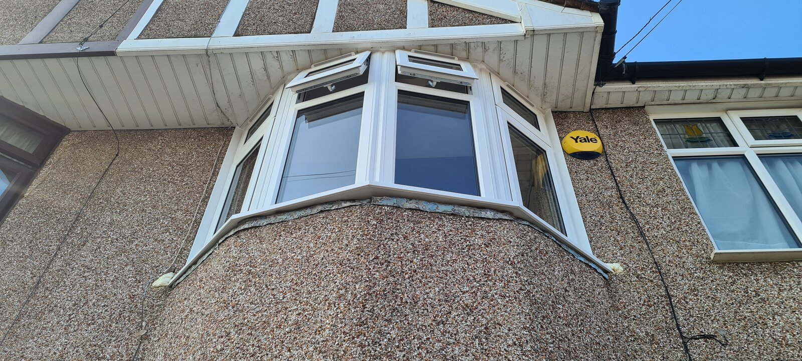

I am currently having my bay window fitted. Not sure if it is just me but it looks a bit off . Please help review the pictures. Also the blue coloured led underneath the window sill what can be done to reinvigorate this. How can I replace this as it looks really battered .Is the double glazing company meant to replace this ? Or should they have removed it entirely?

You can't really "reinvigorate" lead. To get it looking good it should have been replaced before the window was installed. It is presumably meant to act as a sort of DPC/cavity closer. I wouldn't be surprised if there is a similar piece at the top acting as a cavity tray
