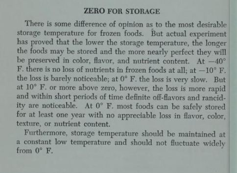

The main reason for going down to -18 is for preserving nutrition and flavour in the long term. Here's an extract from a 1953 book, cited by Wikipedia: (note 0 F = -18 C; 10 F = -12 C.)
Bacteria can survive freezing and thawing, but they really do not multiply at these temperatures.
If you have a habit of keeping things in your freezer for many months, keep it at -18. If you use it primarily for shorter-term storage, I think -15 would be fine.
