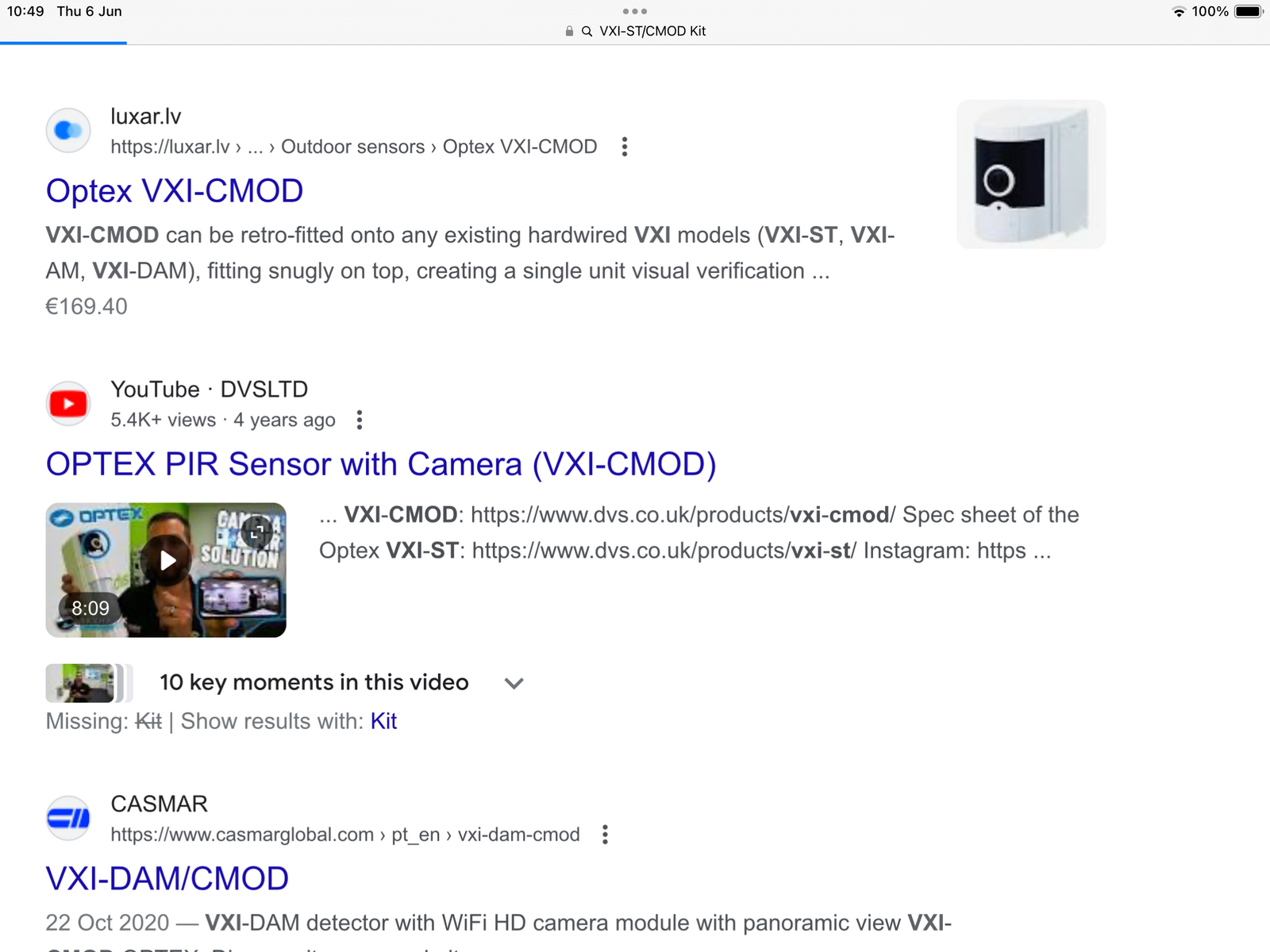

Have a look at this ….i did look at these a few years ago , I have the older VX402 across my drive , it’s set every night and it’s never activated unless some unwanted scroat has come up my drive ….
If the beam is triggered, you're going to want to know what it is.
Maybe a camera with motion detection to start recording and issue an alert?
I got one when we had a neighbour who sadly got dementia and used to roam about uprooting things.
Some wifi security cameras, include a facility to trigger a warning message, plus recording a short video when trigered - maybe worth looking at?
