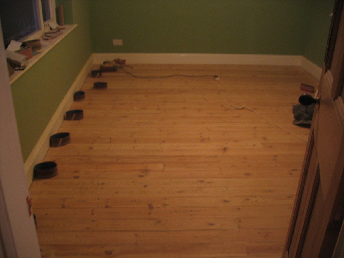

Bedroom floor - boards, my plan
Pretty much. If there's an area below the floor that you may need to access in future (lighting transformers, air extractor motor or whatever else) make a hatch door? Or don't glue slivers over that area?!
Well the only areas I can think of are near a radiator - so one could access the pipes I guess.
I suppose anywhere near a socket on the wall too potentially? - As I assume there's a junction box below it.
I've sanded floors with a belt sander - obviously it takes longer than a floor sander, and you're working on your knees, but you have more control.
If the floor is already varnished, are you sure it hasn't been sanded before? If it has, you might want to go at it less aggressively, which is another vote for a belt sander. I wouldn't use an edge or orbital sander as it will take forever.

By belt sander I'm guessing you mean the ones which are of similar size to an orbital but just with a continually rotating belt? - I'm guessing I'd hire rather than purchase?
It's varnished (but looks a bit horrible!) so it may have been sanded before, it's not very smooth so at any rate the varnish needs to be removed.
The additional control is tempting, however, a 3x4m room, with a belt sander, on my knees, is that likely to take forever and a day? Obviously it'll take longer than a floor sander but I'm just not sure how long at the moment!
I've done several floors of that kind of size - I can't remember how long it took, but certainly not forever and a day. Personally I'd buy one (well, I've got one), as they're extremely useful.

On one hand the floor sander thing seems like the obvious choice to zip through it quickly, however, I'm wondering if it's as quick or as easy as I think? I reckon once I actually start doing it that it'll be obviously much quicker but the whole hiring it picking it up (getting it up stairs?!) and learning how to use it... hmm.
Using an orbital with p40 and some pressure I could get the boards to 'clean' in about 30 seconds for a patch about 15cm long...

Chillibob, it's up to you, but if you're just doing one floor I'd suggest a belt sander. From memory I went along 2 or 3 boards at a time, along the boards but with the sander at right angles, with a 80 grit belt, to take the top off and level the floor, then the same with the sander parallel to the boards to remove the marks from the first sanding, then again with 100 grit, then 120 grit and job done.
Also try to keep the sander moving, to avoid creating pits and ridges. Obviously this is a much greater risk with a professional floor sander, as you can stop to mop your brow and end up in the room below ;)
