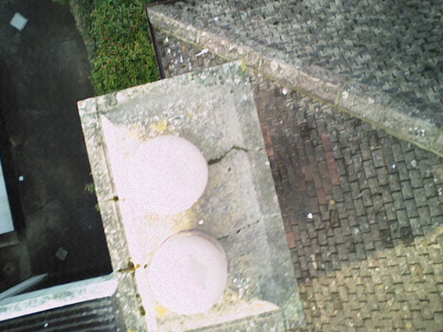

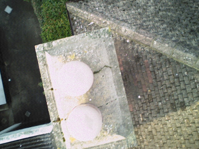

Hi, resurrecting this thread. We got a photo taken of the capping. Would you think that the lines shown are cracks and would water be getting through and cause a problem in the room?

Your stack is capped with a concrete flag, and on top is sand and cement mortar flaunching.
Yes, the flaunching and the flag show cracks - water will penetrate.
However, I suspect that you have damp difficulties from a number of causes.
What's the condition of the other stack area?
