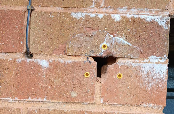

I repaired the worst of the damage by gluing the bits of brick back on with NMN - it isn't structural, and will mostly be covered by the little camera anyway.

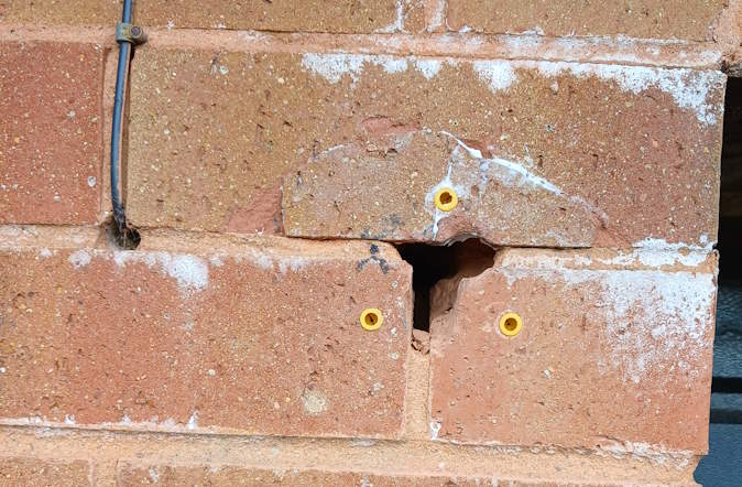

Well played. BTW the cable to the left should have run down past the entry hole and then looped back up so that rain water didn't track down the cable. I guess that the hole has been siliconed and not causing any problems, so perhaps ignore it.
Best of luck.
Best of luck.
Oh right? It's the phone cable I think, been here for 30 or so years since the house was built! But when I'm putting the wee camera up I'll be lashing the silicone around liberally, so will have a look (y)
