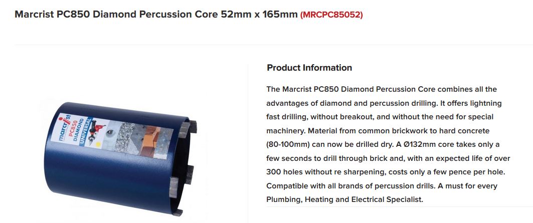

Not them all,
That looks like it's intended for a percussion drill, wouldn't like to use it on an sds hammer drill
Blup
You can still get TCT core drills which are intended to be used on an SDS - AFAIK they originated back in the days of the original massive, heavy Kango rotary drill/breakers (the pre-Milwaukee ones that you needed muscles like Garth to even lift, let alone use). Of course if you forget yourself and drill all the way through, rather than drilling from both sides, the blow-out as they exit the hole is awesome (and awful, for that matter)
