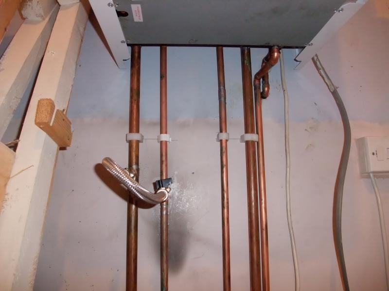

Do Halsteads have a different pipe layout to most other manufacturers?
If not it looks as though the filling loop is connected to the HW outlet :shock:
Thanks gremlin16 and gas4you - didn't understand what either of you said but I guess it's not good from the emoticons!
When you run a hot tap, does the 15mm pipe that the filling loop is connected to get hot?
Just tried it - yes the left hand pipe does get hot (at the top, by the boiler above the filling loop - much less warm lower down).
Is that bad, then?

This is not a condensing boiler and he is not CORGI registered.
The boiler has been fitted without a properly sized gas pipe.
Whilst its neat and tidy its just not the right type of boiler and there are several smaller details about how its been done.
I have to say that he should not get paid anything and shoule remove ( his ) boiler and cap off the pipes ready for a proper CORGI.
Take the registration number of his vehicle and do anything you can to check his name and address.
Call CORGI and see if they want to be involved. I think its dreadful that this guy can carry on doing this work so badly for a long time without CORGI stopping him.
This guy should be pleased to comply with your requirements in return for not being reported to CORGI. But he is not going to be happy to say the least. Its totally his own fault and the cowboys who read this forum should take note!

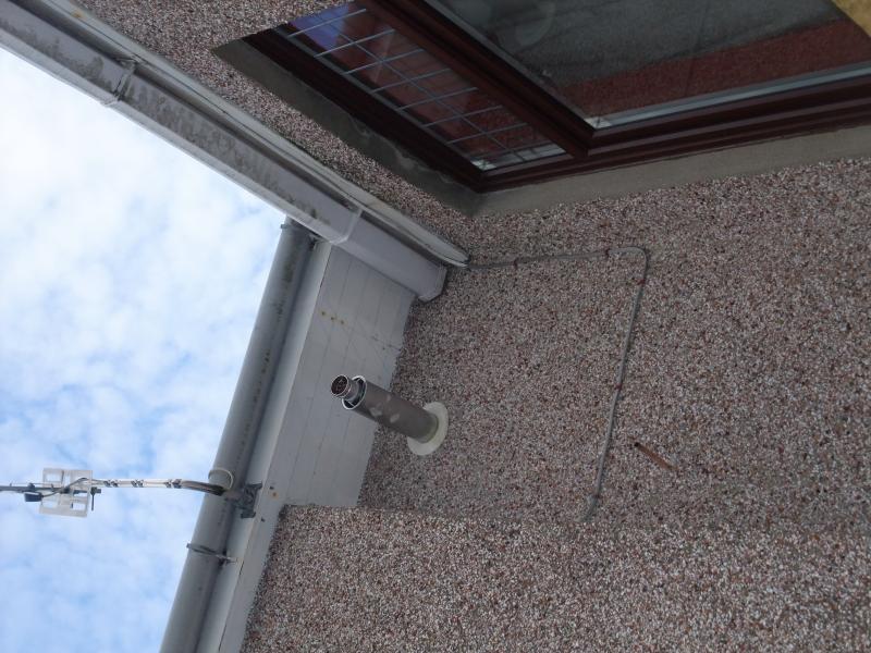

Any chance of getting a picture of the flue terminal position outside?
When he arrives ask to see his corgi card and when he tell's you he's left it at home ask him for this registration number instead.
Sorry the pic is sideways, but I'm as useless at PCs as at employing heating engineers. This is the flue outside. The boiler is upstairs in an airing cupboard in the extension at the back of the house.

1) The left hand 15mm pipe on a Halstead Ace High is the cold inlet and the filling loop is fitted to the right pipes.
2) It isn't clear if a 22mm Gas supply is just out of shot in which case it could well be OK.
3) The thought that a non registered plumber working on gas actually checked the gas working pressures after installation might well be stretching credulity a touch too far.
