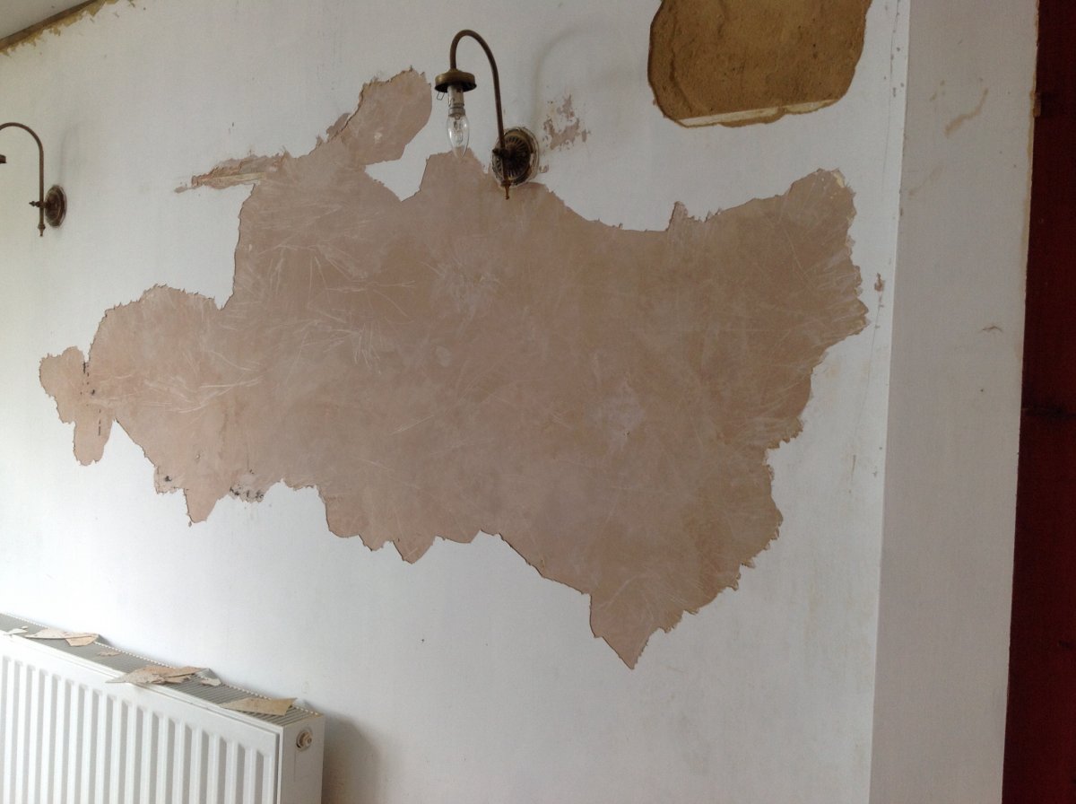

In my conservatory I have had an issue with penetrating damp.
We have found the issue and corrected it ( hopefully)
Now I need to get the walls decorated again.
I noticed a few hollow sounding bits of plaster so took them off and beneath it was what appeared to be solid plaster. Although some bits have black marks ( which I think may be some kind of mound)

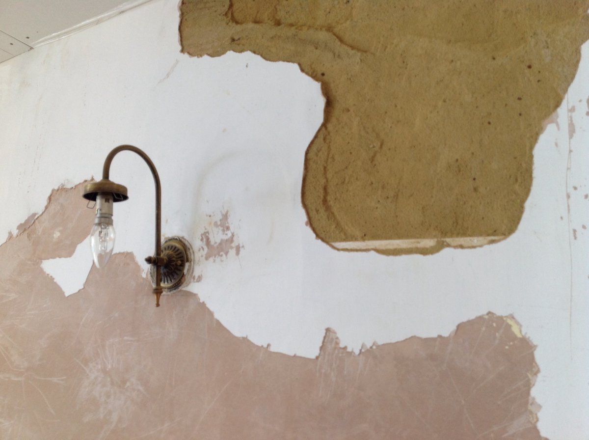

I found one really damaged bit and pulled it off and what can only be described as a waterfall of sand poured out. As I pulled out more and more plaster it revealed that pretty much all the wall behind the "good" plaster is like flaky, crumby sand.
I thought before I pull it all off I should consult the experts.
Do I need to pull it all off and go right back to the brick and get someone to re-do the whole wall or it it much easier than that and there is some way of rescuing it?
i will try to put up a photo in a second post
I think I have uploaded a picture below. You can see the crumby sand like stuff in the top part and the plaster that on the surface looks ok but I think is crumby behind it.
Maybe I should point out that none of the pink plaster sounds hollow when I tap it

If it's as bad looking as you say, i'd remove the whole lot back to brick. Once you start messing about with that old sandy basecoat, you can sometimes open a can of worms. You said you had a penetrating damp problem that "hopefully" has been sorted. By removing all the old stuff, it gives you a chance to look at the old brickwork, and think about whether to re-plaster onto it again, or do what a lot of people do now with old problem walls, and that is to remove all the old plaster, check over the joints in the old stone/brickwork, re-point if neccesary, (some even cover the wall with a membrane) then strap the wall with treated timber, insulate between it, and then plasterboard it with 12.5mm thick, foil backed p/b. Once the wall has been boarded, it would then be taped, and you're then ready for decoration. Whatever you do, I certainly wouldn't plaster onto that old brickwork with Gypsum plaster, (lime plaster maybe), especially knowing you've had an issue with penetrating damp. I'd go for the insulation/plasterboard option, but this is just my opinion, others will have theirs.
What was the original issue?
Is this wall the rear wall of the house?
Is the opening in the wall a doorway?
The elec cable protection seems to be very close to the surface
The sandy base coat is an improper render mix - typically you will have to hack all off back to bare brick, & start plastering or rendering again. Be cautious hacking off around the "mound" & the cable.
Is the house/rear elevation rendered?
The ceiling seems to be badly boarded - is this a DIY job?
