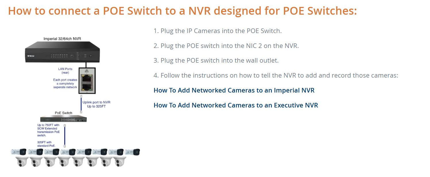

Would the poe cameras not plug directly into the nvr ?

You ask - Would the POE cameras not plug directly into the NVR? Well they could do, but it’s more elegant if you can run all the cameras to one switch if the physical geography allows. - Maybe a PoE NVR would be useful? This question is associated with what route your cables will take. I attach a picture of all the cameras in a setup going to one switch and then from that switch to the NVR. I would start looking at what kit you are considering and what the best physical cabling for it is, given its requirements/spec.
