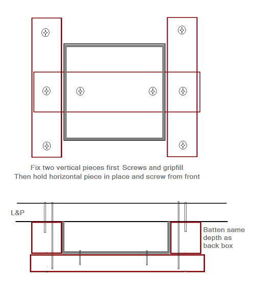

Hi,
As the subject says, I'm looking for thoughts for the best type of boxes for lath and plaster walls. Compared to plasterboard the differences are uneven back surface, quite thick overall, and tendency to crumble around any cut out. Particularly for the last reason I'd rather something that stays put once it's in place, rather than only held secure when the accessory fixing screws are tightened up.
The electricians that did the rewire a few years ago used boxed with screws in each corner, these work OK as long as there's something for the screws to get a grip on at the corner, but rely on a very accurate cut out or there's nothing for the screw to grip.
Suggestions appreciated, Tony S
You will have to make something to which you can fix a metal back box, or
attach (gripfill) two pieces of, say, plywood to the rear sides of the lathe and plaster hole in order to use a plasterboard box.
Thanks. Will have to have a look behind the surface. In the upstairs rooms where there's a void behind I could possibly bridge between stud to make a surface to mount a metal box. That would leave the cut edges of the plaster unsupported though, unless I plastered them into box making it a permanent fit. Maybe the second suggestion would be better, although that would make it very thick.
Find an upright, notch into that 2/3 to one side of double back box.
If your lath and plaster is anything like I have you won't have a flat surface on the backside of the lath to fit the dwangs onto. My method in such circumstances is to fit a wooden 'foundation' block to the stone/brick wall using either screws or gripfill. Once that is secure, fit suitable thickness of filler pieces to suit depth of box, fit box and make good plaster to box edges.
Finding a stud, notching it, and fitting a metal box is the easiest and best way.
A noggin can also be fitted between two studs, again with a metal box, but this will cause a lot of damage.
I've found Appleby dry-line boxes can be bodged about with to fit on a lath and plaster wall, if the hole is neatly cut out, but this is not the best way of doing things.

Down in Devon we have lots of older houses which have lathe and plaster on external walls, often a 2" or 4" batten on the wall, or stood from the wall. Very varying depths from wall front to stone wall behind. In these cases I have found either 47mm, 35mm or 25mm metal boxes fixed to the wall or on battens fixed to the wall in various combinations works well.
