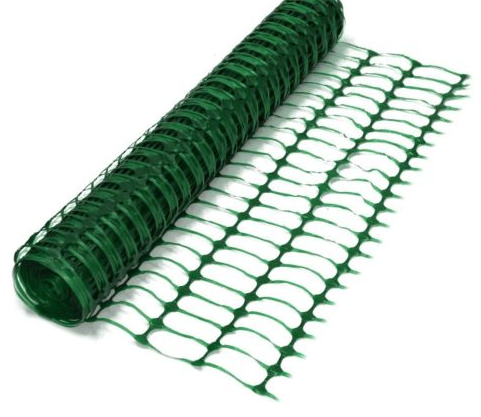

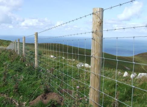

Anyway, my question is… would I be better to use sheep wire (galvanised steel) or plastic mesh? The sheep wire is probably stronger, but will rust in time… the trellis probably not as strong, but theoretically could last forever.
What I don’t want is to spend 10 years growing a magnificent screen, only to see it all collapse…
Thoughts please, from anybody who has actual experience of using these materials long term?
the plastic stuff doesn't last for ever. It degrades in sunlight, goes brittle, cracks and breaks.

Sheep netting, when it does rust which which it shouldn't do for many years, is where the zinc coating has been damaged , usually by banging the staples in too hard..I have netting around a paddock since 1986 and no rust on it.
