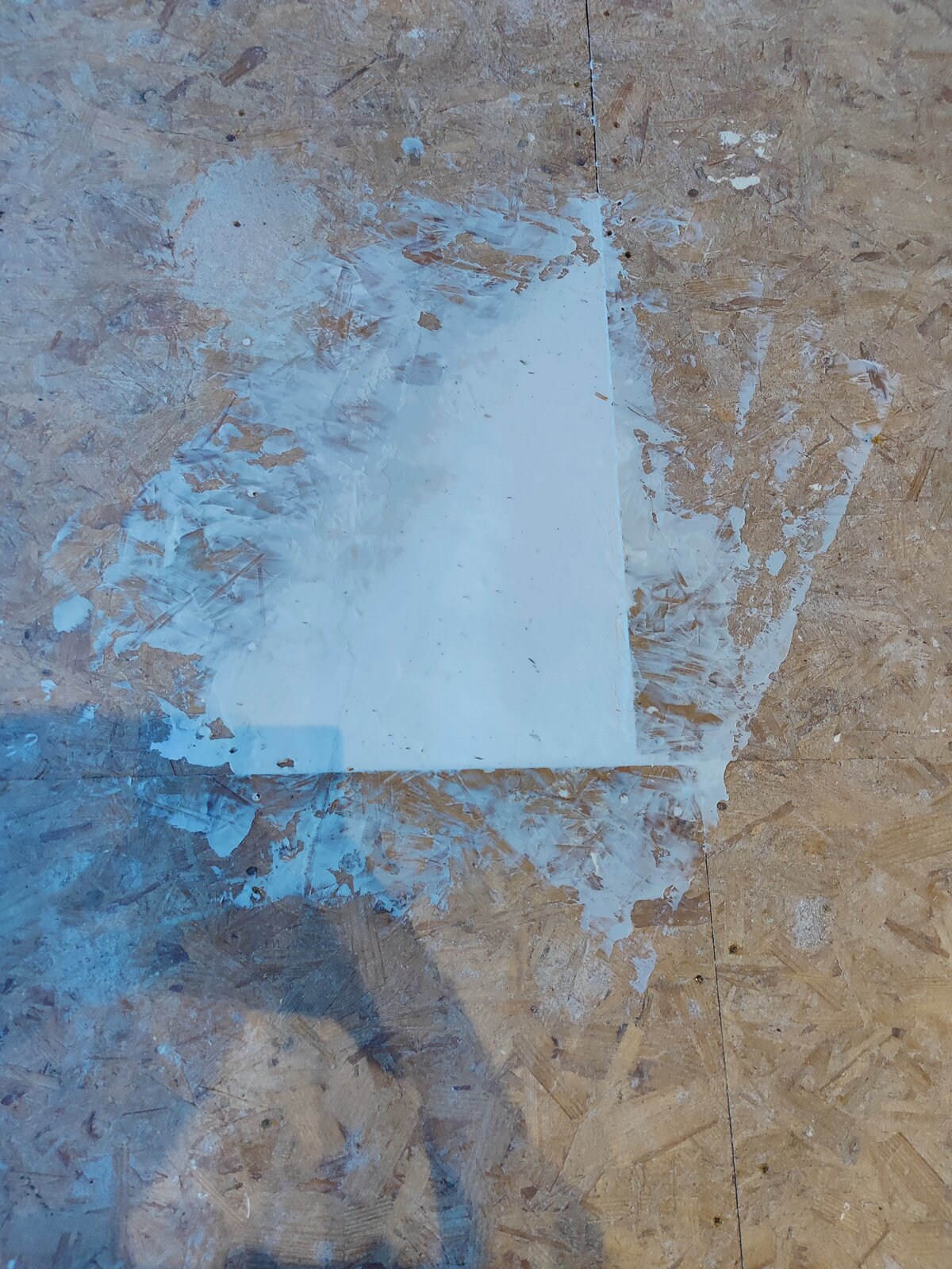

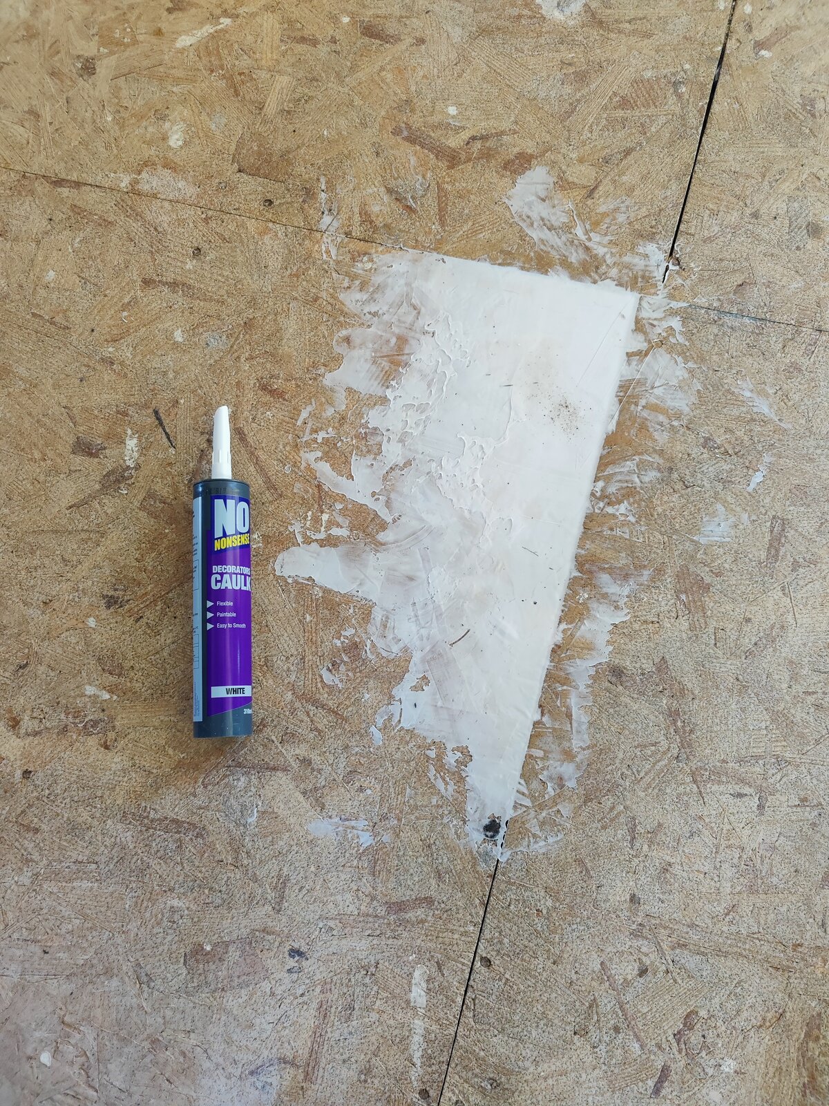

This is what I've opted for. It's general corners where there is a height gap. There's no (new / current) movement, I've added new screws to all squeaky parts.
I drowned it in chalk, dragged a straight edge over it and think this will be OK.
Fitters back in two weeks so plenty time to dry.
